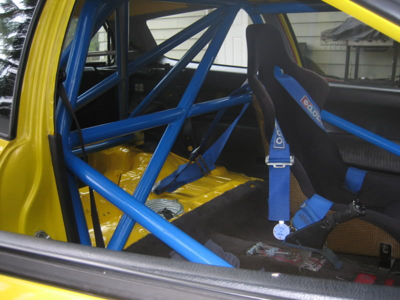

heres a pic of my A/M 6pt, I bought a couple extra sticks to do a solid rear strut bar, x in back, and diagonal bar through the harness bar, I'm into material about $300, but I'm local so I didn't have to pay shipping which would have sucked on all that material.
added some gussets
heres a link to the home made dimple die tool I made and used for the gussets
http://honda-tech.com/showthread.php?t=2553430
« Last Edit: December 04, 2009, 03:08:25 AM by N1 Andy »

looks a little ricey to me...proof it's fast enough to need a cage
Re: Jegster (Jegs) Roll Cage Kits?
« Reply #20 on: December 04, 2009, 11:43:26 AM »
Looks like a road race style cage, not a drag style cage.
why? because it has a few gussets? drag cars have gussets some times too.
Actually that IS what I was trying to accomplish with it anyways so thanks.  really the only difference between SCCA and NHRA is door bars and the 2 bars from the harness bar to the exhaust tunnel.  SCCA requires an X in the door bars, which I don't have so I don't see how it looks like a road race cage.
The X on the rear bars, the gussets, the diagonal bar on the main hoop, the lack of V bars, and lack of a spreader bar on the main hoop, the additional strut brace bar. ect...
Yes it is missing X bars on the doors, but it is still far closer to a road race spec unit then a drag spec unit. As far as NHRA / IHRA is concerned it is no more then a well braced roll bar. Good for 10.00 sec or slower, or less then 135mph.

cars can look like yours when they go fast .... but with that heavy ass junglegym in ur back seat that with that hidious color that prolly matches your bodykit ,N/A pecie of shit goes fast enough to worry about rollin then you can make fun of my powdercoated VC. Ne ways i got something much nicer that that dosn't look like it got fucked in the ass by bozo the clown
« Reply #26 on: December 04, 2009, 03:10:44 PM »
Go role that fucker over and tell me how those shit ass welds hold up O0

I would say its fashion over function, but its just gross nothing styleish there,
« Reply #28 on: December 04, 2009, 03:17:11 PM »
It always amazes me when i see some shit ass welding on a cage. Does no one value there life?
