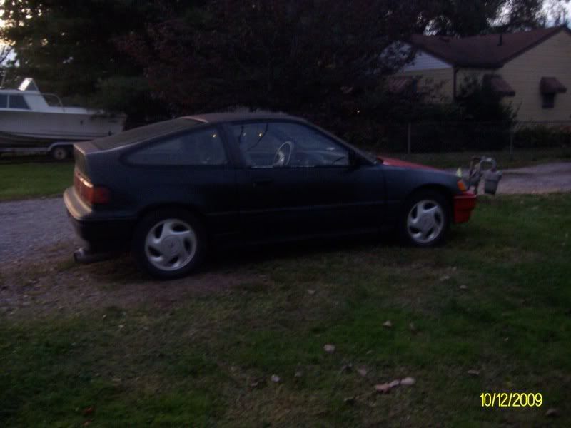

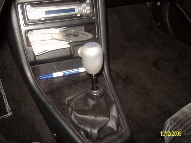

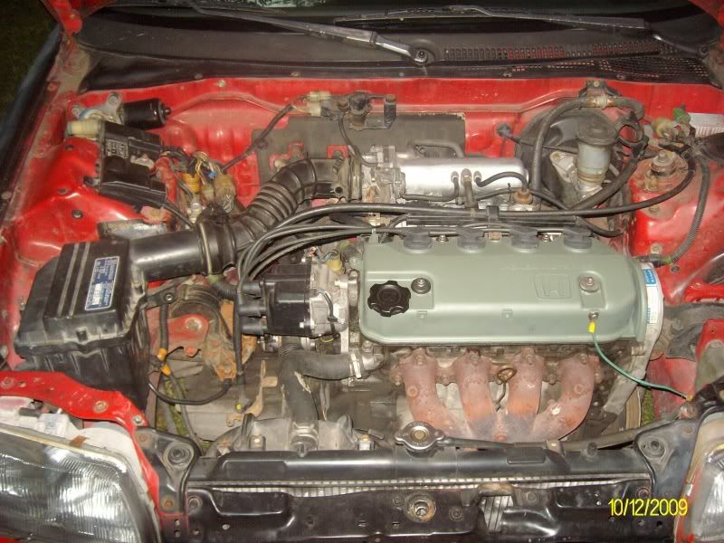

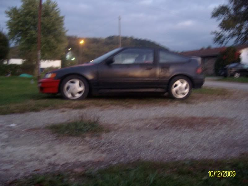

This was when i first got teh fucking turd , Was in ok shape, interior was rough, front bumper was ripped up in a few places and the hood has big dents in it from hitting a deer lol. So while at my buddies house i noticed, hey he has a perfectly good donor crx sitting at his home lol. So off came my hood, bumper, and my bumper support because mine was rusted all to fuck. Swapped those out. Then swapped out sunroof motors to get my sunroof working. Replaced the tenzo R springs and KYB struts for a set of Tokico Blues and Neuspeed Sports. Replaced my LCA's for ones with polyurethane bushings. Replaced the shitty oem shifter with a GSR dual bend with urethane bushings. Also relocated the battery to the rear. As it sits now.

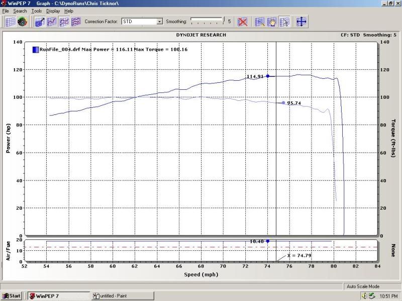

And my STOCK dyno sheet, for before and after purposes.

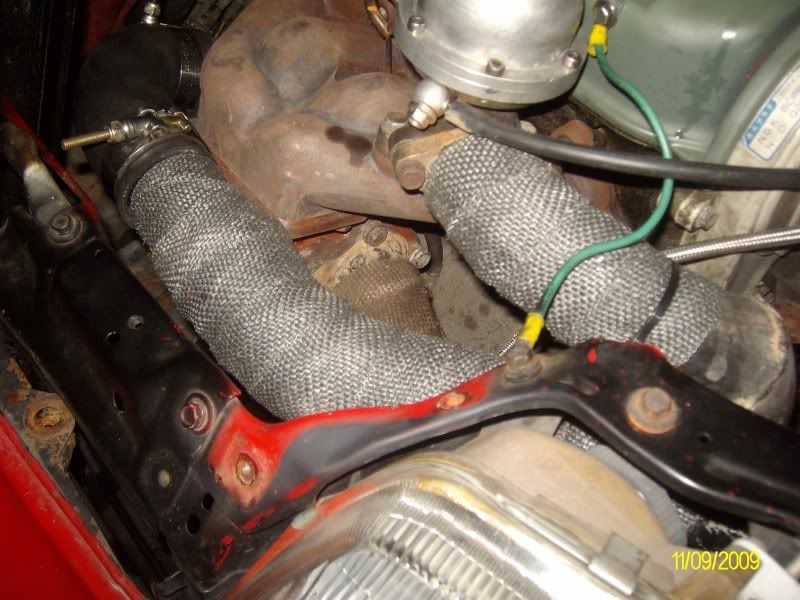

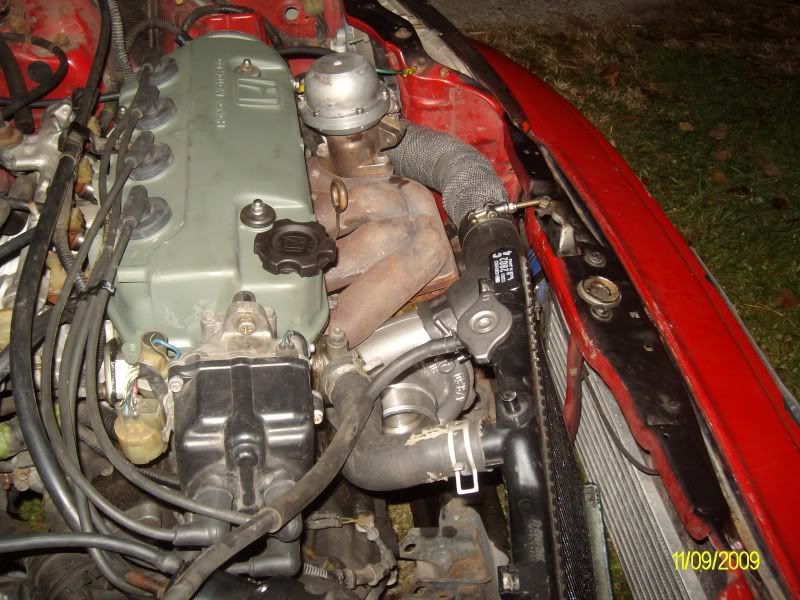

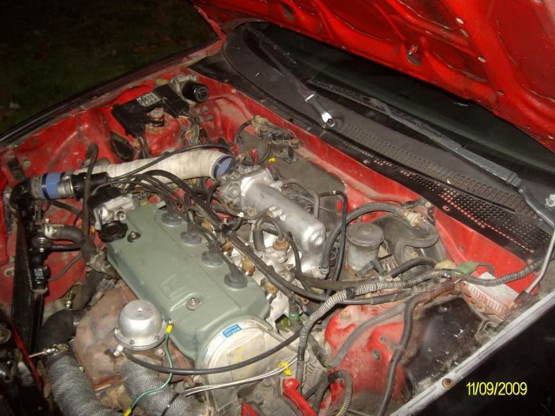

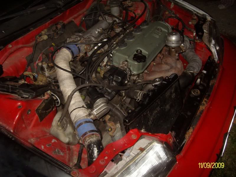

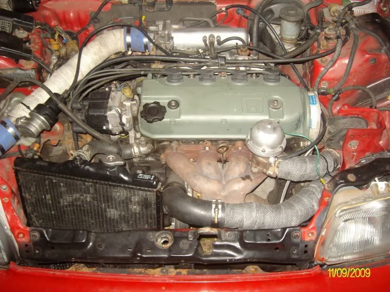

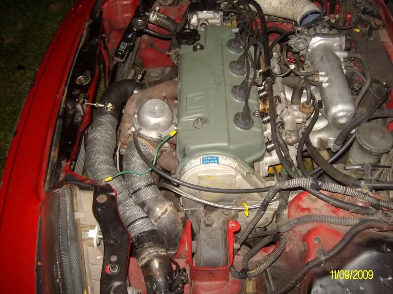

Well finally got off my ass and boosted it the other nite. It was a super long nite but i got it done and tuned. Final numbers before the ol stocker clutch let go were 170whp and 150ft lb's on 9lbs. Made all the piping/ic piping ect out of scrap found in the back of our shop with a gasless mig!!! True homemade setup. Still have the stock crossmember as well!!! Even tho you have to do the "gangta lean" as i call it with the radiator. Clutch let go which i figured so i'll be putting a clutch in it this week and going back to the dyno to bump it up to 200whp at least.  Set up is:
Ebay T3/T4 57trim with 2500 miles already on it, so no blowing up!
birdshit 2.5 IC Piping
birdshit 2.5 Downpipe
Apexi BOV
Tial Style 38mm bov with tial internals
birdshit Dump tube
DSM injectors
Chipped PR4 on turboedit
XS Power FMIC
Rev Hard cast manifold

It was my first downpipe with a EF with stock crossmember. But whoever says its hard to get by the crossmember is full of shit, Mocked it up on a junk engine on the engine stand and it fit fine. Surprisingly the radiator sits perfectly still like that too lol

did you put a fan on it?

And yea i put a slim fan on there after a few days. Although it only got hot sitting in traffic for more than 20 mins.
