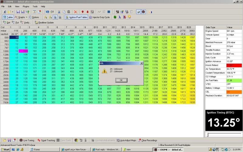

well i click on the CEL: ON button in the live tuning section of crome pro and its telling me
Also what the fuck is the knock retard actually doing? I've never noticed it red like that before?
All I did between last time I ran it and now is reground the wideaband to the thermostat housing. it was running find on another map since then, just now after making this new map the codes come up.
also the screenshot was taken after I shut the car off, thats why the afr is so lean.

No code 2 (except OBD0 PR3 PW0 IIRC), must be two long flashes = 20 ELD.  Has no function, disable.
Code 4 = TDC sensor.  ECU derives base timing from this, if the TDC wire polarities are switched it takes a couple seconds to crank and idle has a stumble because timing is off.  Alternately, bad TDC sensor.  Alternately, bad H1C1 board in the ECU.
Code 7, TPS.
Just guessing you're reading them  wrong.  Get vid if they really are crazy codes, curious.

I have not yer plugged in the jumper to read the flashes, I will do verify it tomorrow. But why would crome tell me those are the codes if they are in fact not?

disable knocksensor had the same problem code 24 unkown i disabled knock everything was fine.
