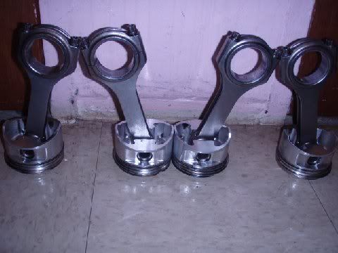

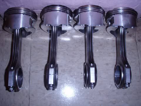

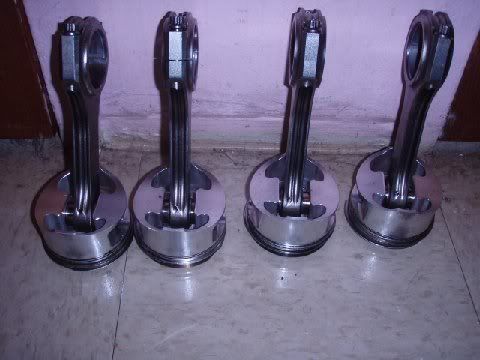

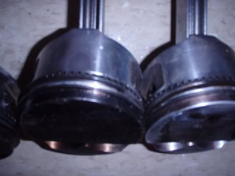

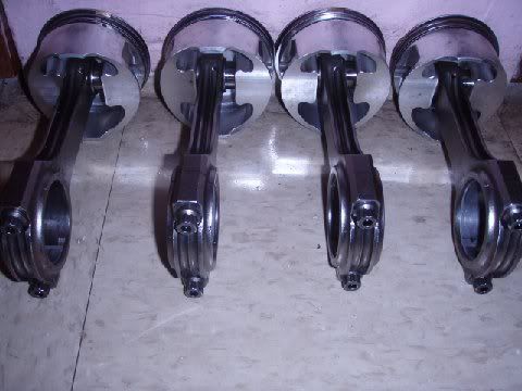

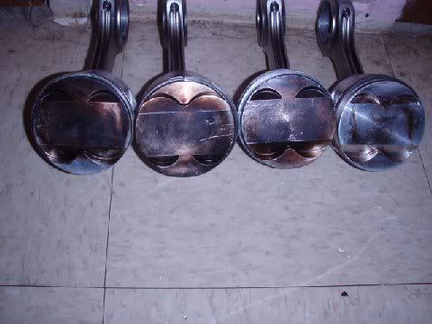

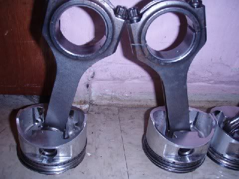

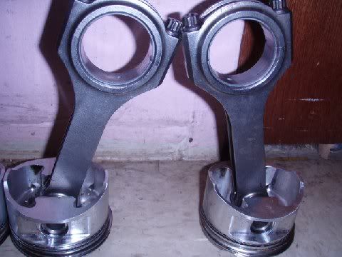

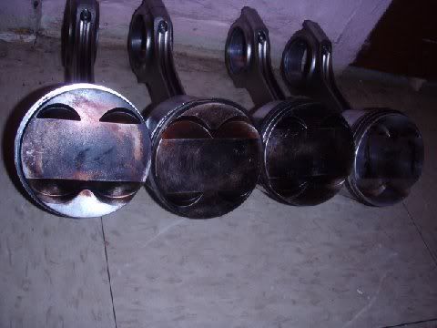

Found them on HT for a sweet deal, but nervous because I'm poor and can't afford to buy shitty shit.  First of all,
do they look like JE pistons and Eagle rods for a b18?  Is there anything noticeable of concern or that I should ask for better pictures of?  Are they going to crack in half when I turn my engine over?  Small reward at end of pictures

The pics are shite. Generally not a good idea to get used pistons, but the ring lands are what you need to really see, and preferably better piston top pics.

From pics, the skirts and what not look fine, but hard to tell from pics. I bought used SRPs and H beams for my ZC, and its still running fine. Although, I had Malichite go check em out in person for me (cus Im a lucky bastard), and he shipped em for me. Keep in mind, JE rings are like 100 bucks. I only spent 300 on my rod/piston combo, but had to spend 100 + shipping on rings as well.
But the amount of slop between ring and lands, as well as pin bore, are as if not more important than those aspects.

One of the pistons has fucked skirts

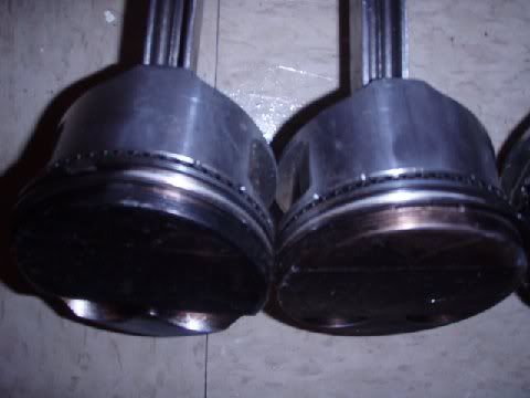

Have them learn how to use the macro mode, then take pictures of the skirts, ring packs, and very closeup of the top (pitting from detonation). Otherwise lowball the shit out of them.

looks like one of the cylinders was dead.
