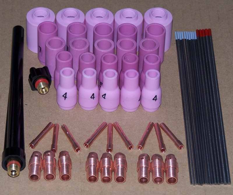

i got this kit and looks OK to me..

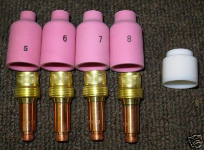

i assume this is gas lens..
didnt know it's needed this for weld with TIG
Re: My First Ramhorn
« Reply #28 on: March 19, 2009, 09:59:09 PM »
Better gas coverage.
