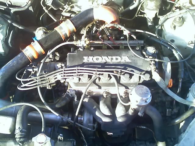

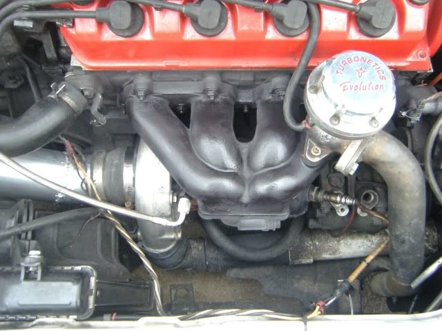

This is my thread on my civic and cheap ass turbo build
I have had this civic since i was 16 I am 22 now, started off an auto and slow. I blew the transmission the fuck up. So I swapped a 5 speed in.  I rear mounted a turbo on this and that was full of fail. So after a couple other turbo set ups I have ended up with this. I havent paid full price for any of this shit but the wideband.

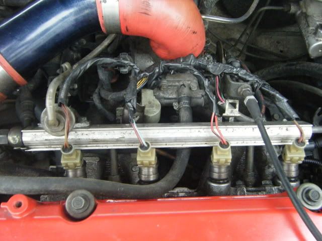

My civic is being boosted up to 7psi I am using a vafc to control my dsm 450s I have an aem wideband to moniter my a/f ratios
Used Ching Chong T3/t4 (From a hmt user)   60$
Used Greddy Type-S local                            70$

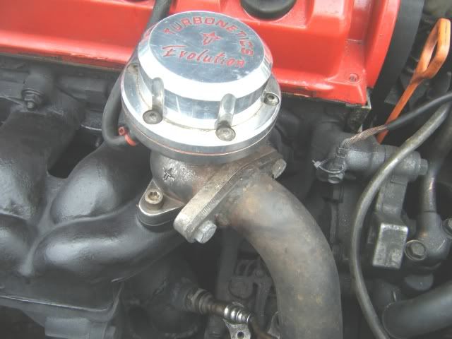

Used Turbonetics 38mm Wastegate             40$
Used Precision intercooler                            30$
Dsm 450cc                                                50$

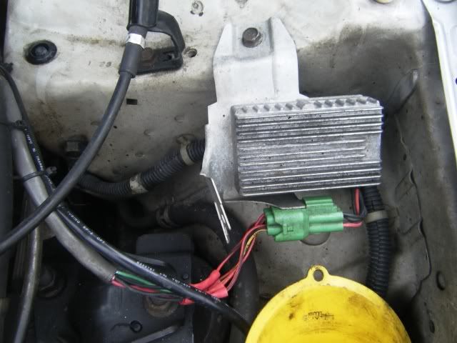

Resistor Box (From hmt user)        Traded so 10$ shipping
Oil line from swap meet                               10$
Manual Cutout                                            20$
Used vafc                                                   80$
Ebay Pipe kit and t-bolts                               80$
Cdm Cast mani                                            80$
Manifold Turbo and Wastegate

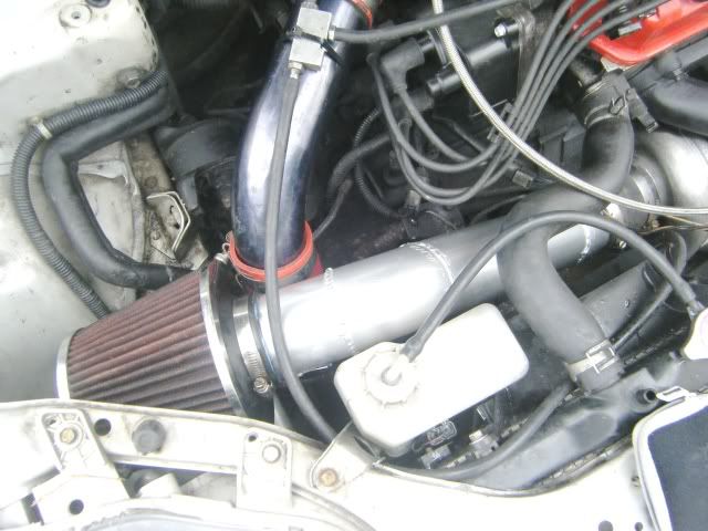

Home made intake pipe

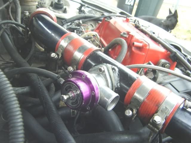

My pride and joy 40$ wastegate
Real Greddy at cdm prices
Dsm 450 install
Resitor box install

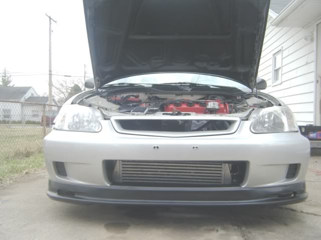

Front mount oh so sexy

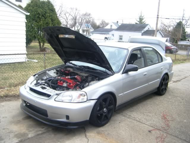

Car shot

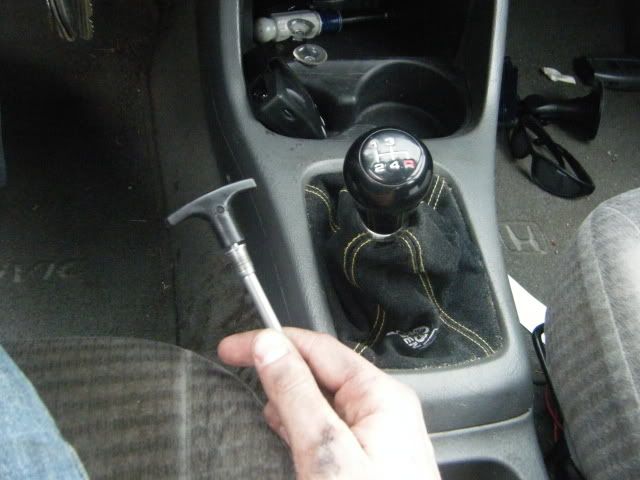

How I control my Exhaust cutout
Cutout built into the downpipe
RHMT > HMT

Man, i am really liking the way those CDM cast manifolds fit.

only thing i don't like is the compressor on the passenger side.
but since you cant do much about it
very nice

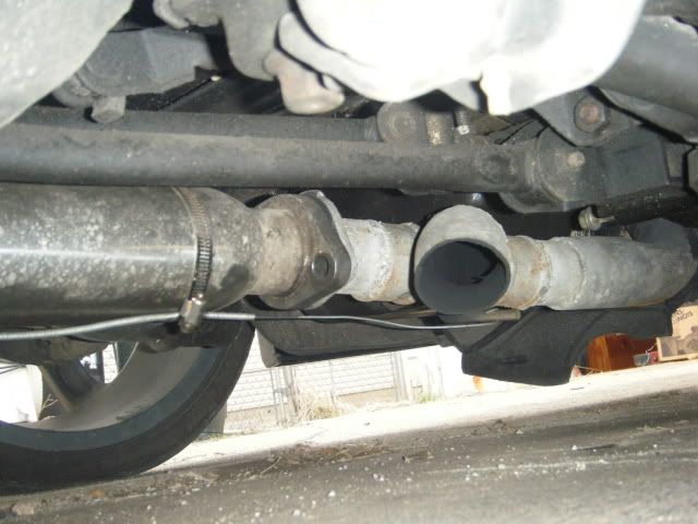

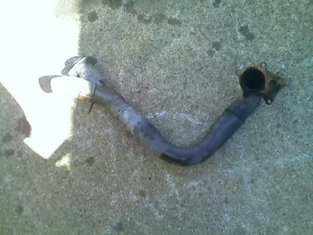

Nice clean set up. Love the afro-american engineered exhaust cut out.  :yes: You have any more pics of how you did it? Id like to do something like that. keep up the good work. ;)
clwtwizted
  • Posts: 145
  • Fuck You!!!
Re: Clwtwizteds 4Door Civic
« Reply #12 on: March 18, 2009, 08:32:53 PM »

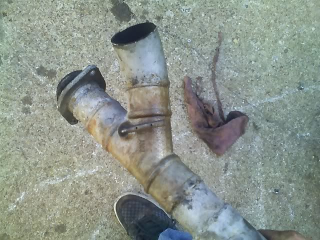

for the exhaust cut out i just used one of thesehttp://www.jegs.com/i/Mr.+Gasket/720/5424/10002/-1 I ran  the cable threw the hole that the auto shifter cable was ran through and just have it coming out from under the center console. I just used hose clamps on the exhaust to keep it tight. Then I welded a down turn on it to try and keep the gas down and not in the engine bay. The only down fall to this is it has a slight rattle due to the fact that it was made by chinks, Its deffinatly fun to pull up to some one nice and quiet then open that bitch up and smoke there ass

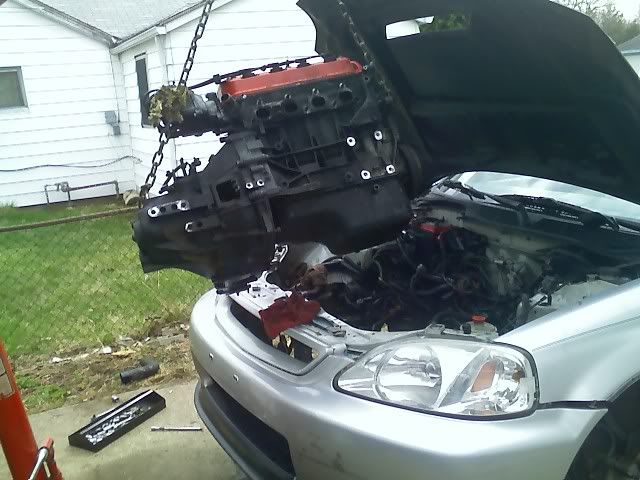

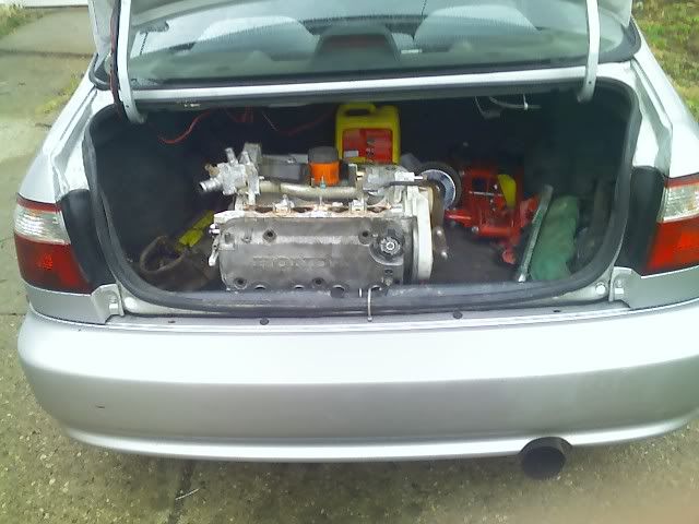

« Reply #14 on: April 06, 2009, 11:03:47 PM »

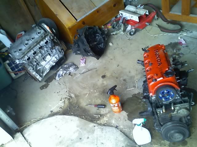

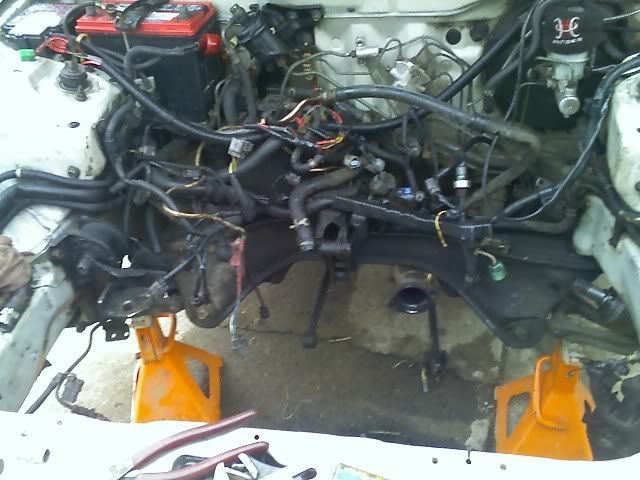

So I blew a ring on cyl #2 but i gotta sweet deel on a d16y7 with 62k miles on it.
New Motor
Thanks to the motor my rears tires tuck
Old motor coming out
Empty Bay
Both motors and tranny
New motor installed
Close up of the cut out with the down turn
Down pipe with the cut out

Question - why did you pull your ac lines, but not the compressor? The crushbend probably says it all, but I never like see super tight exhaust turns unless aboslutely needed.
Besides that, looks great for the price.
