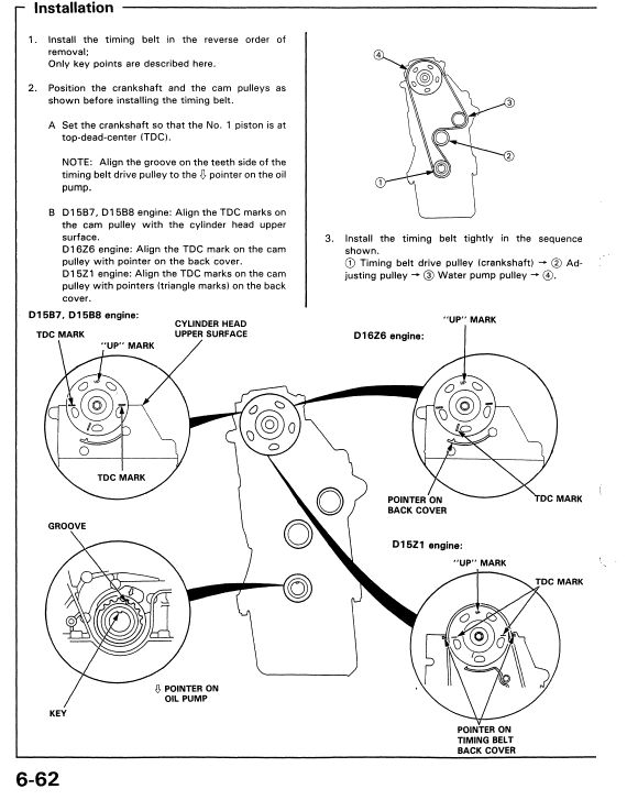

d series cam timing how to
« on: March 17, 2009, 12:07:24 AM »
how do you set the cam timing on d series? this is a d15.
it has two marks on the cam gear

« Reply #2 on: March 17, 2009, 03:45:53 AM »
  • Posts: 19707
Re: d series cam timing how to
« Reply #3 on: March 17, 2009, 04:14:12 AM »
lol i guesssed right
