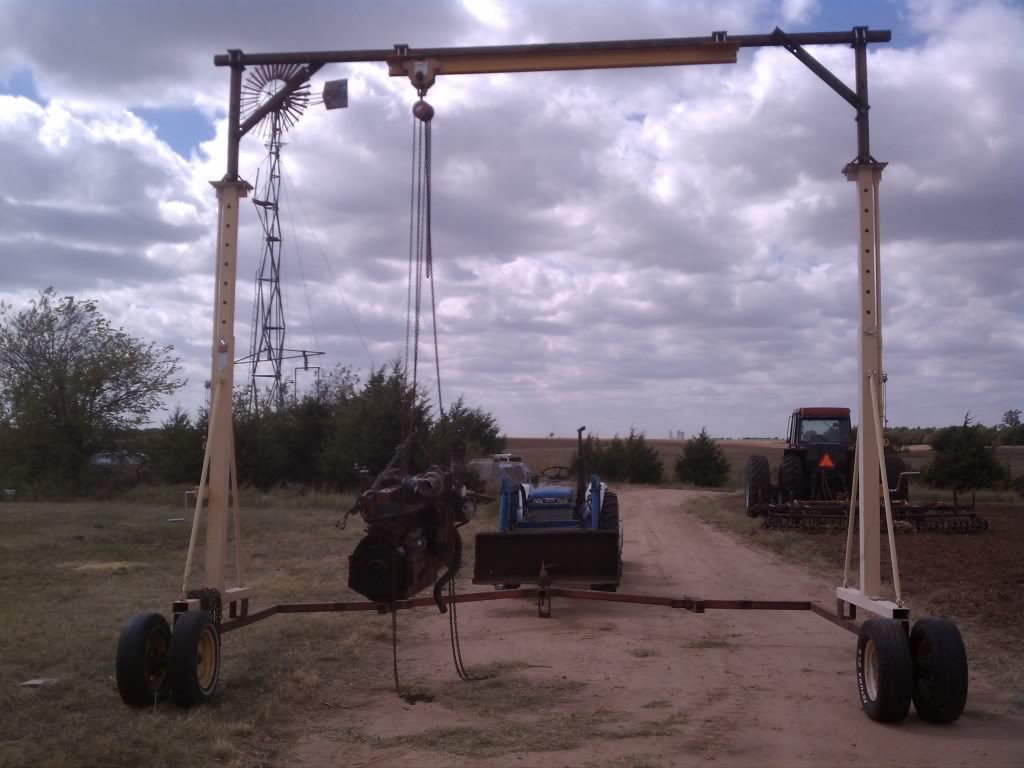

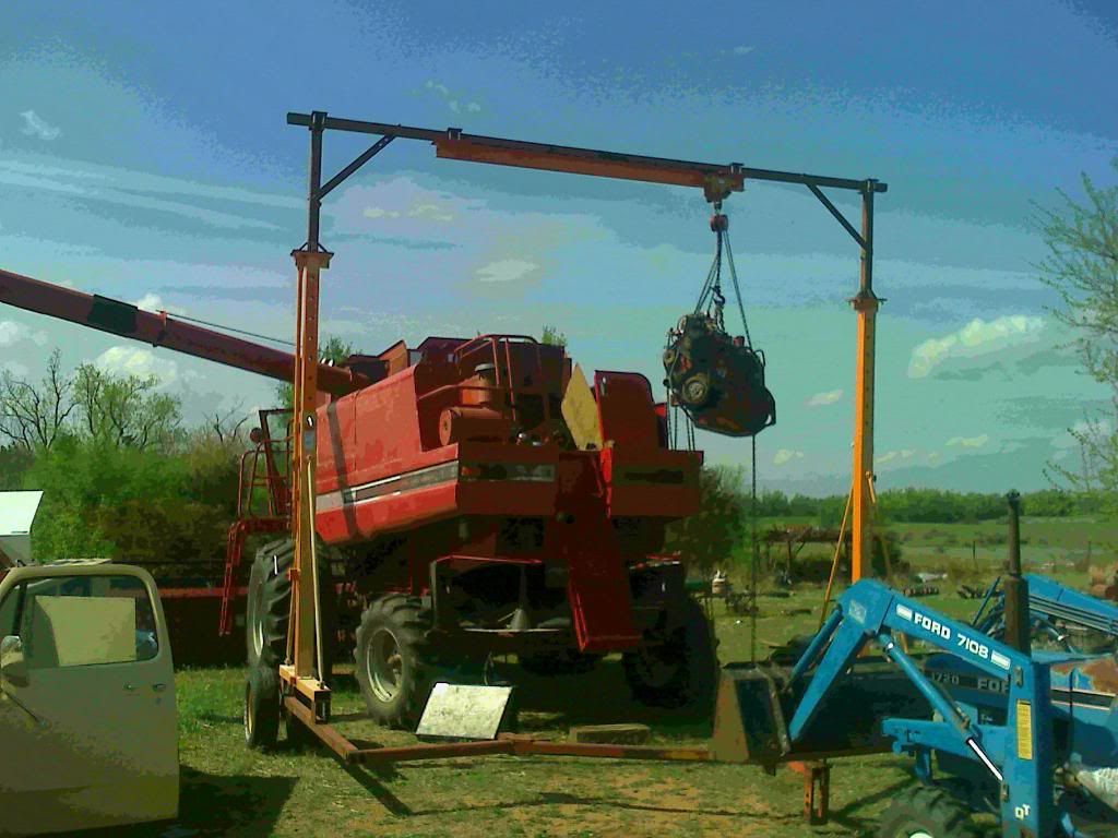

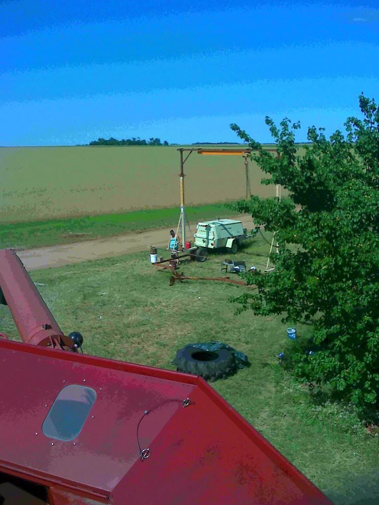

Here is our heavily modified harbor freight gantry crane.  Put on wheels, setup to connect to the front loader on our small tractor to allow it to be moved around with the load on it.
Widened and made taller to work for pulling the engine out of our combines.
And in action with the ~1400-1500lb engine.  :yes:
The pictures are all shitty because its a water damaged motorola phone lol.
« Last Edit: September 09, 2010, 10:32:26 AM by Aero »

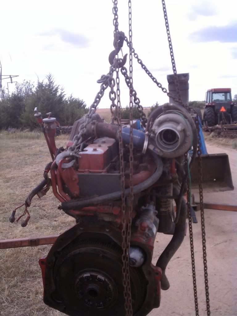

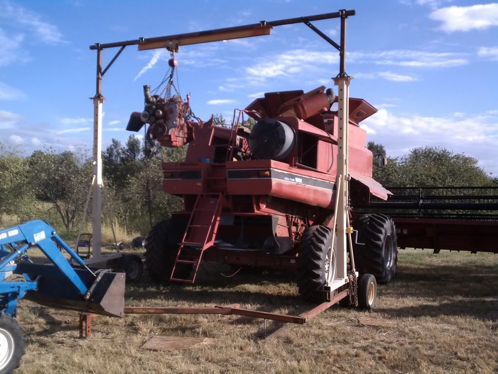

Engine #2 with the RHMT engine hoist.
  8.3 Cummins with the HE431VeTI VGT turbo that we put on.  Had to pull the motor to fix a leaking rear main seal.
