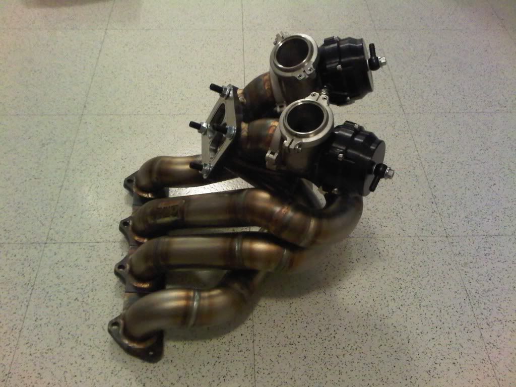

i was bored, so i tried to mount the gates on the manifold for shits n giggles. Well the left gate is havin fitment issues. i think the Precision clamp is just too beefy.
The "handcuff"
My options at this point is
*use the smaller Tial 44mm clamp and hope it fits (i don't see why not since i have seen tons of Tial gats on this manifold)
*shave down the "handcuff" Precision clamp.
*And LAST RESORT, cut and extend to clean the runner.
« Last Edit: January 29, 2010, 02:14:32 PM by Pootie »

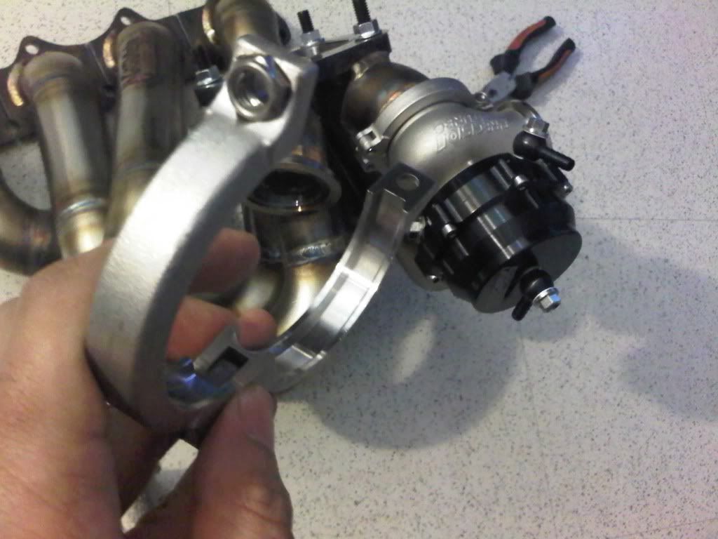

I think you fail at putting the gate on in its intended orientation... The 46 will fit ANYWHERE a Tial will. Ive held one, seen one, played with one....  Not sure what you have going on there son.
Pootie
  • Posts: 259
 there is no doubt that it seats correctly.. My issue is the clamp thickness/runner clearance.
I even tried to seat the manifold flange with the clamp first thenn try to slide the gate in. and no bueno.
 I'm sure i can beast and jam the thing in there and get it to clamp. But thats BS to have to deal with that when installing this damn gate in a tight enginebay.
« Last Edit: January 29, 2010, 02:21:59 PM by Pootie »
Tuned by you know who! ;-)
you cant put the clamp over the flange on the manifold first, then slide the WG in there?
yes.
Pootie
  • Posts: 259
i think the firering was gettin in the way.
« Last Edit: January 29, 2010, 05:18:45 PM by Pootie »

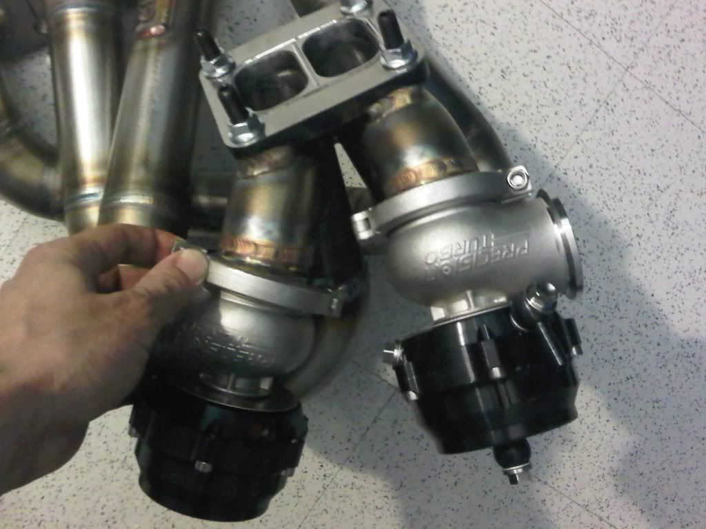

gates are on!! ;D
 I took the clamp to work. Hotel Enginering Dept FTW!! (shaved with edges on the clamp round) :yes:

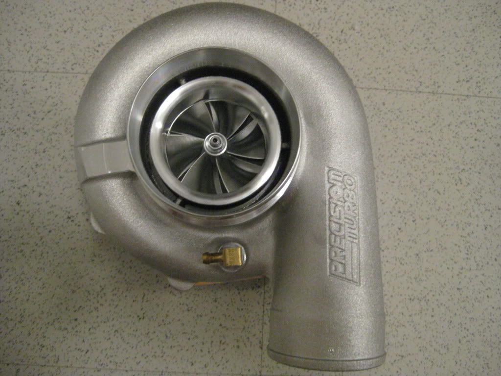

I sold some spare parts and came up with some $ to order my turbo.
I went with the T4 Billet 6765.
