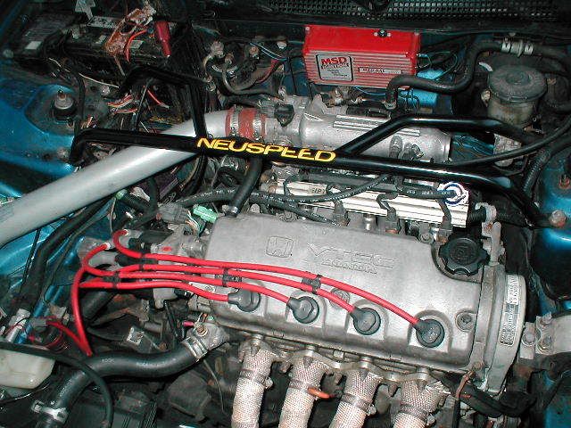

this is correct... right?  ???
dist | 4 3 2 1 | timing belt
1342 clockwise
#1 cylinder is rear of dist in the middle?
Re: d series firing order and cylinder order
« Reply #1 on: March 20, 2009, 12:53:19 AM »
the coil tower separates #3 and #2 in the 1-3-4-2 CW firing order.
