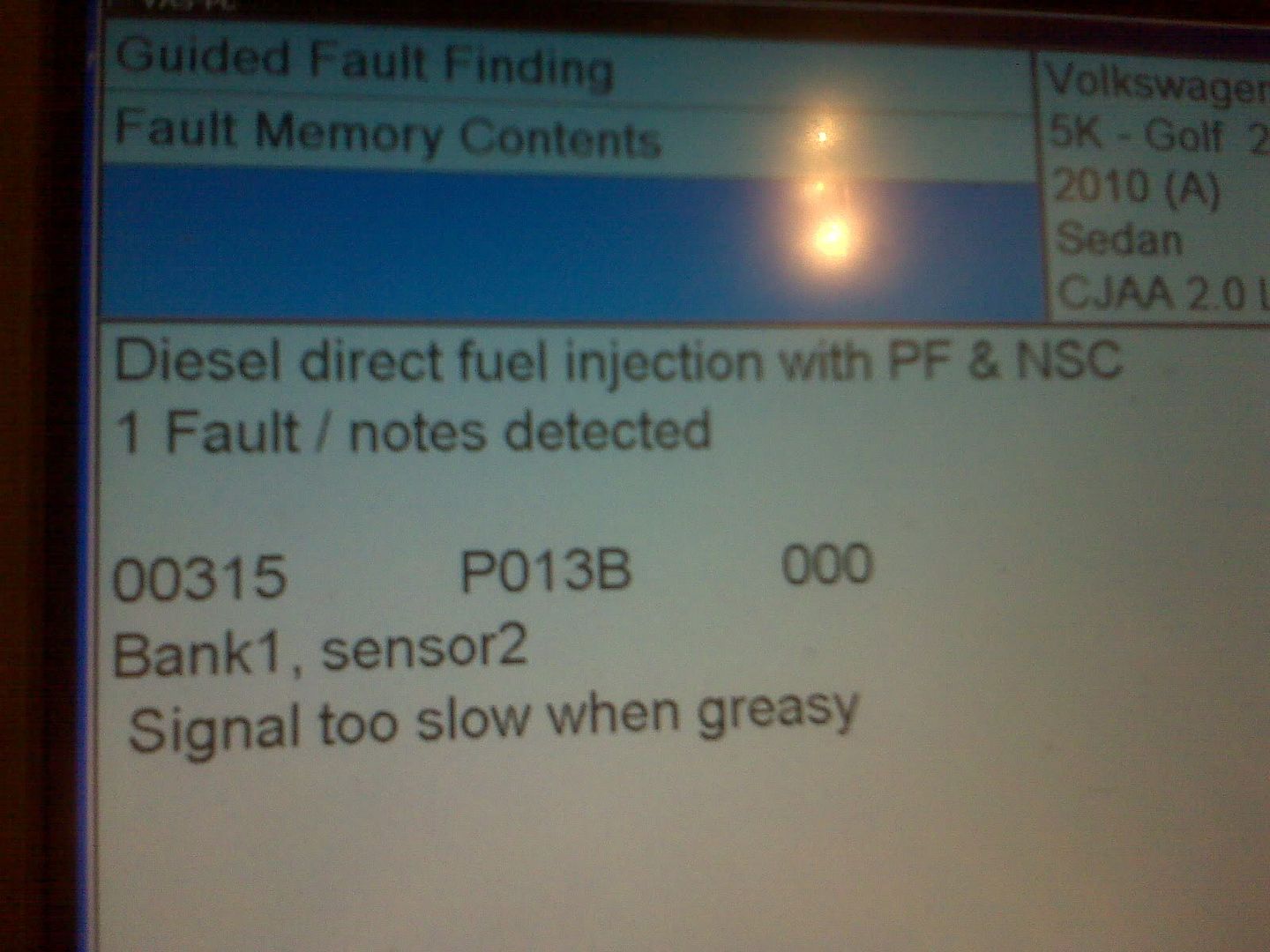

« Reply #9 on: December 10, 2009, 10:51:24 AM »
"signal too slow when greasy"
Only a vw.  :P
