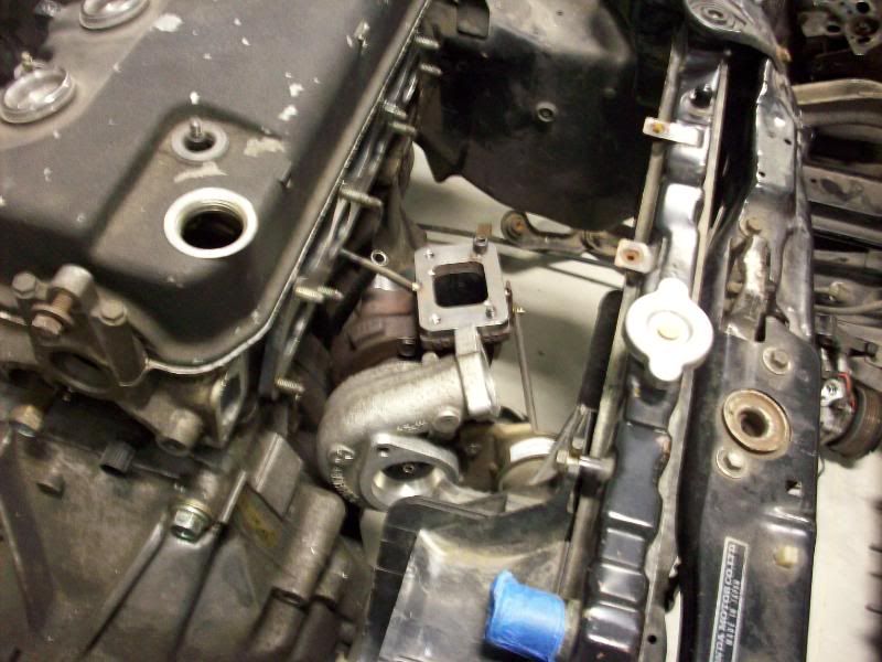

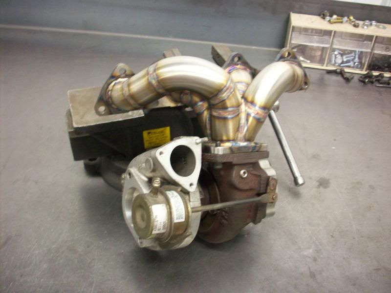

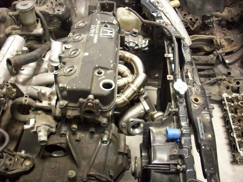

Here is my "quick spool" turbo manifold i just got done building using 1.25" sch 10 and a 2" collector. We will see how it works out.

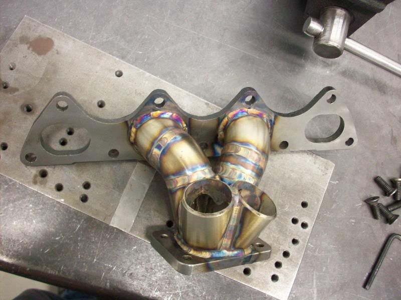

not a criticism, it looks baller, but why do the welds look really wide?
it looks like your doing strait travel but it just seems very wide.
Re: 1.25" sch 10 d series manifold
« Reply #5 on: December 11, 2009, 01:45:39 PM »
I thought someone might ask that. I do a tech. i was told is lay wire were you never pull the wire from the puddle while laying a bead. I then work the torch to get the desired height and width of the puddle. What happened on some is i had a mix of sch 40 straight and sch 10 bends. (they only had sch 40 straight at my local supplier).
So to get and even profile on the welds i increased the bevel width soem to help with looks. With out this i could have one or two welds that woudl be quite larger then the others and would ruin everything in my eyes.
They also look a bit wider as this is 1.25" sch pipe vs the standard 1.5" pipe. it is quite a bit smaller.
what is the problem with wide welds? :noel:
