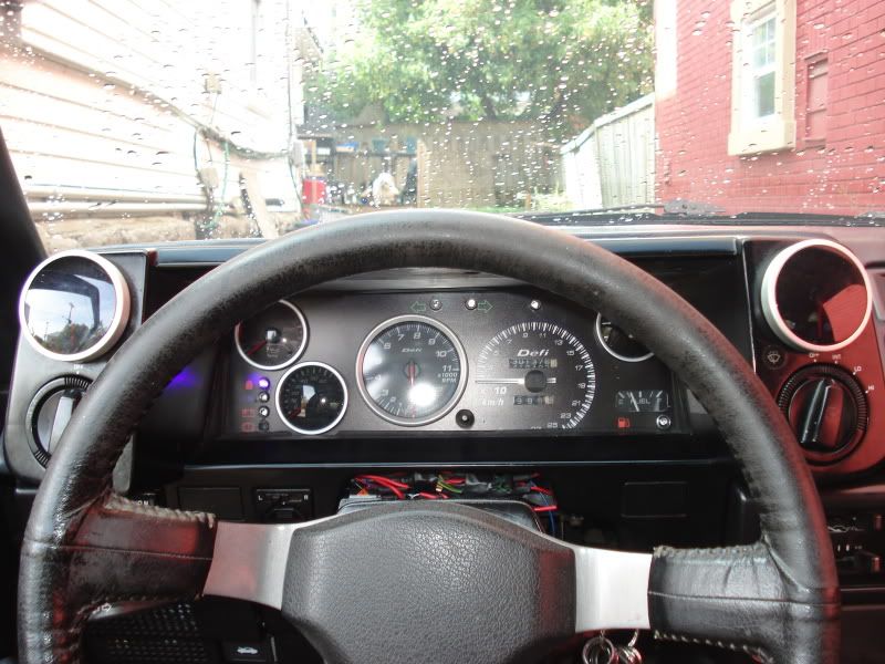

There is a VSS on the back of my speedo. But ive done this and im not sure its reversable, I'm going to check the back of the cluster, well wahts left of it to see if I can salvage some of the circuitry.
 So as you can see the only thing left is my speedo, and the circuitry is pretty much gone in the rear.  But their is a VSS sensor of some sort on the back of the speedo that the ecu used to receive.
Is the honda VSS just a single wire or is it a signal wire and ground.
« Last Edit: January 04, 2010, 12:01:12 PM by TTC »

You could mount a hall sensor on driveshaft or wheel or the like.
You sure there's no VSS input to the ECU on your car?  Might be like Honda of that era, located at the end of your speedo cable on the back of the cluster.
It is exactly like a honda.  Should be a purple or purple/white wire coming from the back of the cluster to the ecu, pin A10 (almost always on toys).

Defi make a quartz analogue clock?  like the hyundai pony has instead of a tach?  that would win.
