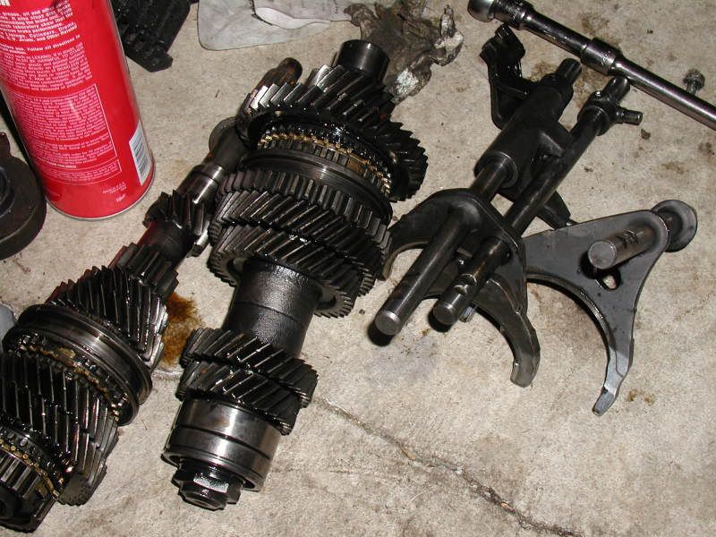

Picked up a 96-00 EX P4A B000 tranny with the STEEL shift forks seeing how all the aluminum ones from the P20 92-95 ones I have are broke as shit.

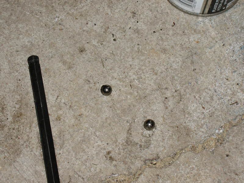

Was going to throw in the OBX LSD I've got and these two balls fell out
every bearing on the main and counter shaft is just fine.  WTF are these in the case?  The VSS was missing when I got it, could they be from something else and just got dropped in there?

Those are the detent balls. There are notches on the shift forks that those sit into. There are two bolts (12mm i think) on the case that you pull out and they have springs in them. Reassemble the case then put those balls in then the bolts.

Counter shaft lower syncro appears to have been hot at one time or another
Re: P4A B000 WTF just fell out?!?
« Reply #4 on: March 22, 2009, 10:17:32 PM »
countershaft bearing in the clutch housing had walked out a bit or i moved it trying to get it apart

CSB is now staked, and for the record, there is 3 steel balls and a 12mm does remove the plug and spring associated with each ball.  they go in after you assemble the transmission and casings.
