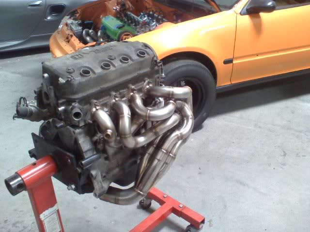

 found this thread to be quite funny, i though bisi made the best parts ever. huh?
http://www.honda-tech.com/showthread.php?t=2700221
thats twice it has cracked and he says a section of the header is about to fall out/off.
here is the image flipped 180 to make it easier to identify
Here is a picture i found of the bisimoto d series header..... lol
discuss.....
ps: i don't have the balls to post this all over that thread so can someone do the honers...

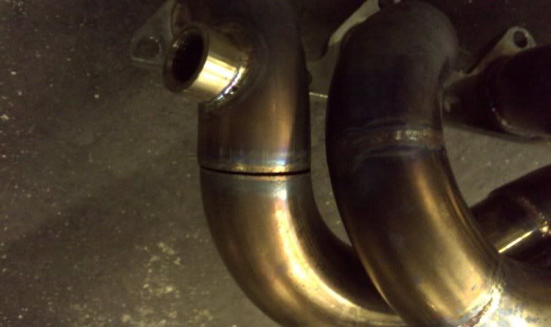

as much as id love to bash bisi, i dont like bashing people for fab work failing like that because it can happen to anyone. ive had things that should not have cracked crack, and cannot figure out why it did so.
im wondering if he back purges those headers though, i would never build a 16ga manifold and not backpurge it, theres just too many welds to crack on such thin metal.

Tubular headers/manifold on a dynamically unbalanced inline four cyl will crack, period.  It's just a matter of time.  What I find interesting is that the bead cracked down the center, can any of you fab guys offer a fair analysis?
FYI, customer service is not paramount at Bisimoto.  Call David Peters at Over The Top in Knoxville/Marysville, TN, and ask him about the header that ran directly into the oil pan when fitted, and how Bisi spoke to him "like a dog" when he called about it.
Re: bisimoto headers are the shit.... :?:
« Reply #8 on: December 23, 2009, 12:36:41 PM »
...What I find interesting is that the bead cracked down the center, can any of you fab guys offer a fair analysis?
Looks like a lack of filler as all of the welds look concave. Judging by the poor consistency of the welds around it, I would guess that it is not back purged nor was there proper prep when starting out.
Looks like Brine04's OG CC-Fab ramhorn if they wouldn't have used any filler.
« Reply #9 on: December 23, 2009, 12:53:42 PM »
Yeah lack of filler/proper welding technique killed that header.
the guy just posted that the first header he receaved wasn't welded fully on some joints and it leaked everywhere. LOL :-X
« Reply #10 on: December 23, 2009, 01:42:43 PM »
Simply false. Just because 98% of all fabricators in the automotive sector don't actually have any idea how to make proper welds shoudln't condemn a style of manifold to imminent failure. I haven't had a single manifold, downpipe, exhaust etc fail ever, and I've literally made thousands.
I doubt that weld was properly purged. The bead is terribly inconsistent, along with the other welds you can see in the picture.
I agree in the fact that there are a lot of poor welders in the automotive field. simply no money in it 99% of the time so they go where the money is.
But JD has a point in the fact that the 4 cyl doesn't help anything, just look at supra ebay manifolds they stay together quite well compared to the ebay garbage the honda crowd has experienced.
Plus tubing isn't something that can hold up when welded using improper welding technique, etc...
There is a reason i don't touch n/a headers and thin wall manifolds. lack of skill to make it work with any reasonable amount of reliability.

if i had to guess on that header when that runner was built there was some shrinkage when welded and that stress pulling on the runner found the weakest weld, and probably at at hottest point (closest to port) and it failed. im sure its a mixture of poor welding and no backpurge. ill give the guy credit it looks to be assembled well and id hate to have to build one of those over complicated POS.
Agreed, most fabricators underestimate the importance of fit up on tube assemblies. If it doesn't fit like this:
than you don't weld it.
« Reply #16 on: December 23, 2009, 02:38:08 PM »
yep. i will usually tear stuff back apart if i assemble it and realize thereis a gap. especially tubing because filling gaps on such thin matl is hard as hell and looks like shit.
