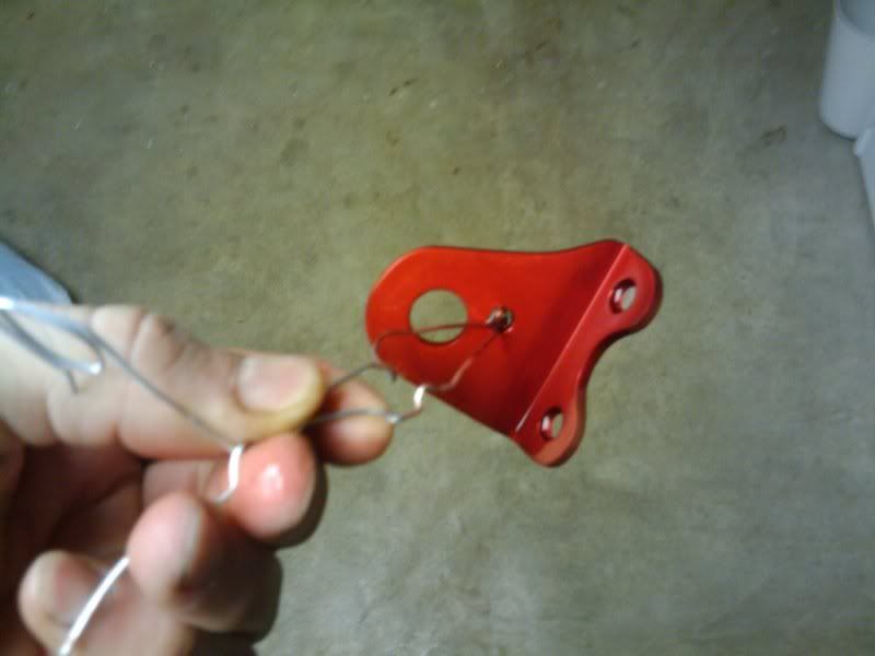

i got turned onto the lye trick with Al when i started anodizing some of my brackets/custom parts. these are the porsche caliper brackets and 3SGE manifold throttle cable bracket i did a couple weeks ago:
this is the throttle bracket fresh out of the dye bath:
it's really not that hard, just need some sulfuric acid and a battery charger.
