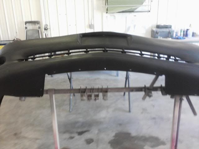

Anyways on to what I am talking about today which is prep for panels you buy off e bay out of magazines etc.
Start by unwrapping carefully save the bags incase a craigslist date goes bad in a hurry  :noel:

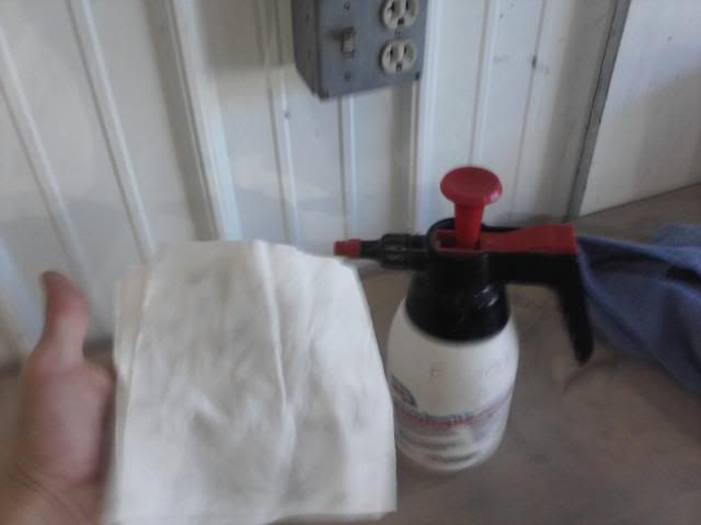

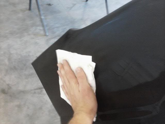

You want to wipe down with solvent for two reasons the plastic pieces still have the mold release agent that will cause fish eyes as well gum up scuff pads. You also want to wipe down  because who knows what kinds of asian finger oils touched it.
Proceed to wipe down with solvent till your cloth is no longer black the hood will have e-coat so one wipe down should be good but the plastic pieces might need a few wipe downs.

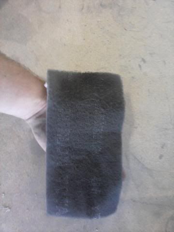

Ok so in the relm of scuff pads I like Mirka scuff pads they are thinner and cut a bunch nicer than the cheaper ones and there are 2 colors red and grey. red is supposed to cut much the same as 320 paper and grey cuts like 400 grit. I use grey for scuffing panels that are getting base/clear and red for single stage.

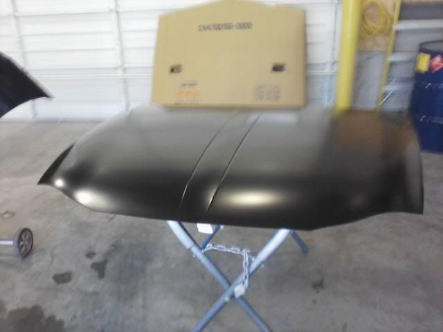

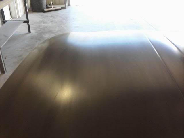

proceed to scuff away on bumper covers you can scuff in any direction as long as its dull on hoods scuff down the hood not across this is so that when you paint the hood and you are driving you dont see any possible scuffing marks.

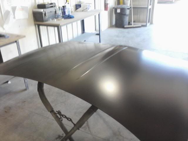

kinda hard to see but half of the hood is scuffed. here is a pic of the whole hood scuffed
it also shows the direction of the scuffing.

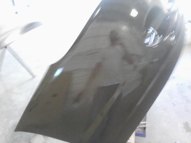

give it another wipe down again till your wipes are clean and its ready for the booth.

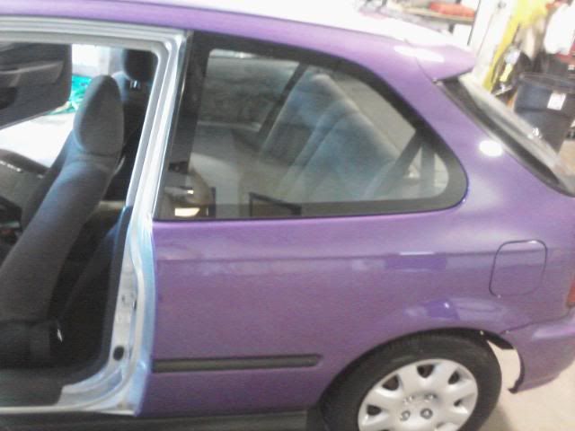

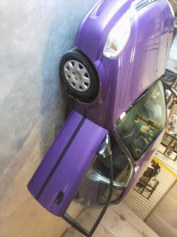

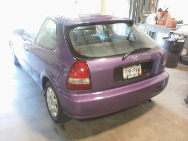

oh and someone is getting laid tonight.
Dont ask about the color i was amazed i could finish painting it i was laughing so hard but she picked it out.

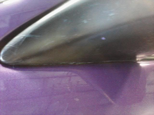

and to everyone who knocked my masking skills
hmm i dont see any purple paint
anyways its not a huge update but never the less.

« Reply #36 on: August 17, 2010, 04:30:27 AM »
For prepping a car like a  O0 that paint didn't turn out bad. Has very little depth though, but maybe it's not finished in the pic or the pictures are fucking it up.
DasPoop
  • Posts: 1761
Re: DasShit Guide to bodywork Pt4 Scuffing Replacement Panels
« Reply #37 on: August 17, 2010, 07:56:54 AM »
it has decent depth but its also a single stage so its not going to look a mile deep.
« Reply #41 on: August 19, 2010, 10:12:09 PM »
Well then now that i know it's single stage it' looks pretty good.
Hotrodlincoln
  • Posts: 1767
« Reply #42 on: August 19, 2010, 11:59:05 PM »
Single stage has nothing to do with how shitty a paint job looks. I can make single stage look a mile deep, and smooth as glass.
