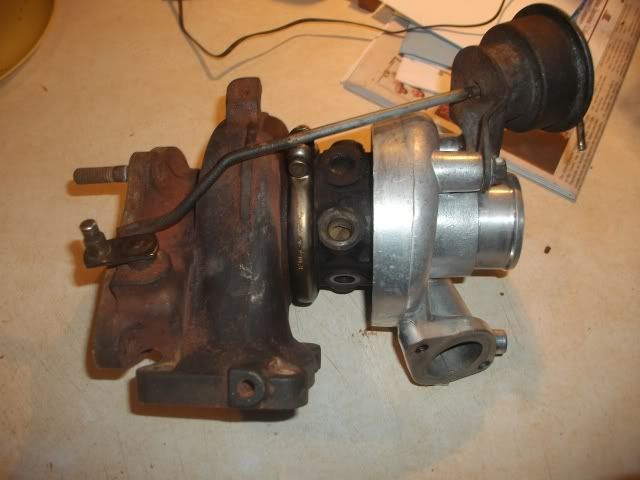

i picked this up form some local kid who was in need of money pretty bad.

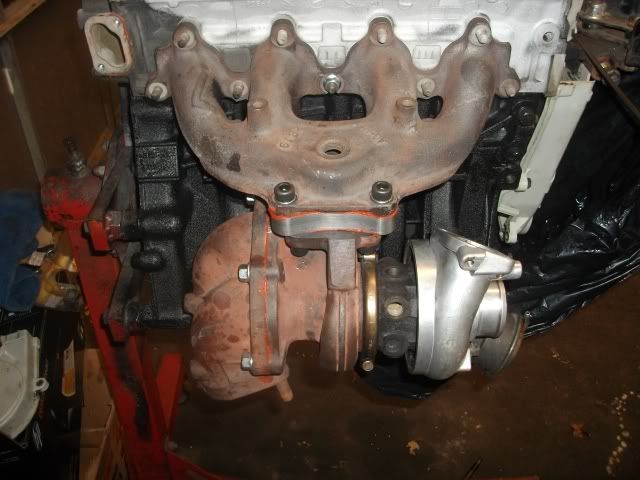

ebay evo3
HF manifold
adapter plate
stock O2 housing
and this is what i got
not it fits the block  just nice  and i have a parts wagon i  was test fittin on tonight  and it  clears a full size rad and  the stock o2 housing  dont hit the  cross member but it seems i will need a little trim to  get the rest of the down pipe on it  but the wastegate hit the cross member pretty bad so i will have to  play with that. i am tryin to keep it  stock gate.

Holy fuck!  Call me a retard, but I didn't realize the stock DSM O2 housing would fit
Hmmm.  I think the DDis going to have a 14b on it then.

I had to cut the 02 housing on a angle and nig weld a 90 on it to clear the ef x-member even with trimming it, you can see it in the tprc pics.
Neither of my 4th gens have the stock x-member, and my DD is a 6th gen.
Good tidbit of info none the less.

I did something similar with my crx, the stock 02 housing cuts/welds pretty easy for cast. Angle isnt bad either if done properly.
