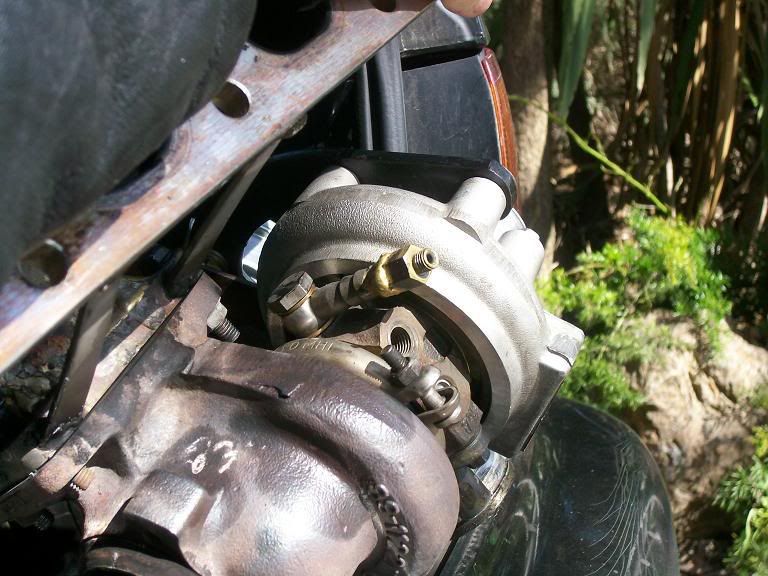

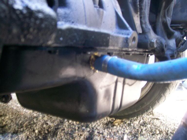

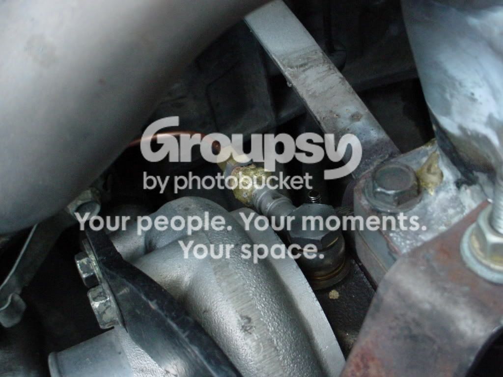

Wow.That is the oil feed of the year award right there :D Nice work boys :noel:
E-b0la
  • Posts: 2276
Re: A REAL HMT: $149
« Reply #31 on: March 30, 2009, 09:19:46 AM »
Compression fitting brazed to a barb fitting. Now THAT is hardcore. That has to be frontpaged.

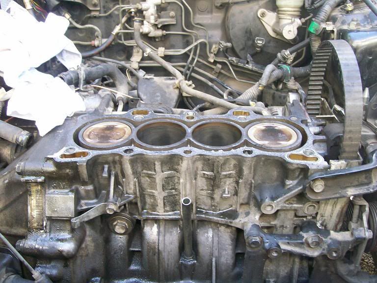

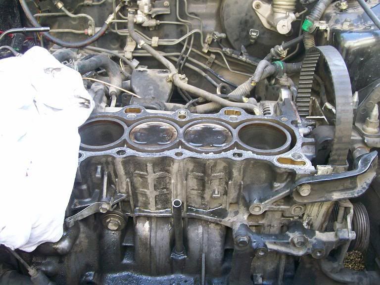

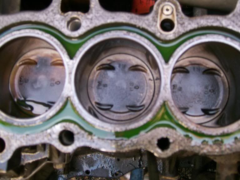

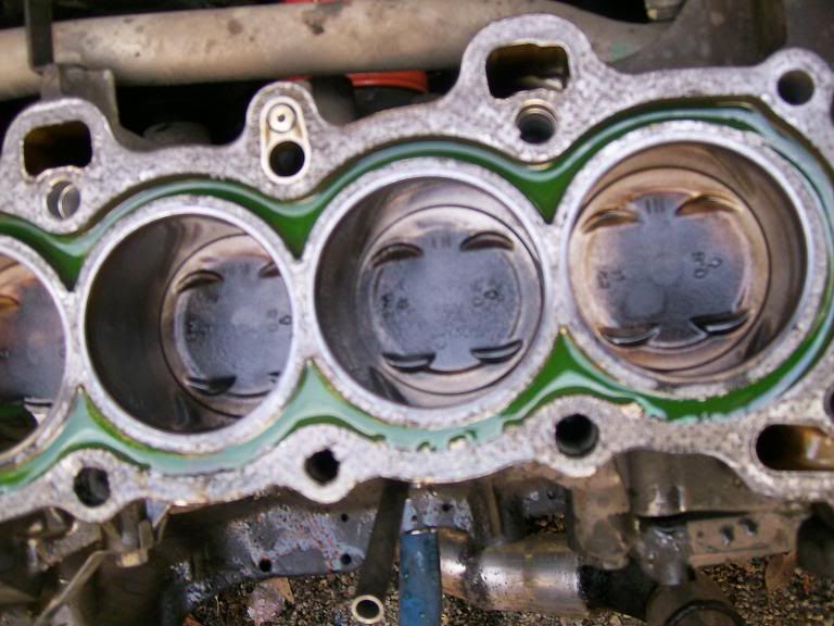

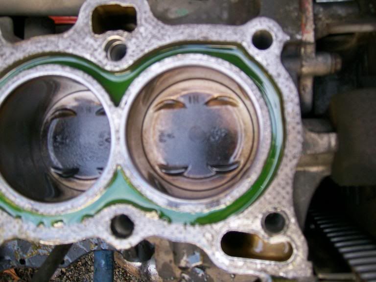

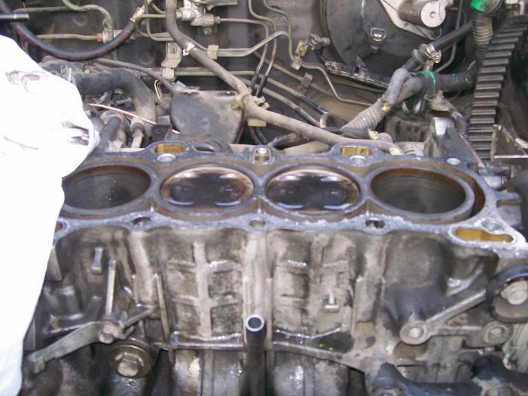

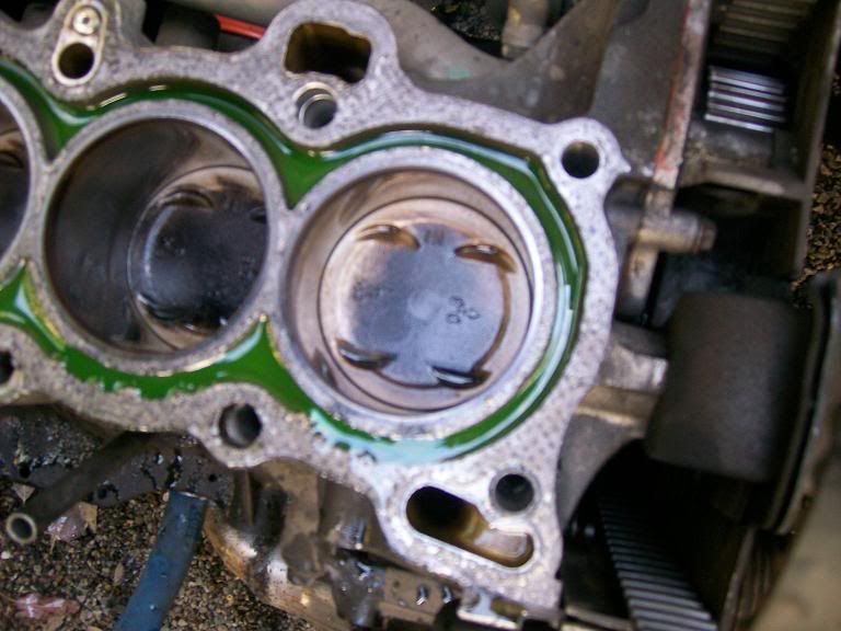

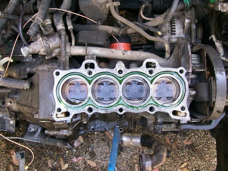

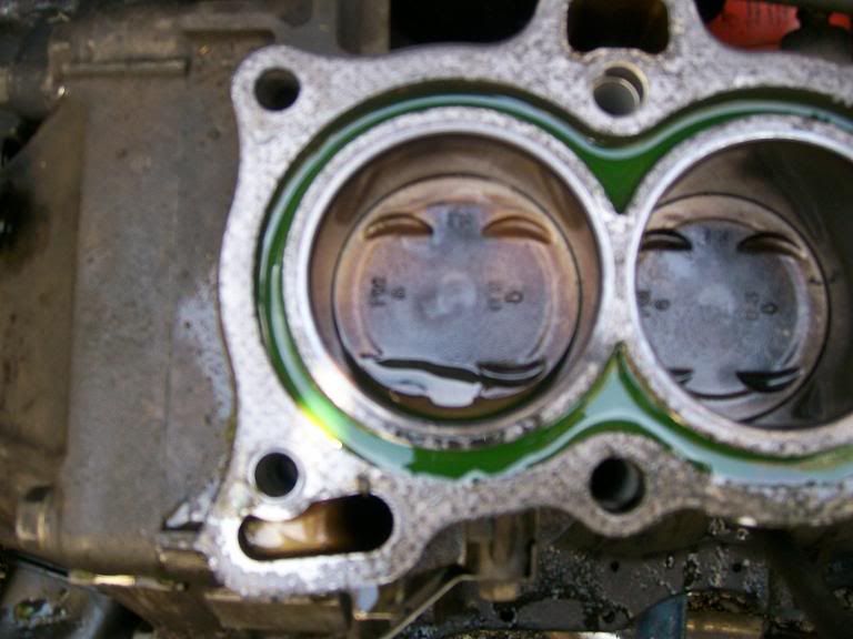

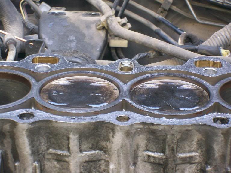

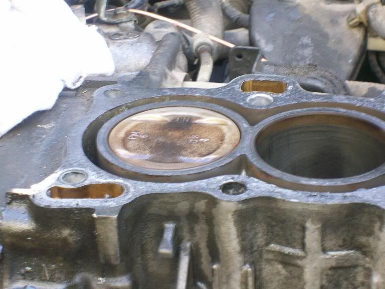

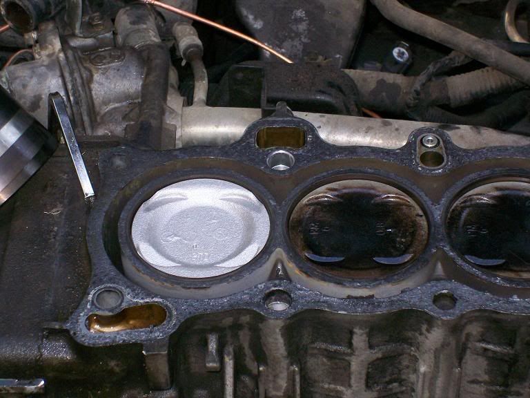

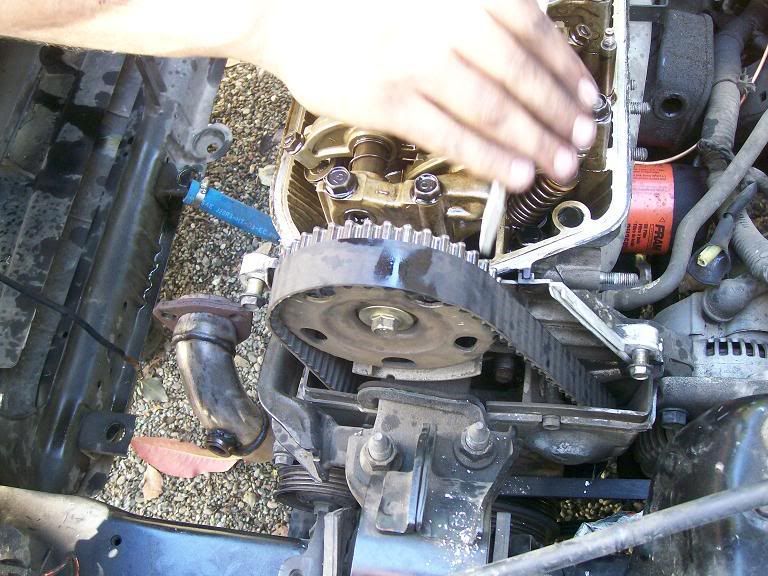

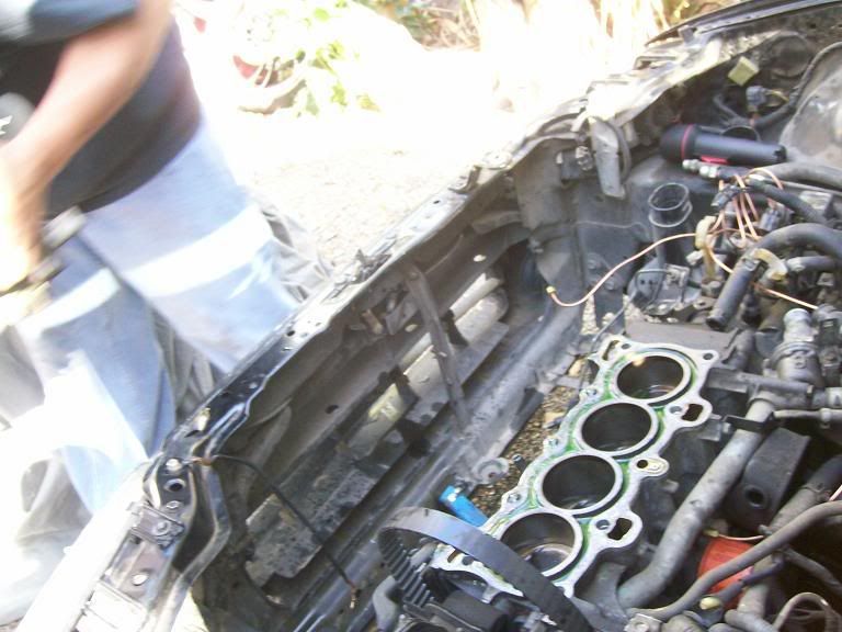

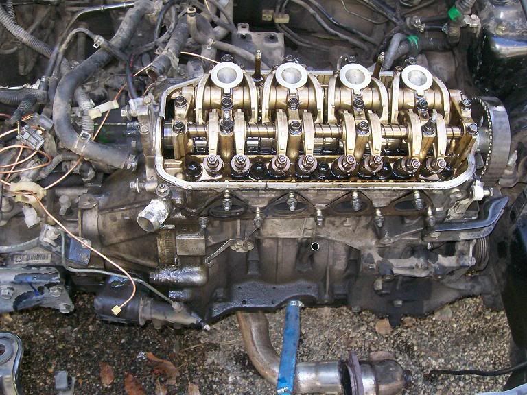

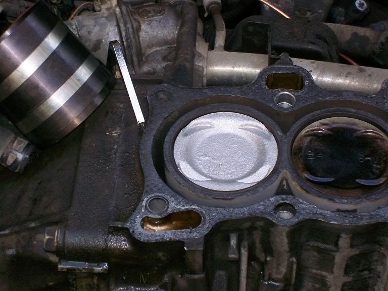

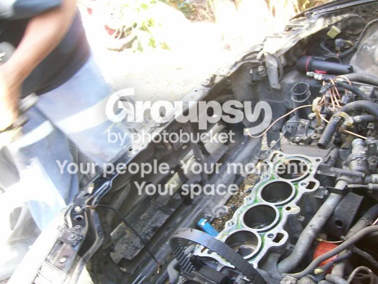

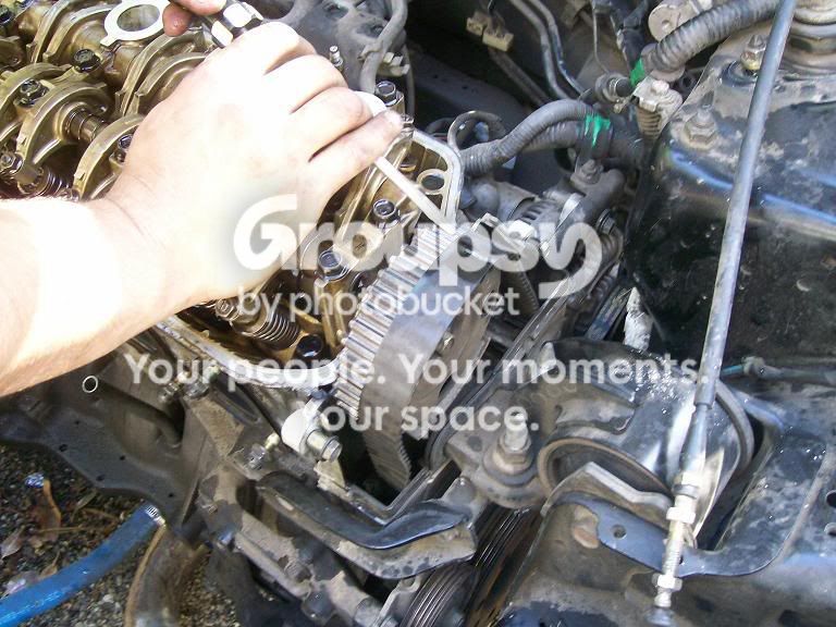

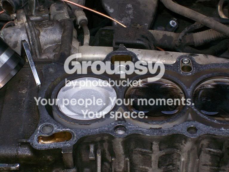

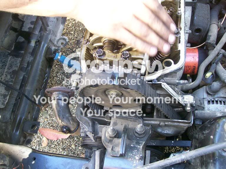

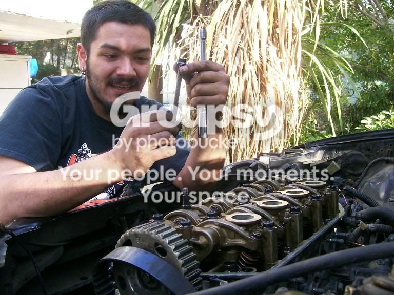

so.....   I thought I would update.    I have cut/paste from my post on turbod16, but I will stress;  he drove it untuned, and raced people untuned, so this is why this happened =)  I don't want people to start faulting my tuning for this:
Well, here's the updates...
Loud tick.... took the valvecover off and nothing wrong.
took the head off and:
#1 was .025 below the deck at TDC
#2 was .124 below the deck at TDC
No measurements on 3 and 4, but you get the idea.
He knew it would happen... it would happen if he drove in boost and/or beat on it before I got a chance to put the wideband in....    I even gave him a wideband to put in, and he waited a few weeks to put it in.
That right there, well, tells you why.
But;  alas;  he knows his mistakes... and keeps blaming 6PSUI on a small-ass turbo for blowing his motor, but whet he really is saying is "I know I F'd up and oah well".
So;  we picked up an old D15B7 bottom end from a friend for free.... and we're just fixin on what head we are gonna put on it when we install it.
Pictures?  of-course!
snarf
  • Posts: 188
« Reply #35 on: April 18, 2009, 12:48:55 AM »
Post pics of the whole car and not so many of yourself.  JK
« Reply #36 on: April 18, 2009, 09:25:32 AM »
Hello, sweet hacker.
« Reply #37 on: April 18, 2009, 05:17:19 PM »

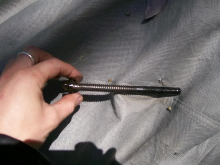

you really like those aftermarket head bolts eh?  :)

Ahh, Mr Joseph Davis!  I knew I would see you around again!
Those headbolts.... I think those were stock in the ZC.... pretty odd that they have the spiral down them, I guess for strength... I dunno...
we sell the exact same bolt though NAPA...
