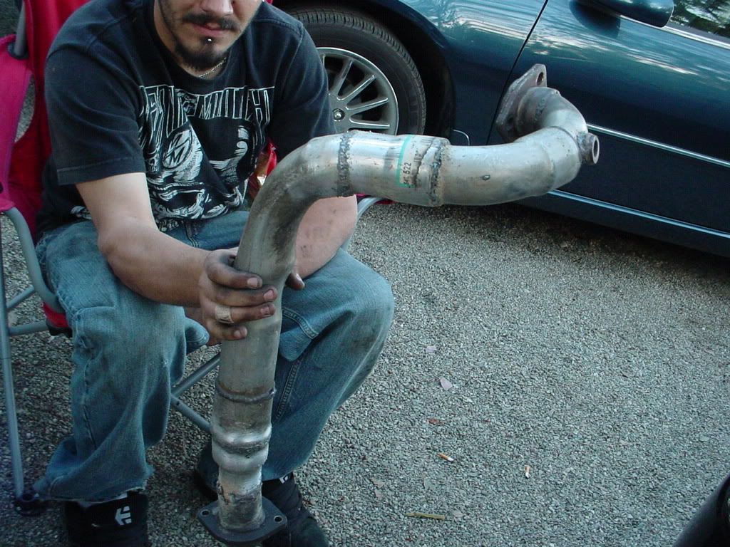

just run a 90* off the turbine flange pointing down.. you're going to be hurting with that down pipe

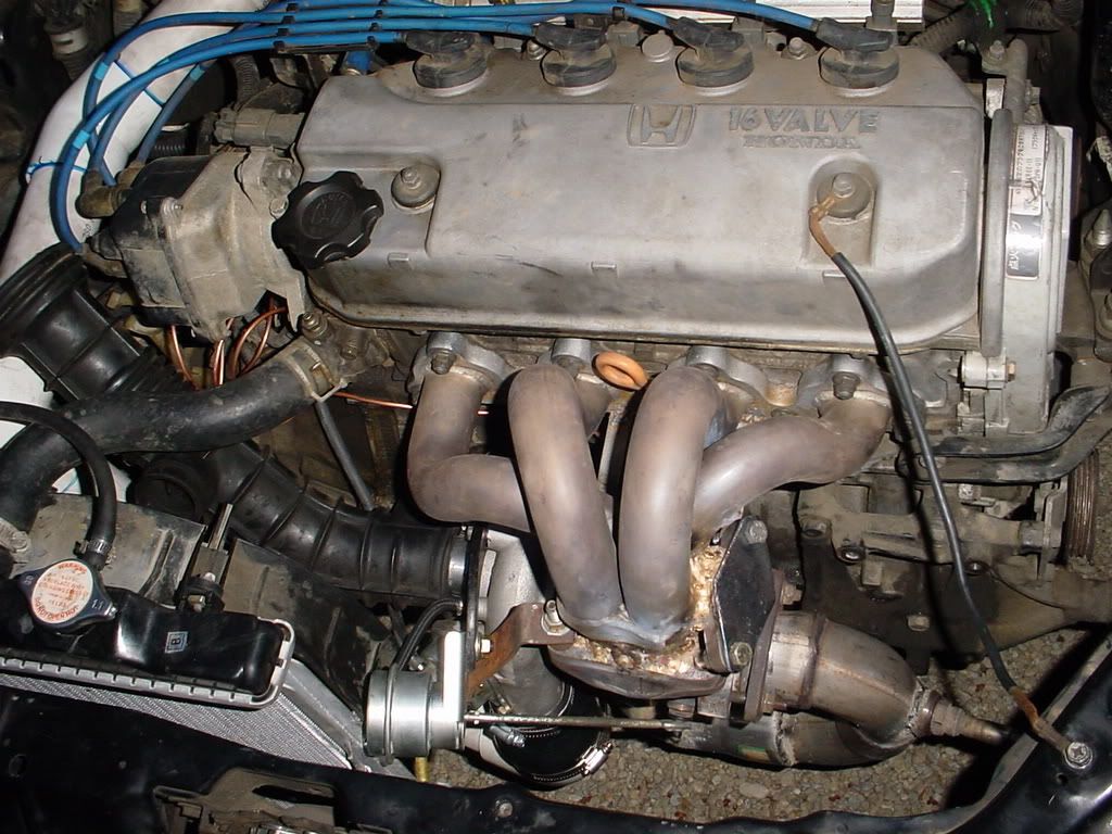

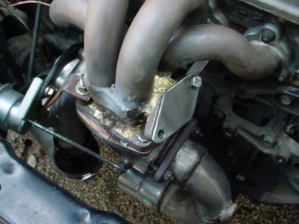

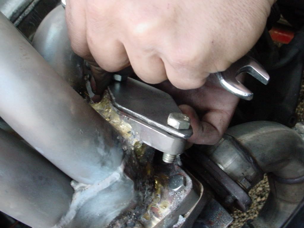

lol @ brazing.  Hope it's welded too and the brazing was for leaks. Awesome  :noel:
Re: A REAL HMT: $149
« Reply #18 on: March 26, 2009, 07:50:50 PM »
you better pray your egt's dont melt the brazing on that manifold, if you have a welder why the fuck did you braze it?
My EWG is brazed onto my cast iron manifold. Put right at 3 months on it and ~5k miles. Works perfect.   :somb: O0 :?: :noel:

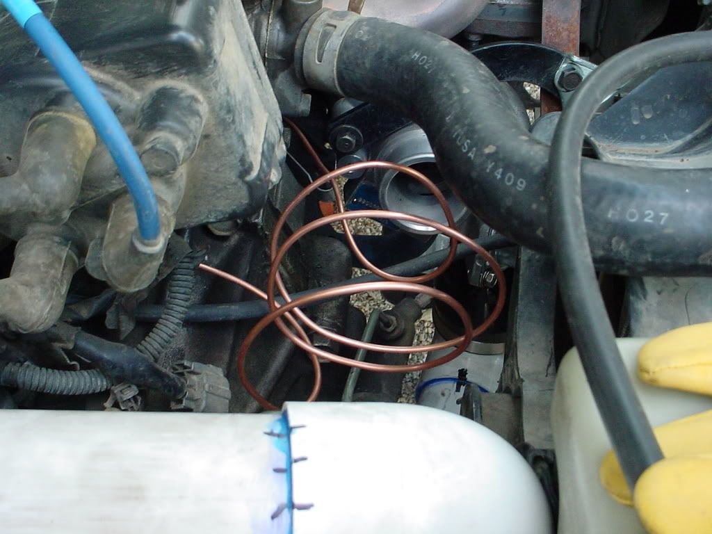

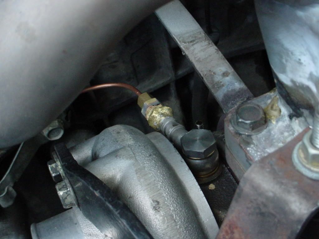

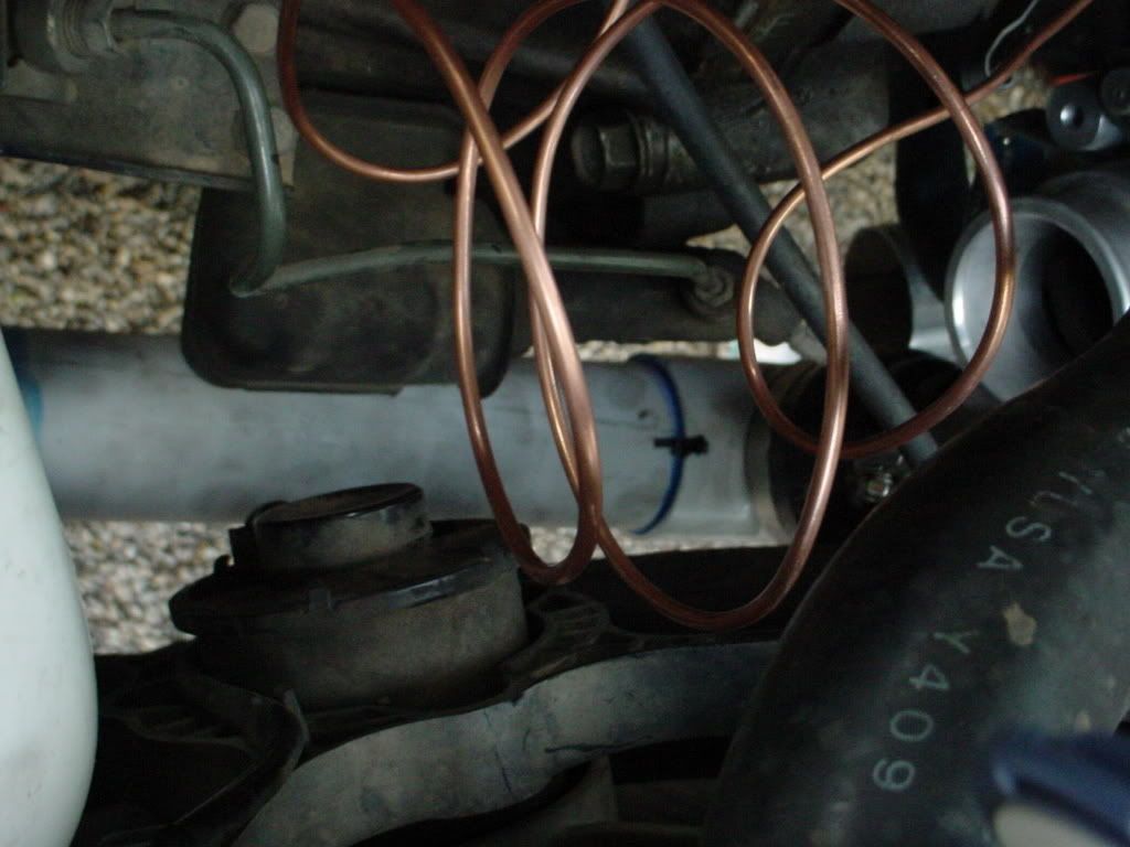

thats a oil feed/oil cooler all in one. good job

Brazed?  Hell yeah...  Bronze rods are WAAAAAAY cheaper than mig wire =P  plus... they bond ANYTHING =D

This is a real HMT.. My friend was wanting to turbo his DX since I did my turbo and turbo/supercharged D15.  A while back I was given a deadline to get all my car parts out of where they were being stored.. so I moved them to this guys house.  He had been eyeballing my old junk manifold for days, and thinking of using it for a "fuck-it" setup on his car.... so we hit pick n pull and found one good turbo... this little bastard out of a non-intercooled Volvo.
Sucker came off the car with little effort, so we knew it had to have been replaced sometime within the last10-20K of the car's life.

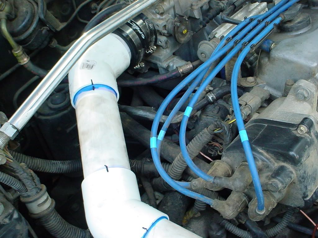

From there it was just cutting/hacking, a trip to ACE hardware for the PVC and glue... and a stop by Kragens/O'Rieleys to get an oil feed line.    But... we had a dillema...
They don't make brass fittings the thread of that banjo... not at all.. we checked all of ACE's fittings, and auto-shops around the area and found nadda.  So.. we figured, we better make it match that manifold.
anyways, we hacked up a DP for a cast manifold and a T3 super60 I have had lying around, and decided to slap it all in on a saturday when he was off work.

lol great work! I don't care how ugly shit is, as long as it works. There are plenty of morons that put on full-race gear and can't get the car to simple START to save their lives.
So is he sticking to low boost & stock injectors? I'd guess they'd be okay for 7psi or less with that turbo (50trim t3?) since its non-intercooled.
FYI bronze melts at 950C, alloy even higher, and egt's would be under 825C as they leave the head.
