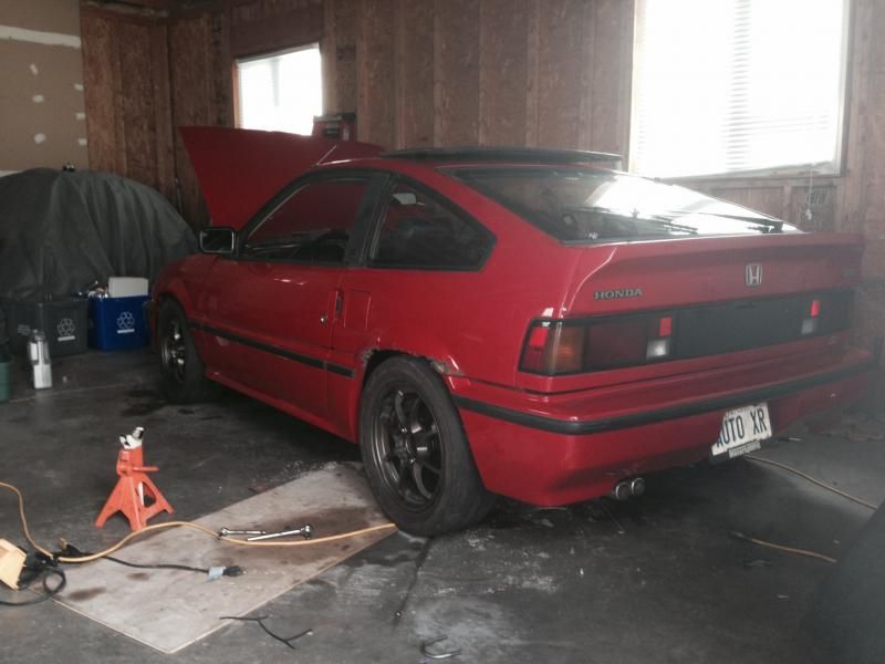

Just need to replace a wheel cylinder and bleed the brakes.. Track day on monday.  Used a Fiero front sway bar in the rear (23mm) with bushings from a pathfinder (poly) and endlinks from my old S197 ... Very  :mexi:
Borrowed some Kosei wheels, got some Free RA1's
ended up building my own exhaust.. uses a pypes M80 silencer I had lying around, walker single in dual out, some shitty bends... and off we go. No cat needed.

Didn't make the track event and took the 911 instead (Would have rather taken the CRX)
Went to put it on the trailer 50 min later and it won't start.  Not even a sputter, not even with quick start...
I know I made one major mistake in Devac-ing (black box toss) and not keeping the sensor (MAP I think)  but i would think that even with a bad or missing map it would run.
What I've checked
- Fuel at the rail
-Pump primes
- Timing is right
-Plugs are fine
Any ideas?
