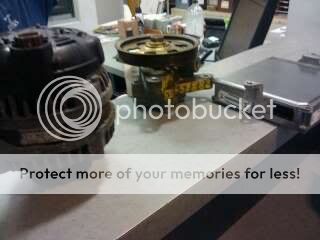

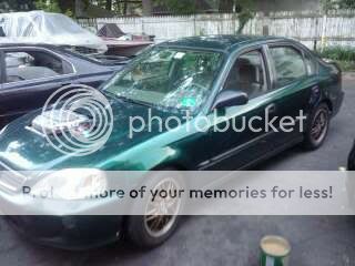

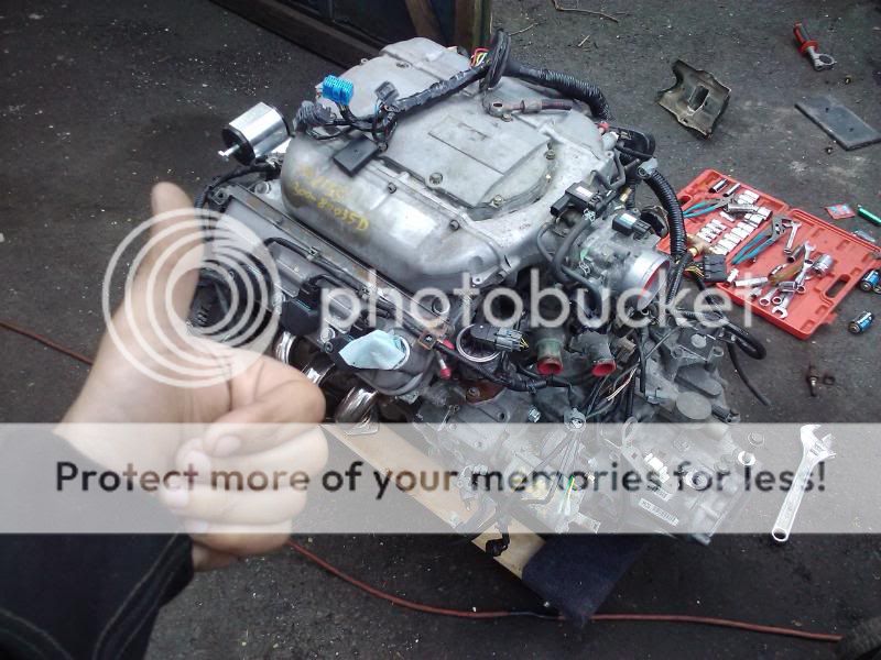

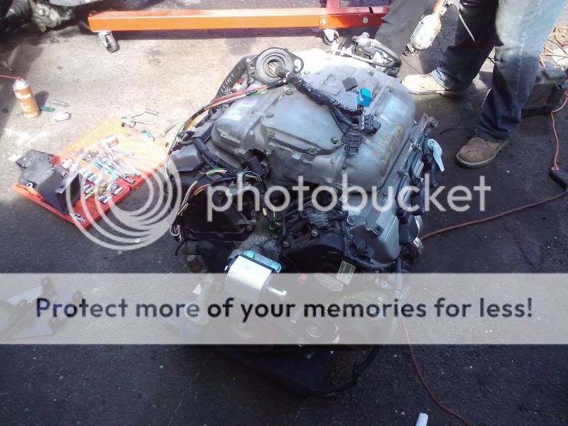

So sometime back my older brother pick up a 99 4dr dx. It was his DD for a while, and while the stock 130k y7 ran good and got good mpg he got bored quick. He started thinking of the usale stuff, boosted D, then came built and Boosted D, then B, ect. After a while og going back and forth he made up his mind on a J swap. When he price it out it was going to be cheaper then a k swap but with a lot more balls. After saving up for some time the parts started coming in. The motor is a J35 of of a 03 odessy, Tl 6spd trans with lsd, hybrid racing shifter box, and hasport mounts to name a few. Well lets get into some pic's.

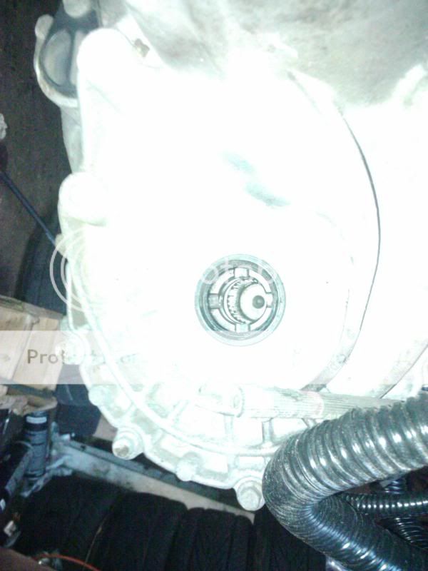

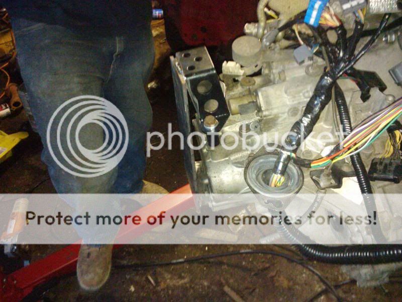

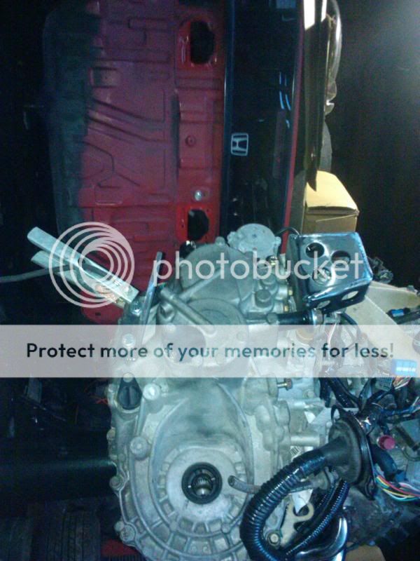

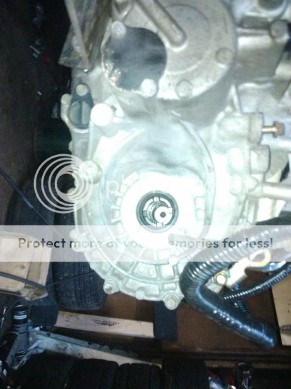

Tl 6spd trans with Lsd

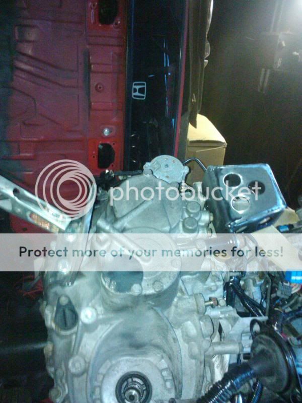

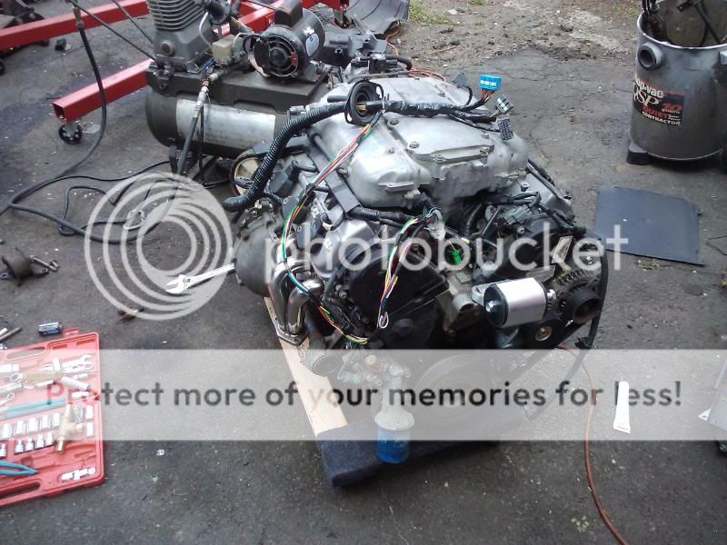

Motor and trans

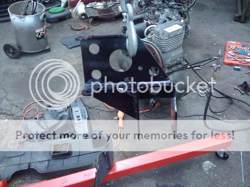

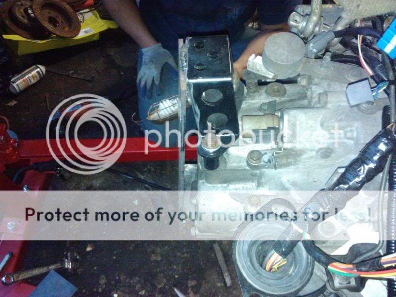

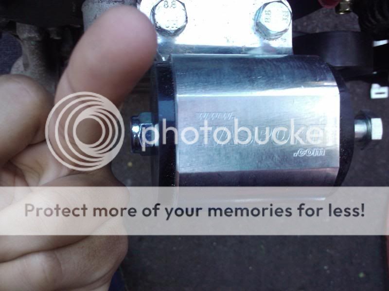

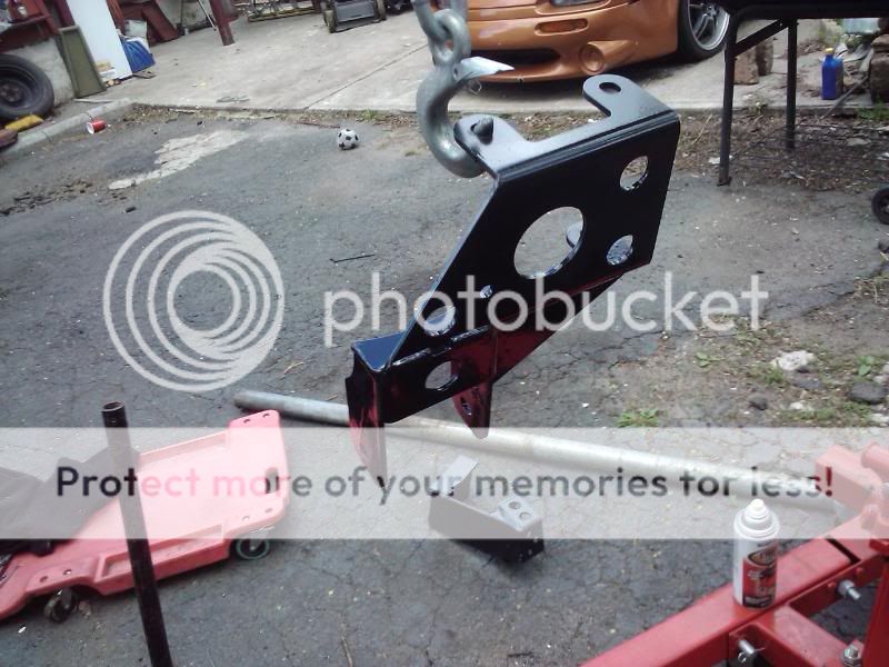

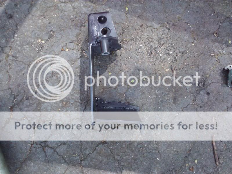

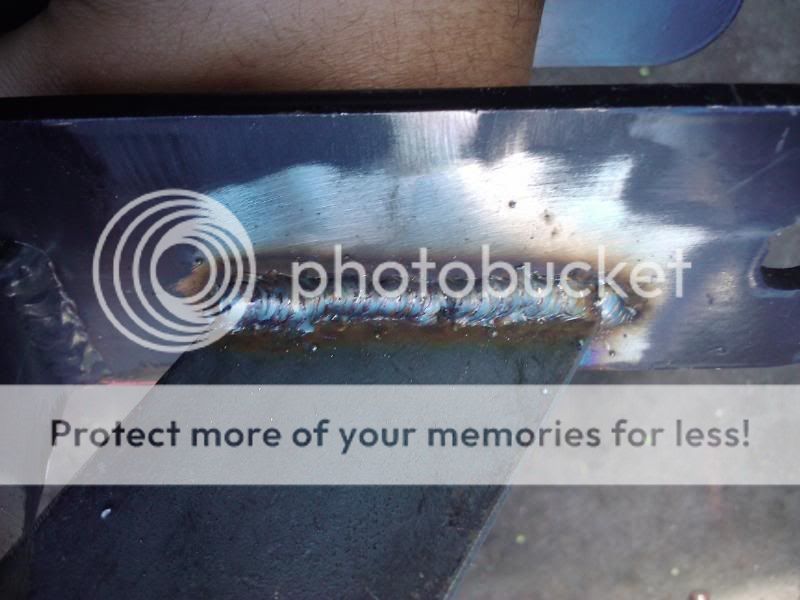

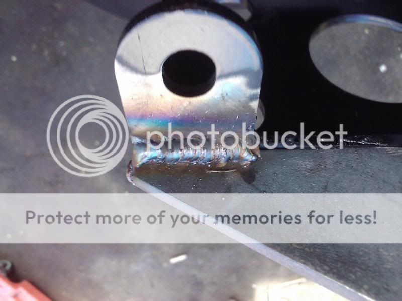

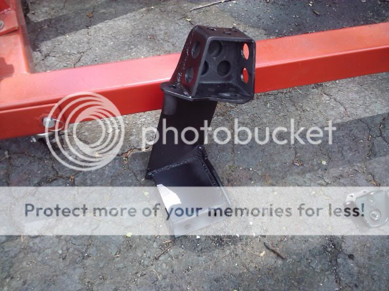

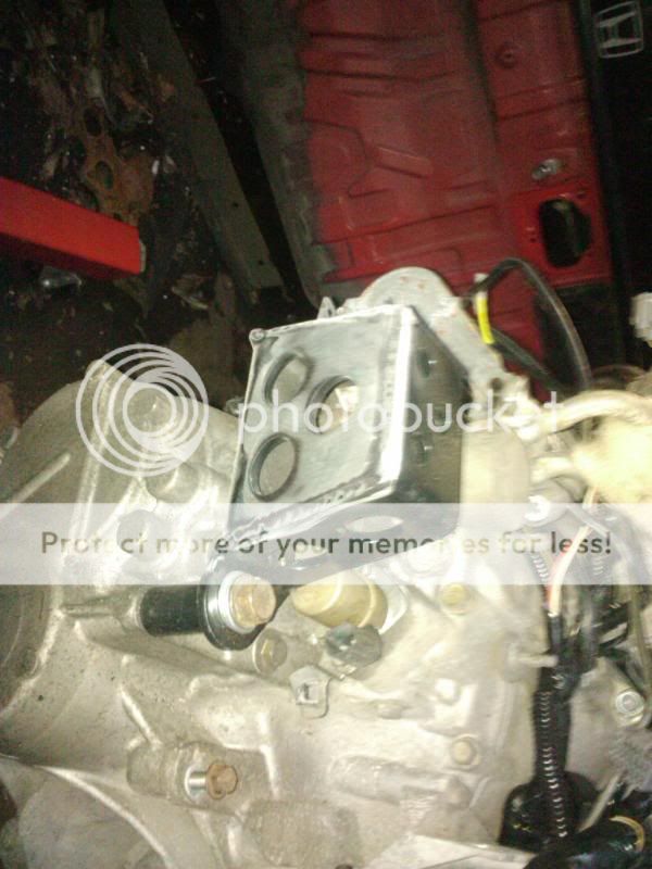

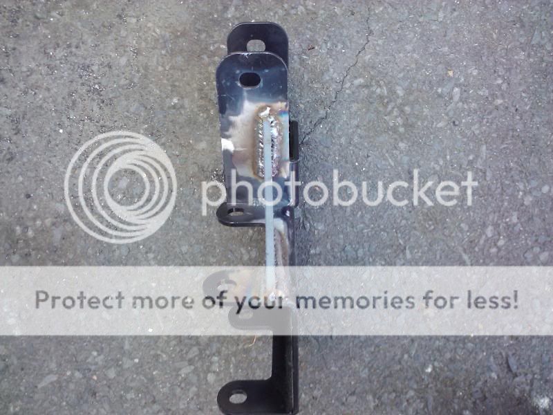

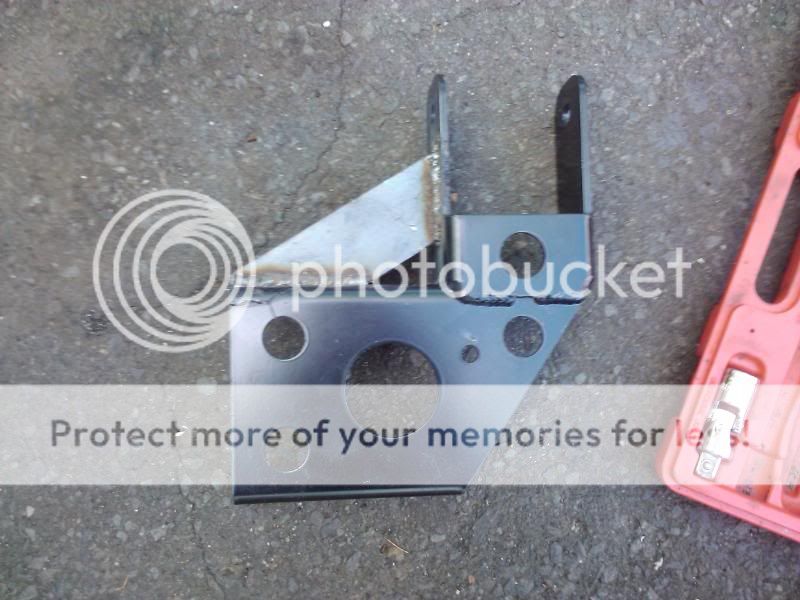

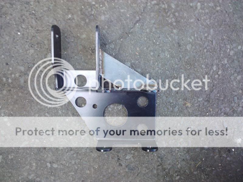

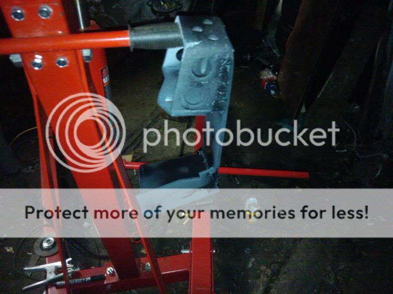

Moding the stock hasport tans mount. A lot of people have broken this mount and the trans at the track.

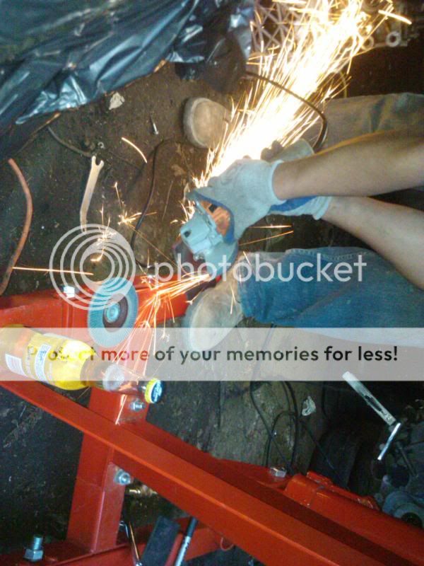

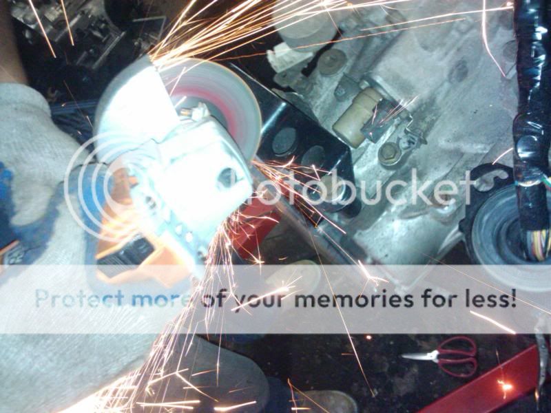

Cutting 1/4 steal plate with a cut of wheel :-X
So after hours of cutting welding, and grinding it was done.

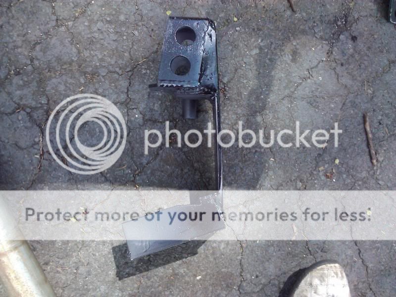

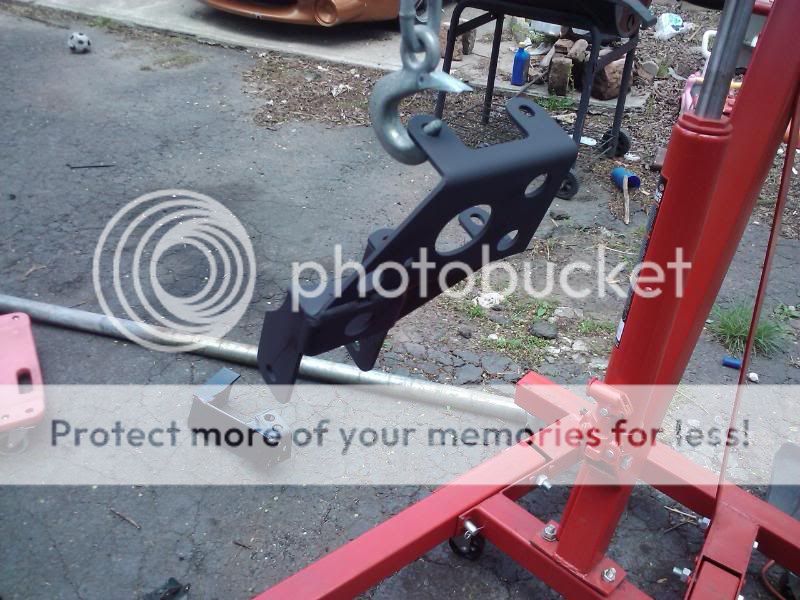

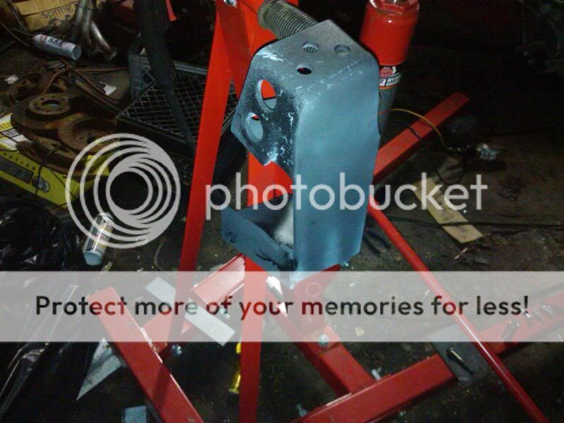

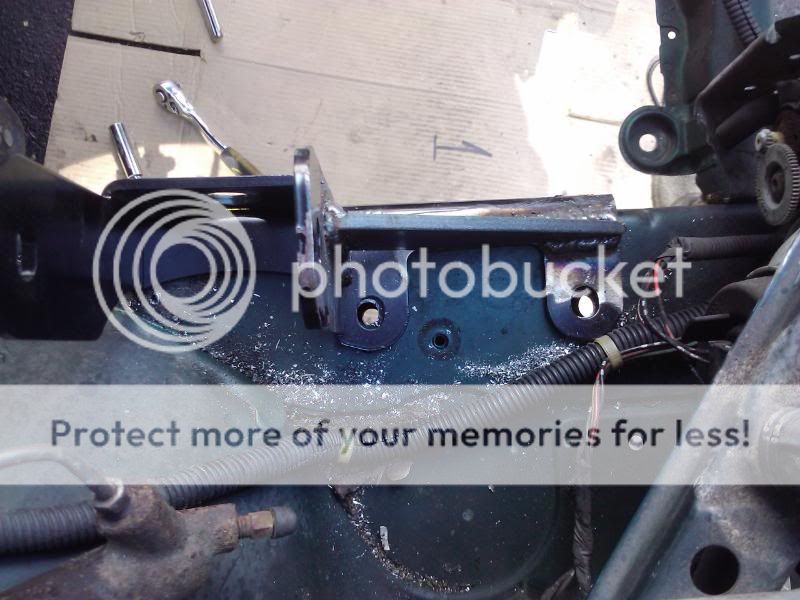

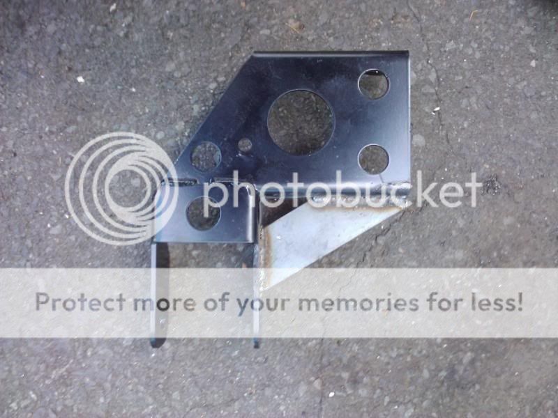

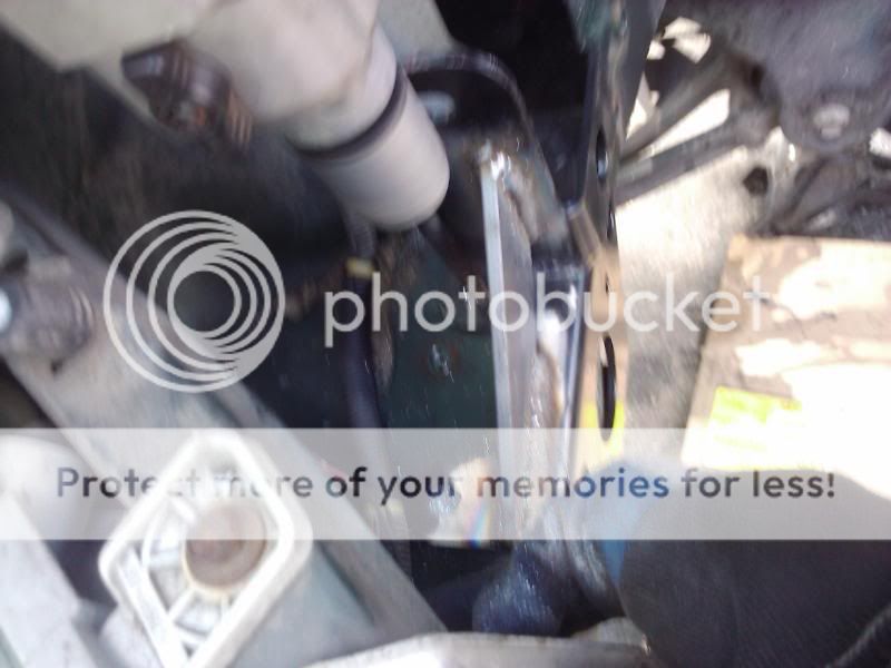

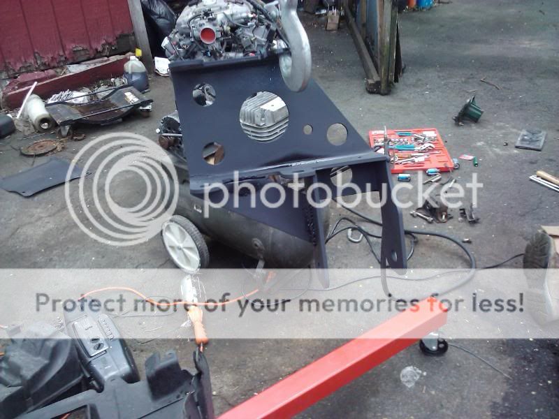

After the trans side was taken car of next came the Engine bracket. Due to the extra weight, and tq of the J compared to the K the some guys have bent this to. So moding time part 2.
You can't forget the BBQ paint.
This is what I think about hasport right now,

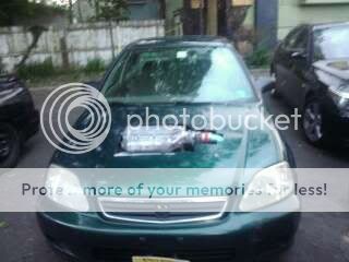

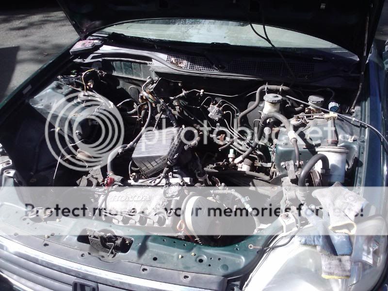

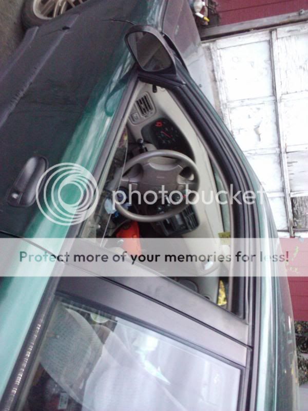

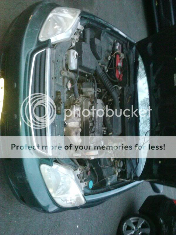

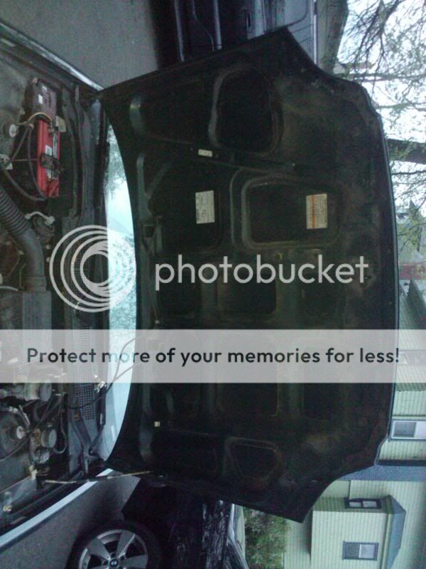

Stock hood before being cut.
On its way out.

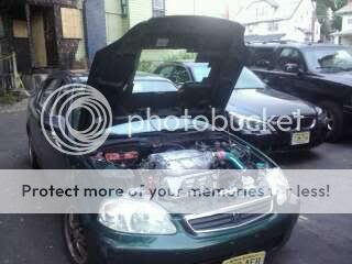

The baller door :evil:
The bad boy :noel:

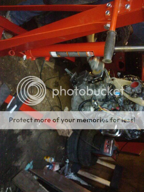

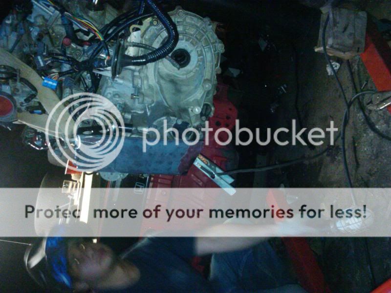

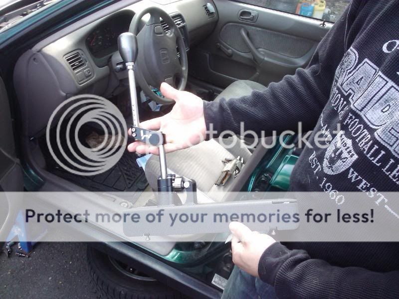

Hybrid racing shift box, damn box was more then the motor :P

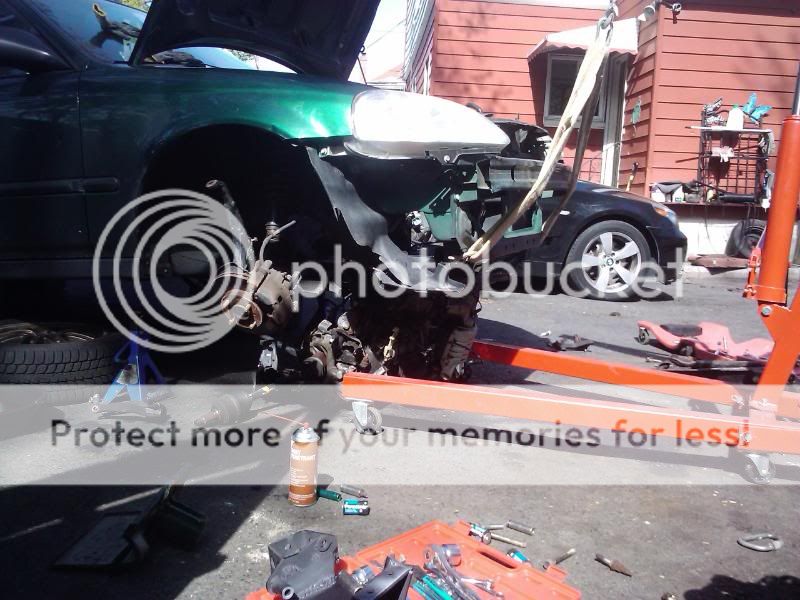

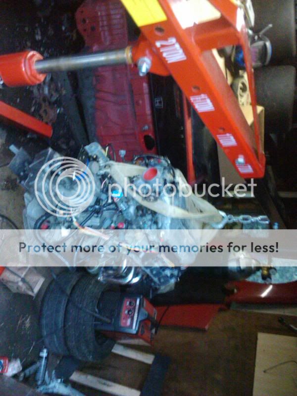

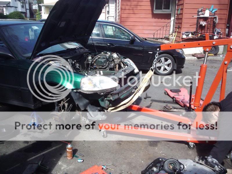

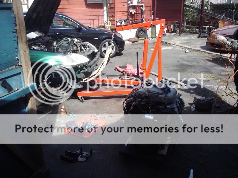

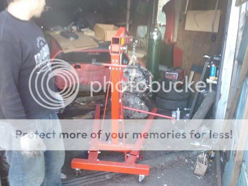

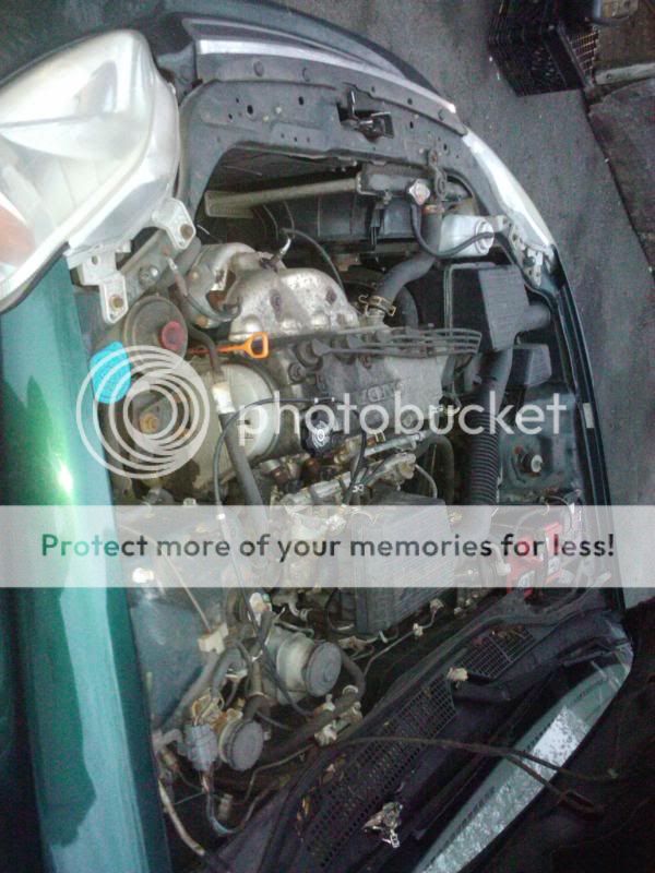

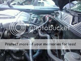

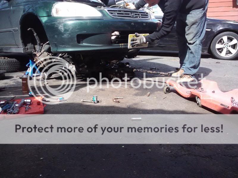

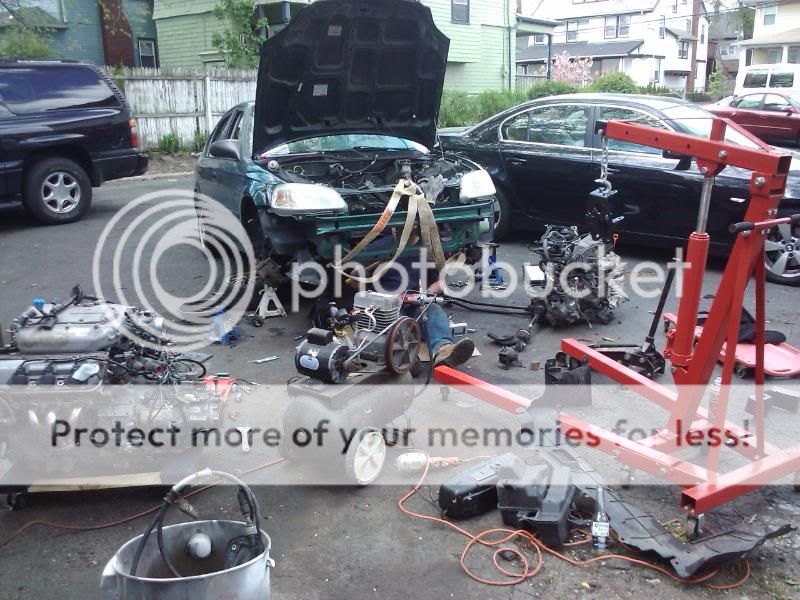

Getting her nice and high.
Then she was out.

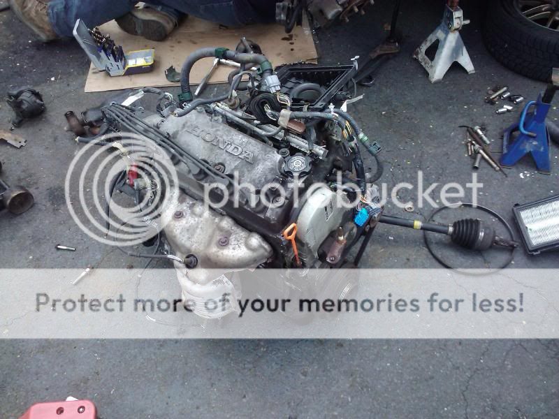

Slow y7.

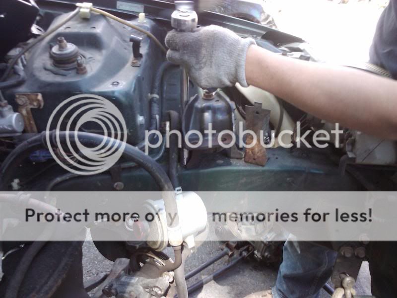

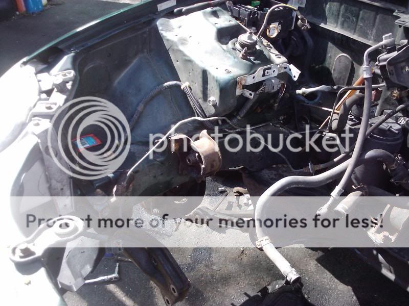

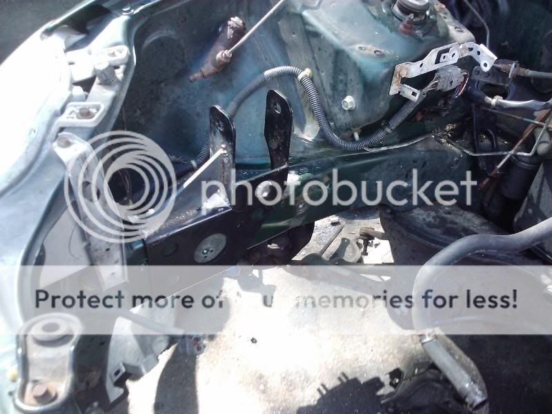

Onto the mounts.

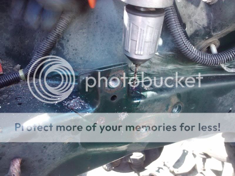

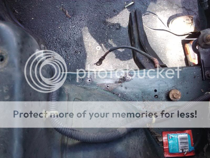

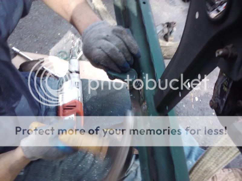

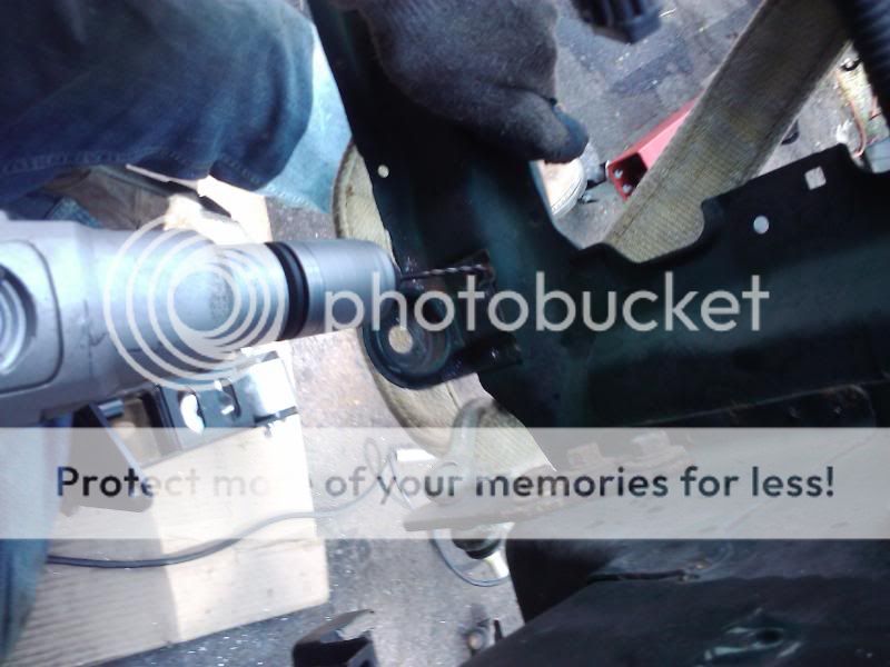

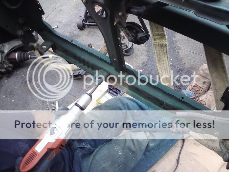

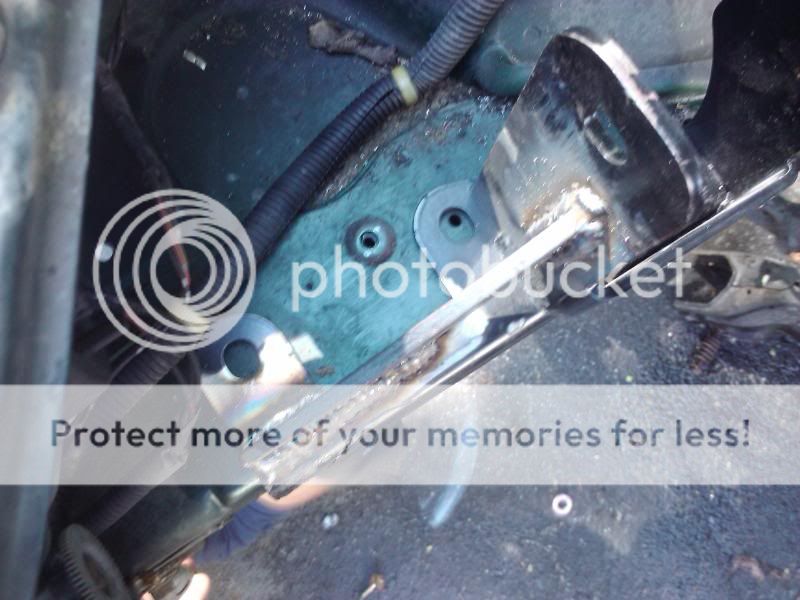

Spot weld drilling starts.
Then the bitch was gone.

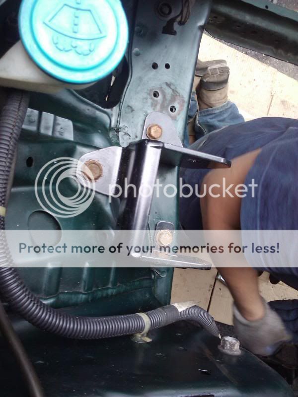

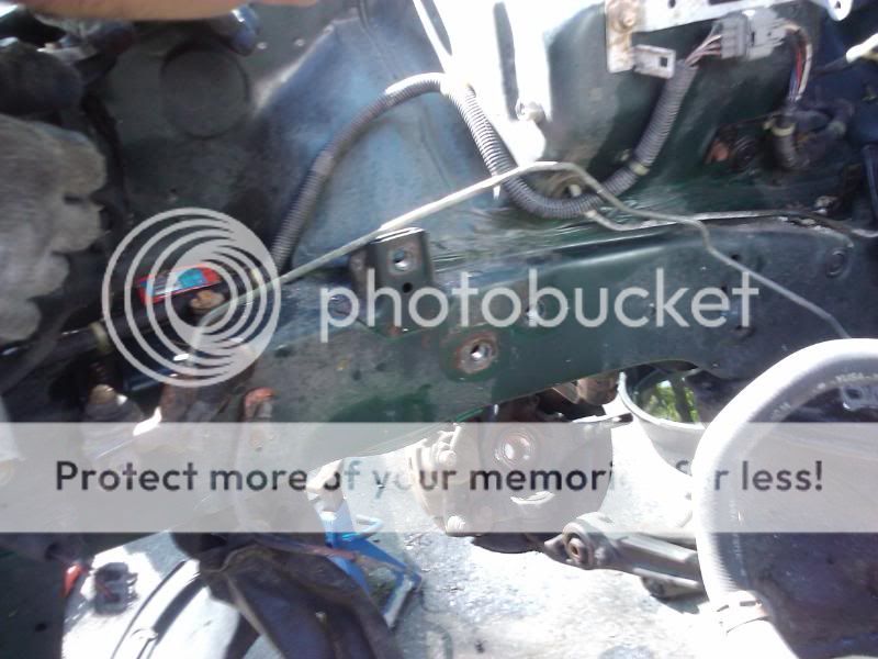

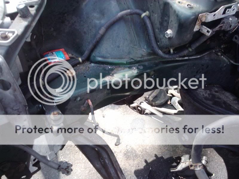

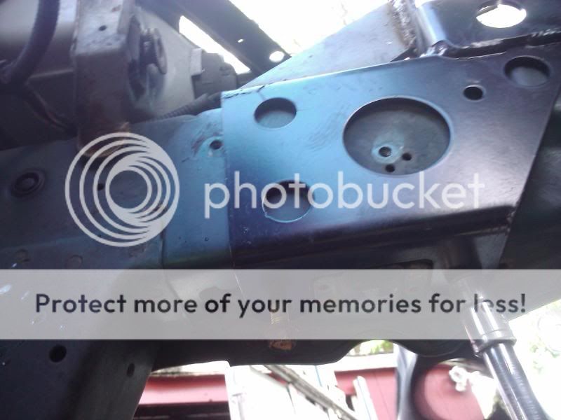

Test fitting the bracket, and marking the 2 top wholes to be drilled.
Next was removing the rad tabs to be relocated. Man do I hate drilling spot welds!

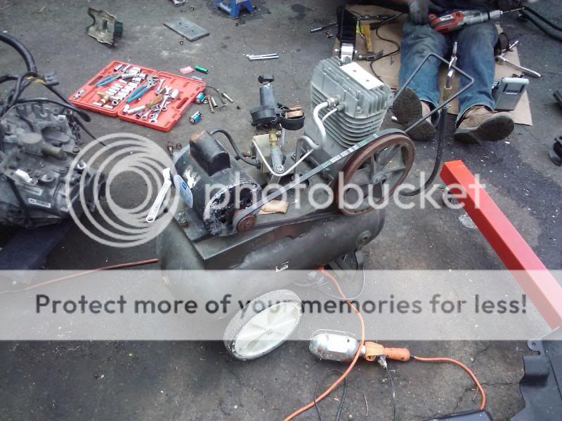

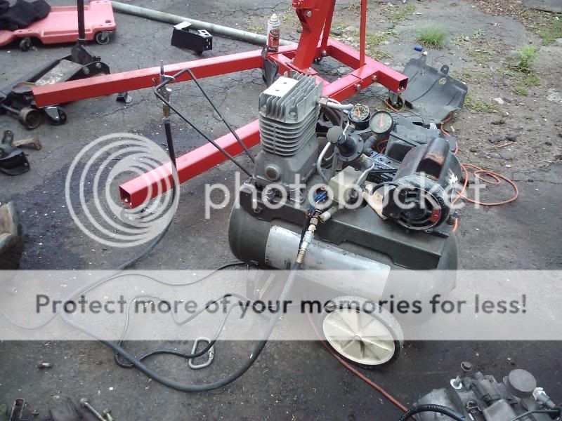

Work space.
Old school pimp sears air compressor bitch is super quite.
And back to some more drilling.

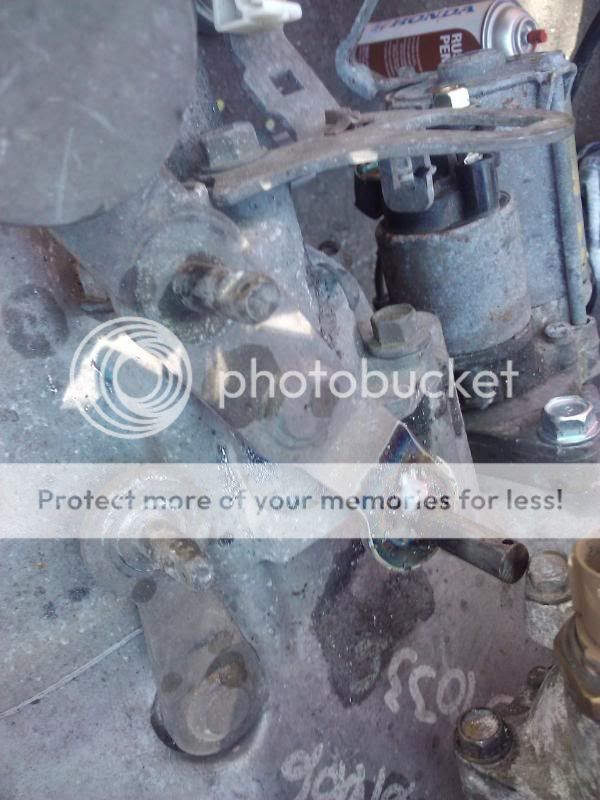

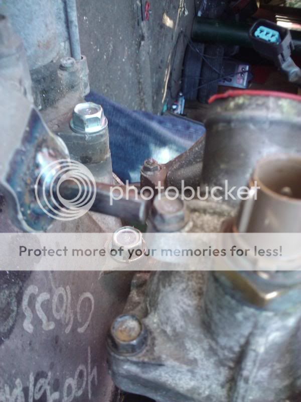

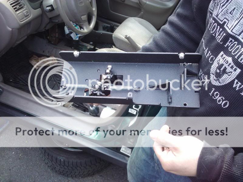

Modding the shifter leaver.
Home made pin which was a bolt that was cut, welded, and drilled to make a new location for the shifter cable.

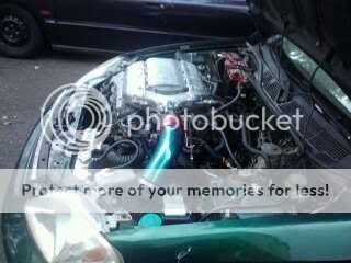

DAMN im fucking SLCAKING on up dates. car has been done for a bit. Its running hard for a stock motor. well enough talk on to the pic's and rippers!

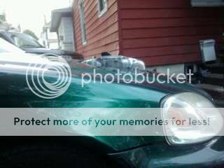

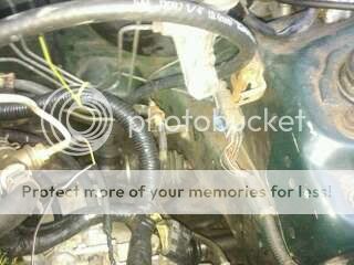

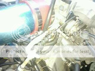

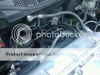

Stock fuel lines!
The cut!

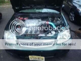

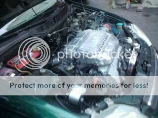

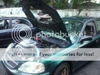

J swap and the smaller D!

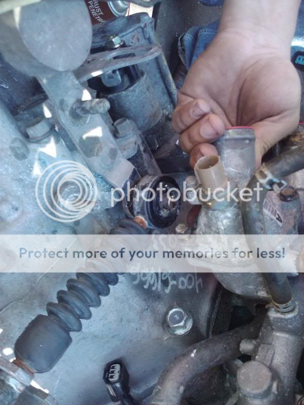

Don from ROM systems is the MAN! I forgot how much was it, the trans was around 1k. For the price of the trans we could have bought 3 motors. :P
With that said we had a slight issue with reverse witch was due to the lock out switch not being hook up. Not sure if i took pictures, but these trans are SUPER beefy. Gears are super thick, side by side with my type r trans and it puts it to shame.
