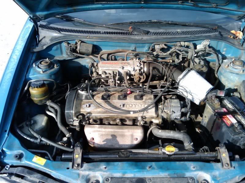

92 paseo 161,000 miles. $Free
Stock 5efe engine.  Air filter $Free

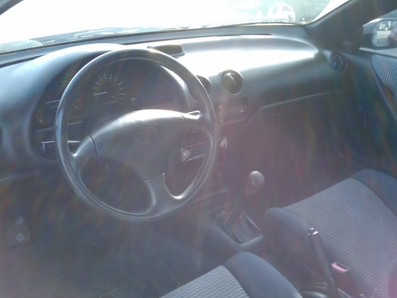

Interior is pretty clean

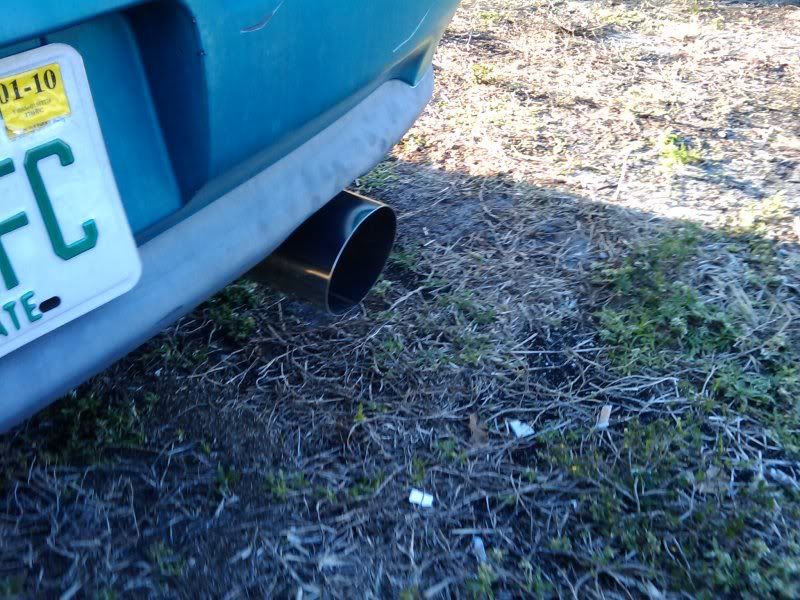

Genuwine blitz nur spec fart can. 2 1/2in. inlet 4 inch tip. $40.00
extension pipe. $7.48
I welded it on myself.
I will be running 3 inch exhaust when I get the turbo on so I figure i can cut the inlet off, drill the opening out to 3 inch and insert the pipe.

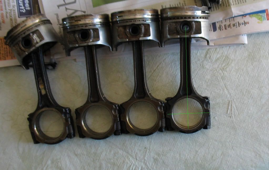

i got a set of 5EFHE rods, stronger then EFE rods and are stock replacement. only thing is one of them is slightly bent  ;)
$20 shipped
comes with free dis 5efe pistons, they have cracked ringlands
« Last Edit: March 25, 2009, 07:34:27 PM by t_cel_t »
$20 shipped
If I had another motor that I was buliding, I would be all over that great deal like white on rice

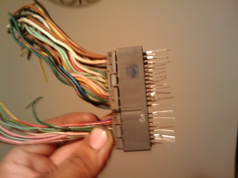

I went to the u pull today. I picked up the ecu connectors and an ecu for $30.00
I then took the ecu apart, cut the connector out of that and this is what I'll be using to make the plug and play harness. All I need is some heat shrink and time to solder.

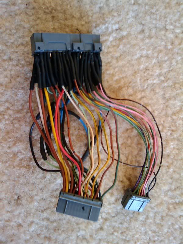

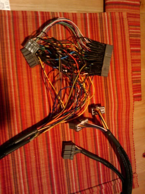

I made the plug and play harness and it works.
Here it is with the emanage harnesses attached. I'll find out if it is wired right within the next few days.

nice harness
Re: Economy sucks 92 paseo build
« Reply #24 on: March 31, 2009, 02:47:11 PM »
excellent harness
« Reply #25 on: March 31, 2009, 05:14:20 PM »
sweet harness! looks like a fun little project

Awesome harness.

that harness is some good work.  Most people aren't willing to do shit like that.
