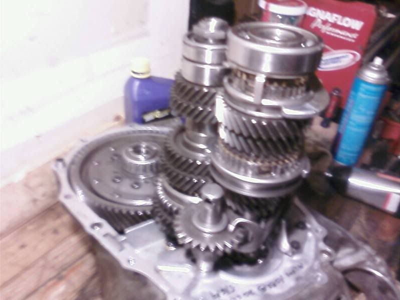

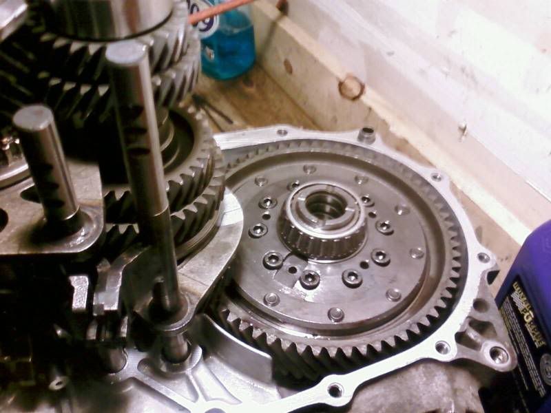

Just got done finishing up the new tranny for this pile of shit...
MINT M2F4 gearset and OBX diff with new bearings and shit stuffed into a fresh M2S4 case....  To replace the beaten M2B4...  It will be alot easier to get parts for it, and it is FUCKING MINT inside. Took the time to actually check all tolerances and get the diff shimmed to spec PERFECTLY for preload on the diff bearings. Got it close with the shim then belt sanded it to perfection  :O). New seals and shit too.
Need to get a Flow controll valve for it, and hopefully it will hold up but the tranny is seriously PERFECT. No wear on the sliders, syncros, dogs or gears.

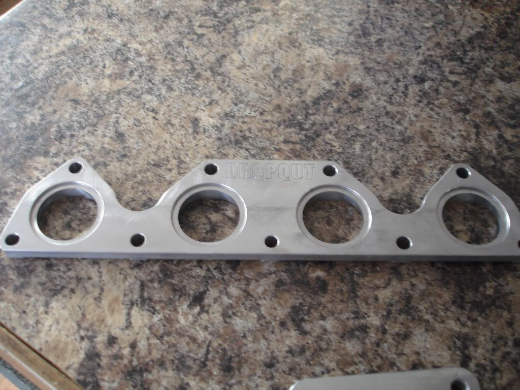

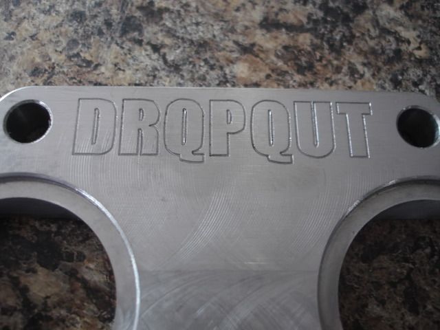

just got off the phone with chris @ precision they are 2 weeks out i should hear something in the next week or so
in the mean time this came in the mail this week

« Reply #116 on: November 01, 2009, 02:54:32 AM »
fuck ya, what kind of manifold you making? hopfully pte doesnt fuck you like they have done to me saying i starved my tubos and shit. shootin for more power nog
