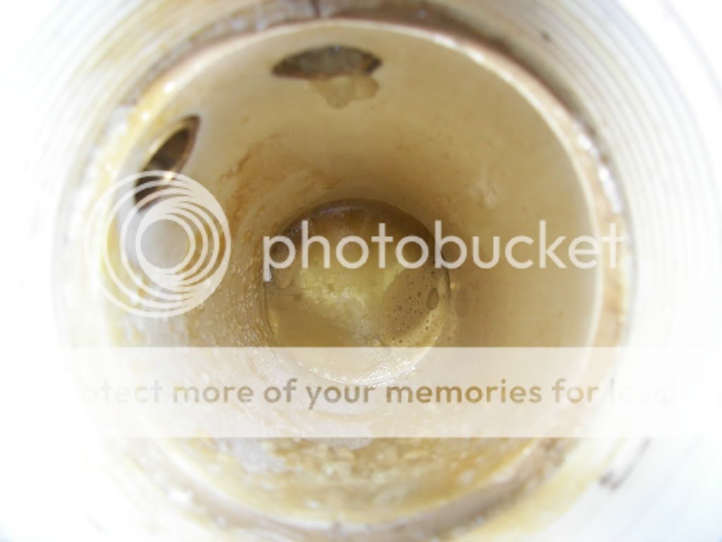

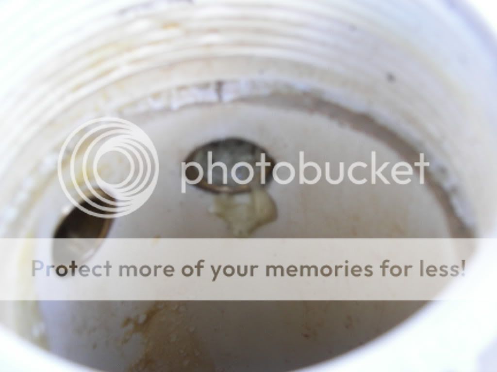

well didnt go to class today so i stayed home and pulled the fitv off took it apart put it back together and put it back on the car, then i bled the coolant system at first had foamy lookin bubbles then went clear after a min tightened that off ran the car for a few seemed fine , put in the clutch the rpms dropped from 1000 to 100 then started to bounce agin idk what the hell is goin on
then i opened up my catch can to see the line comin off of where the "black box" would be was full of the cum like goo? i wasnt able to pull the line off due to lack of time
here are some pics of the catch can , its made out of white pvc all the other colors is the shit it was talkin about there is also a good amount of moisture in there to

« Reply #19 on: January 22, 2010, 11:28:03 AM »
what u guys think of my catch can in all of its cum like glory ? ...i'v been readin and found it could be do to moisture but im not loosin coolant and the only thing that is poss is i read the changin temps realy cold to warm can cause moisture in a motor cold this moisture be enough to create the white shitty oil in my catch?

« Reply #20 on: January 22, 2010, 11:50:33 AM »
the moisture is condensation it has nothing to do with coming from your motor, its normal to have whitish shit like that under the fill cap or in a catch can especially when the oil gets that cold on on winter days....if its on the dipstick thats a different issue, that could mean some sort of head gasket failure.
