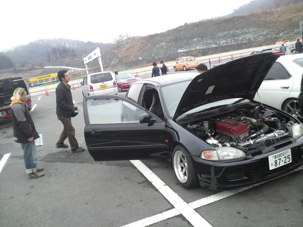

Was thumbing through some mags at wally world the other day and picked up import tuner (I think) they had a rear wheel drive EG with an S2K swap in it. Those bastards. Yours however does look much better.
