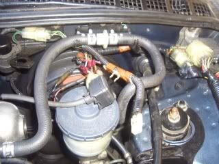

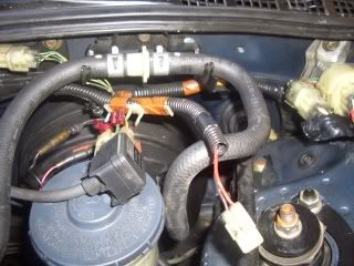

alright i was going through the wiring again and i spot something...  by the map and purge solenoids there is a 2 prong connector with a red and a black wire.  WTF is this?

pics to make sure we are all talking the same bottom left
Re: cock sucking code 7
« Reply #50 on: March 10, 2009, 05:14:02 PM »
on my way home right now to snap the pics
« Reply #51 on: March 10, 2009, 06:03:55 PM »
