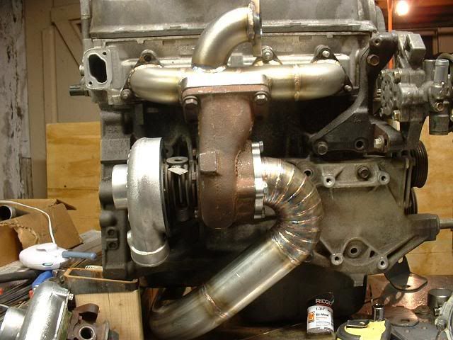

I am getting ready to build a log mani out of 1.5" sch 10.  when I set the t's on the flange it looks like I will need to cut some off to make them line up with the ports.  The two t's butting together are fine, but looking at the 90's to the T's, It doesn't seem like you can cut it without cutting into the radius on the T.  I could probably cut some of the 90 off but I dont want to cut too much off because I dont think it will meet up with the T well.  How do you guys do them?  Should I do it with 1.25" instead?

Figured it out.  Cut right to the begining of the radius on the T.  I then cut about 1/4 out of the 90 and they still meet up pretty good.  Just a little step on the bottom but no big deal.

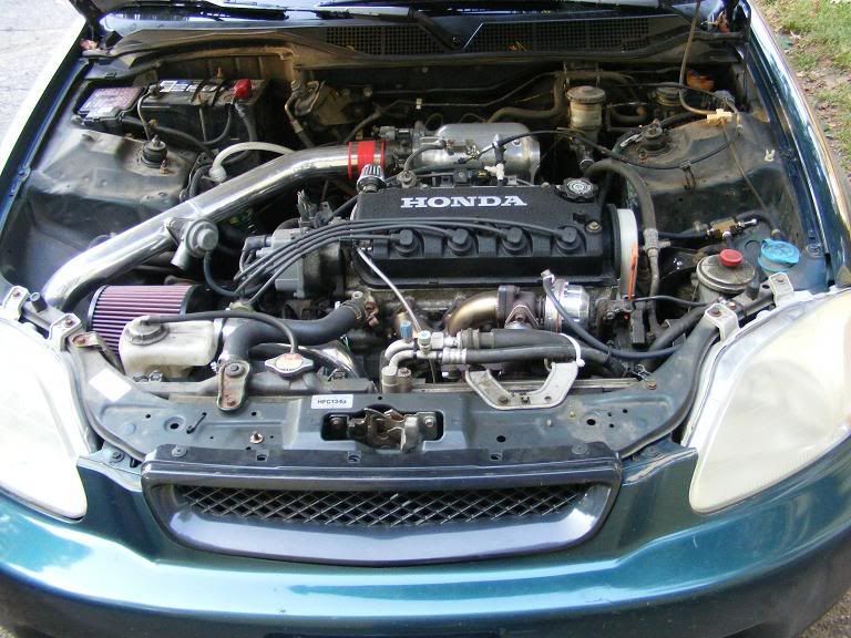

A/C compatible FTW!! Here was my sedan.
