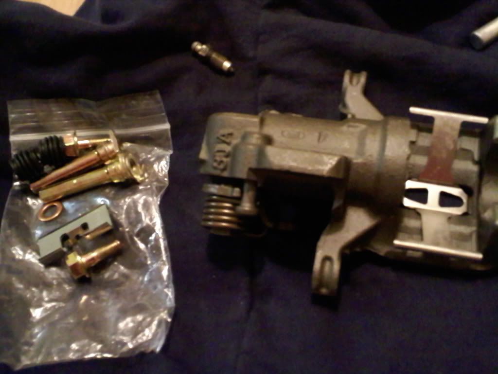

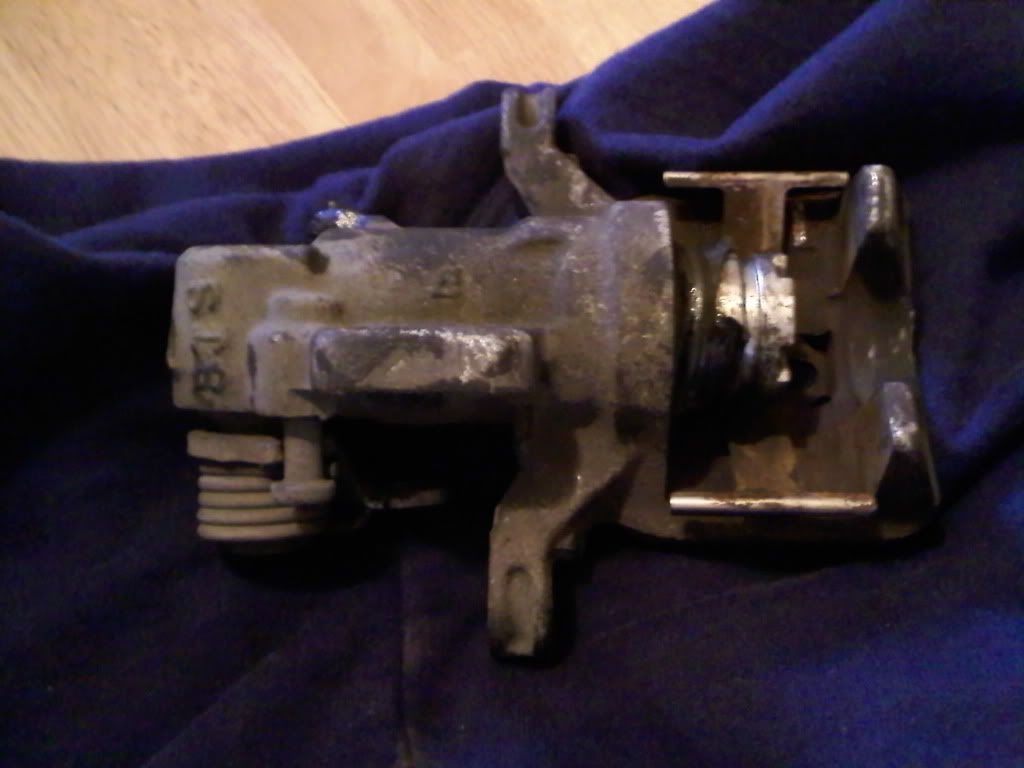

On the way home I noticed a few times that the rear right brake was squeaking/scrubbing. I decided to go ahead and replace the brakes today. Drivers side rear came off and went on without a problem. Still had a ok amount of pad left. The passengers side was a different nightmare.
The pads were completely gone and the piston was seized out. I tried my damnedest to get the piston to go back in, but it was bending tools and not moving. Ended up just buying a new one. Saved $15 for going ahead and ordering the front brake pads with the caliper purchase so looks like the front brakes will be changed as well.

Nope wouldn't budge. Probably been seized for awhile. The drivers side pads were about half left, the passengers side were down to metal. I had hoped to be able to rebuild the caliper since the rebuild kit was only $4.

Na I already placed the order for the new one.

Got the new brakes and caliper on today. I tried to just bleed the wheel I removed the caliper on, but it was still way too soft. I then went through and bled each wheel in order per the helms. The brakes pump up and feel really firm with the car off. When you start the car they get softer and the pedal goes down a good bit before you get any stopping power. I didn't have any air in the lines so i don't know what it's problem is.
