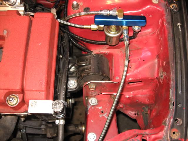

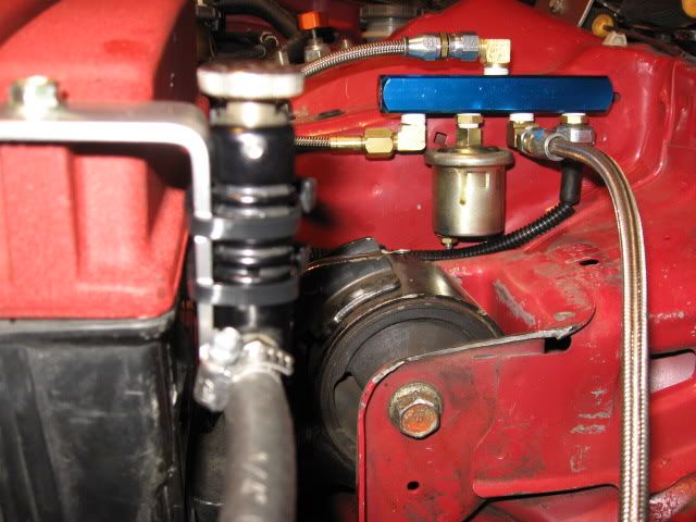

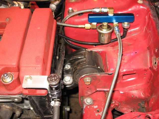

I built myself an oil manifold today, so that I don't have tee's hanging off the back of my block.  I also routed my Vtec oil line from the manifold too.  Now Ill sell my Golden Eagle sandwich plate and think to myself, why didn't I do this earlier.

Hmmm I like that. How is the oil pressure? does it flow enough volume from the block fitting to supply all of that?

Exactly what Ive had going on for a couple years...  No leaks, and free from vibration being on the firewall...   :noel:

I hope so.  I have not actually run the car yet.  The volume is not that big.  It's actually pretty small within the manifold.  The two oil pressure sensors will just be like a plug, so really I'm just teeing off the back of the block to the Vtec head and turbo.  Ill keep you posted.

Cool, I made the same thing a couple months ago, same placement and all  :noel:  Yours a bit cleaner, though...
If you want the oil pressure sender to show the pressure the engine is seeing, the oil hose coming into the manifold should be bigger than the hoses going to the turbo/vtec.

i hope that your not pulling oil from the stock oil pressure sender spot  :-\

what fitting did you use for your stainless line to the back of the block?

I have a similar setup and I am pulling oil from the stock location.  I drilled it out to 1/4 NPT though and run a -6 off the block to feed the distroblock.  Oil pressure is great.  about 70 on startup and 15ish at idle when warm.

Yeah, I am.  Why?  Its an 1/8" NPT to -4AN fitting.

Ive  heard of people running into vreck not working when you pull it from the stock oil sender location. I dont think it flows enough oil for the head and the turbo at higher rpms.

That's my concern too, Is there somewhere else to pull it from or do guys just go to a sandwich?

I've seen a fitting that goes in place of the one plug on the oil pump not sure how safe it is to tap into that location but it def would provide enough oil pressure :-P

I think its more to due with the amount of oil and not the pressure, the oil pressure port is kind of small to feed a turbo and vtec head...but you might be fine...

You have to consider pressure and volume. When you add another device in the line, you'll have a pressure drop. I don't know shit about hondas, but I've seen threads where people did what you just did and fucked up something from it not getting enough oil. Personally, My turbo has it's own feed. If I had vtak, it would have it's own feed too.

Which is why I'll watch the oil pressure.  My guess is that oil pressure will be fine until Vtec kicks in.  Then there will be about 10psi pressure drop, to 50psi, which is still fine.  But Ill let you all know!
