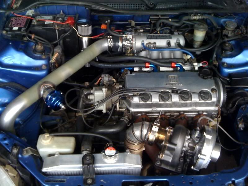

What spring do you have in your bov? I was looking at the pic and it dosent look like its the adjustable style of bov. My guess is that its blowing open the line to your wg. How big it the vaccume line to your bov? Maybe upgrade to a 1/4" line if its small like a 1/8" line so the added volume in the line will help hold the bov closed? Just a guess.  :-\
Its a Tial BOV, it is adjustable and it is opening fine, this compressor surging issue is at WOT though not BOV related.

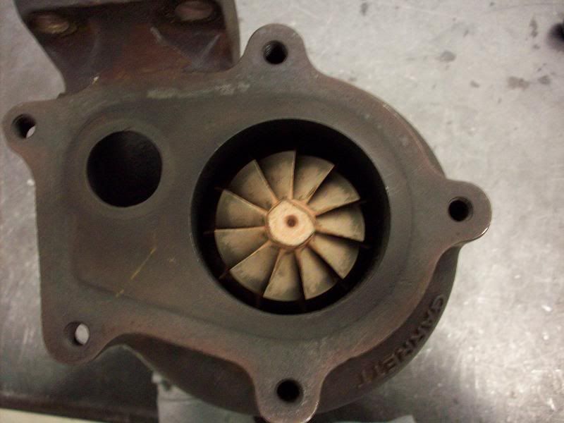

I just looked up there "57 trim" It have some wierd .70 a/r comp housing and a damn stg1 turbine wheel. If this is what you have then that would explain surging i would assume. that is a very small wheel for such a large compressor/housing.
this is a stg1 wheel in a stg3 housing (not centered)
That might be your problem. If it dosent have enugh seet pressure that when you are at wot, the air in the charge pipe is blowing it open and bleading off air, and then it closes and buids back up and then opens. Like a fluttering. Like compressor surge. Since it is adjutable you should crank it down and make a shit ton of seat pressure and see if its holding the 20 psi in the pipes. Or pull your charge pipe off and pressurise the charge pipe and see if its blowing open your bov.
My turbine housing had a small crack in it, so I tried another housing (stg 3) and it looked exactly like the picture, because I do only have a stg 1 turbine wheel, the new turbo has a stg 3 turbine wheel so I guess we will see if it helps. I will still get the measurements off the wheels and post them up, but I wont be back home to do so until tomorrow at the earliest.

what spring do you have in your bov? I know that the tial have different rating spring depending on how much boost you are gona run.
ifly87
  • Posts: 294
Re: Fluttering in boost, cant seem to stop it
« Reply #57 on: April 03, 2010, 04:48:32 PM »
It is seating fine, it was doing the same thing with the HKS BOV I had on it before. I cant wait to fire it up with this new turbocharger, I have a strong hankerin it was the problem.
That I do not know, but it is tight with no pressure behind it, even with the engine at idle it is still not open but moves easily. At low boost (under 5psi) the BOV does not open, and I am fine with that because I have a 14psi spring in the WG anyway. It opens when I shift or let off the throttle when the boost is up. This BOV really appears to be a quality unit I really think its operating correctly and my issue does not lie with this.
I believe the Tial BOV's springs are chosen based on idle vacuum rather than boost level being run.
To the OP, is there anything else tapped into the line that runs to the BOV? If pressure is bleeding off to the BOV diaphram it will blow open at WOT and higher boost.  The pressure is most of what holds it shut under boost rather than the spring.
DING DING DING, we have a winner.
if you have a stg1 turbine with a 57 trim compressor with a LARGE .70 a/r houisng that asking for surge. the large housing allows the turbo to spool up faster then normal and the stg1 turbine is tiny and not matched to the compressor wheel.
if i would guess the turbo just spools up to fast and stalls the comp wheel.  :yes:
