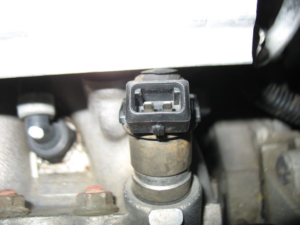

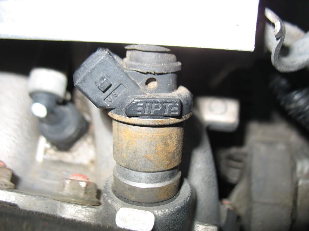

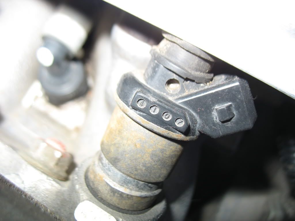

what injectorators are these
« Reply #13 on: April 13, 2010, 08:53:02 PM »
i swapped the injectorator wires to every possible combination, only gets worse when i did that.
car idles perfect, starts perfect but backfires through intake when revved fast.
new plugs were soaked in gas and totally covered in soot. only thing left is these injectors, im pretty sure the intake manifold is off an A6 but the injectors are high impedance, A6 should be low imp.
what are these?
Re: mpfi swap problem
« Reply #14 on: April 13, 2010, 08:57:54 PM »
show where they plug in FOOL

« Reply #22 on: April 14, 2010, 01:26:35 PM »
I yanked one of the injectors off my spare D15B7 mani and they look exactly like the ones you posted. Same markings, same plug, even the number is almost the same (4106 on mine though).
What's with selling A6 manifolds with the wrong gen injectorators...When I got mine it ended up having OBD2 injectors on it  :?:

yes they are swapped, i will try switching them back tonight but im positive they are right.
well with the ones in this manifold being high impedence i dont fucking get it. it should run right with hi imp injectorators, right? either that or they test high imp because their fucked up.
Dumb question, but since I didn't see it asked already- you didn't wire in a resistor box, right?
Maybe just try it with some OBD0 injectors and a resistor box
unofficial brokenog
« Reply #25 on: April 14, 2010, 04:13:10 PM »
no as i was wireing up the resistor box i decided to check the resistance of the injectors and the found out they were high.
i will try to get some obd0 injectors but all the yards around here want 20+ per injector
