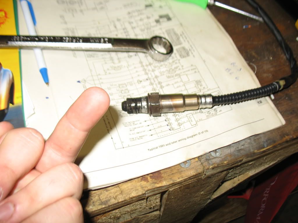

so anyway finally got the car to run on the megasquirt and i get the timing right and everything and the fucking wideband is reading bullshit numbers.
i go to take it out to do a free air calibration and the mother fucker strips, not just the sensor but the bung i had to tig weld into the exhaust while it was on the car.
fucking bosch, when i put the sensor in like a week ago i was able to tread it in by hand and then i just snugged it up with a wrench.
cant trust those fucking germans for nothing, should have went with a ngk or a JAW
SQ is the SQUAD
  • Posts: 2274
Re: lc1 ques
« Reply #17 on: May 26, 2010, 08:28:24 PM »
that sometimes happens is its not tight enough, it vibrates out/strips the sensor. the good thing is that autozone/advance auto carries the replacement bosch sensors
Re: lc1 ques
« Reply #18 on: May 26, 2010, 08:39:17 PM »
The problem isn't the Germans... its you're a moron...lol.the ngk and jaws are both garbage. But at the end of the day if you fail at r and r ing the sensor its really your fault anyways.
