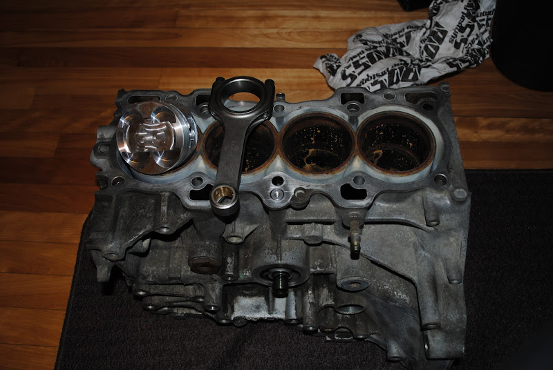

Fuck you,
I'll present you my next setup. If everything is going well it should be built and running by June 25th.
I'll be using the same setup I actually have in my car, but with a built motor... I'm looking for 250hp. ;)
Car:
Integra 92 2drs
LS head:
Crower spring
Crower turbo cam
Crower valve retainer kit
Crower SS valve
ARP head studs
Bloc:
LS crank
ROSS forged piston 81.5mm 9.5:1  (thanks Doug?)
Eagle Rods (Thank you Xenocron  :-X lol)

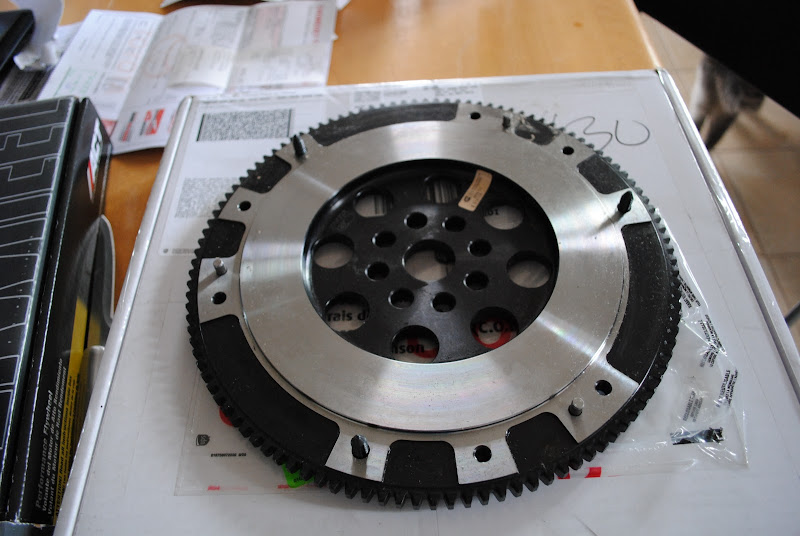

ACT 12.5lbs Flywheel
Other shits:
ACT Xtreme presure plate and 6 pucks disc ( thank you Chris M)
Ported Skunk2 intake manifold (came with the head when I bought it)
PBTuning TB 74mm (Chris M)
2.5" exhaust
Turbo related stuff:
Ramhorn manifold
Precision Turbo SC34 .63/.60
Tial 38mm WG with 15lbs spring
Ching chong BOV (I need to change it...)
Ebay intercooler and piping made for a 94+ integra...
Tuning:
precision 780cc injectors (thank you hotrex)
Chipped OBD1 PR4
Ostrish 1
eCtune (thanks force update)
Innovate LM-1
Motorola 4bar map sensor (if someone want to trade for 3bar, I'm in!)
255lpm xenocron (ching chong?) I don't know if I'll use it or not. I bought it 5 years ago with 310cc injector (WTF??) and chipping kit.
I don't know if I missed something, there's a lot of shit.
Here are the pics cause you didn't read that stuff anyway...
French cat is not amused.

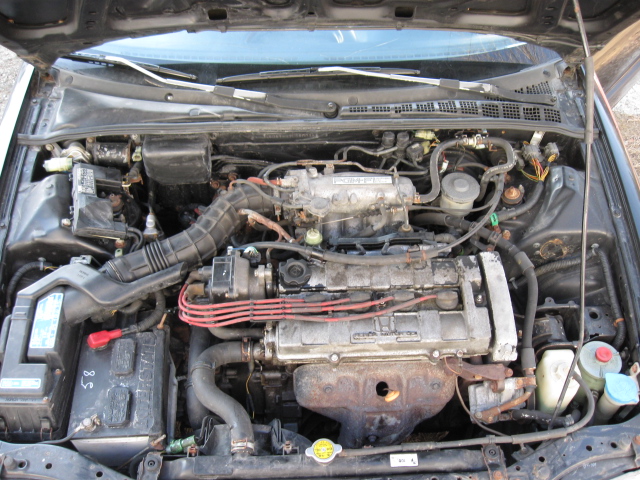

Old stuff:
My car:
Random stuff:
Mini dirt bike
Pontiac Leman (still for sale)
Poutine
Random video:
My slow car:
Integra 92 LS stock internal turbo at 10psi  0 to 190km/h
My slow dad's car @ half throttle (first and last start before winter):
Some fun with the camaro
Camaro 1985 with chevy 454 bigbloc startup
Motor come from this cavalier:
V8 Cavalier Burnout
Seriously, I'm looking for 400hp, but we'll see... I still need crank pulley and flywheel bolt from Chris M that should be shipped by now. I'll send bloc to the machinist to be bored, decked, cleaned, etc. this week or next week and I'm ready to build.

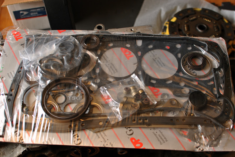

Gasket kit from ebay
Cleaned the room so I can walk to my computer....
I had some problem with shipping so it won't be together before at least 2 weeks...

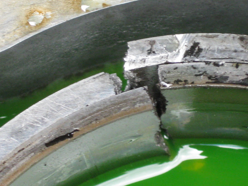

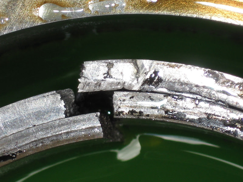

Re: UPDATE: Carnage pics! Near future b18a1 build holy fucking huge pics
« Reply #18 on: June 30, 2010, 03:09:11 PM »

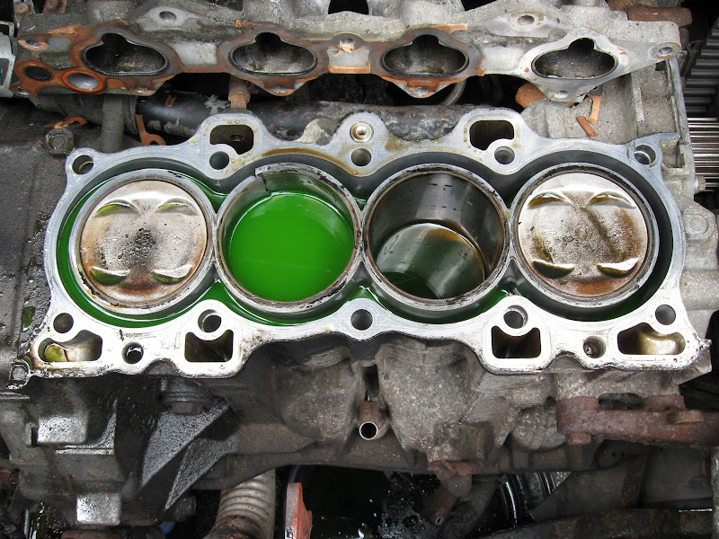

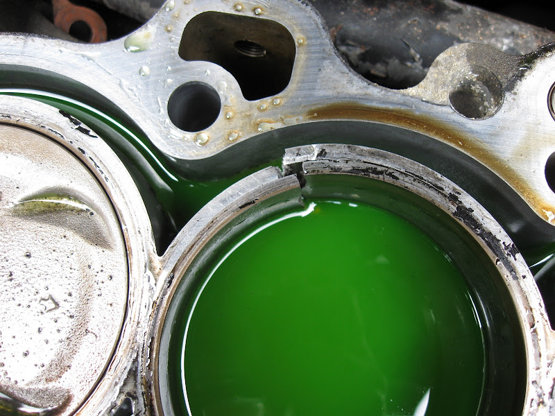

I should have shut the fuck up. The fucker blew up this morning
pics are uploading...
« Last Edit: June 30, 2010, 03:18:40 PM by Teg2boo »

« Reply #21 on: June 30, 2010, 03:23:31 PM »

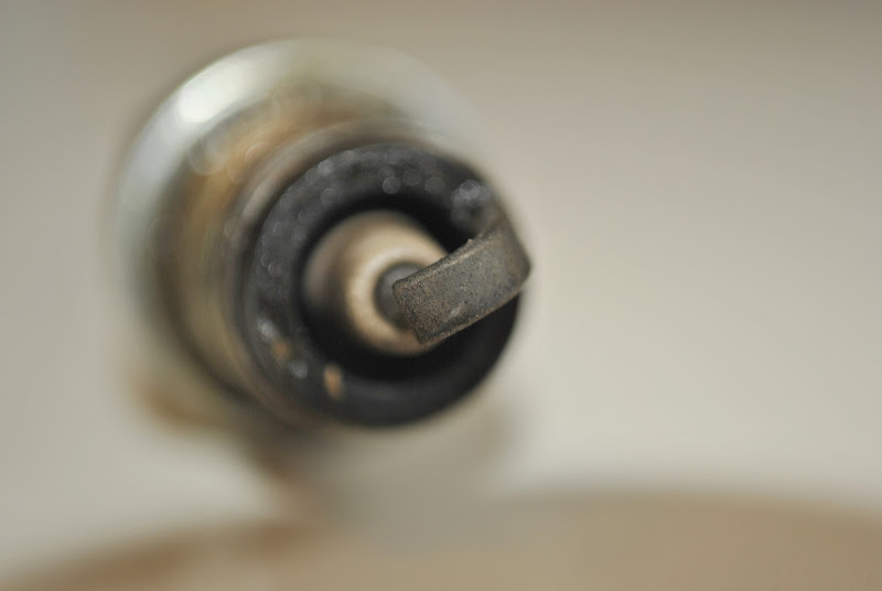

I don't know what happened. The only suspect thing is the sparkplug. I need to take a pic of it.
I know you don't like bloc guard, but don't you think it would have help there?
« Reply #22 on: June 30, 2010, 03:38:51 PM »
Can you get a better picture of the piston faces?  Try not to wipe off any carbon coat, but get as much coolant out of there as you can so I can see what's going on.
« Reply #23 on: June 30, 2010, 03:47:57 PM »
I'll try, but coolant is an excellent carbon remover from what I can see...
« Reply #25 on: June 30, 2010, 04:27:39 PM »
That is a work of art. I love the sleeve split. ;D
But seriously when are you going get this problem fixed?
Are going with another block? or sleeving it?  :-\
Damn this shit sound contagious, who motor is next to blow/break?  :?:
Just remember "if your not breaking part, you are not making any power"  ;D (saw that in a turbo mag once.)

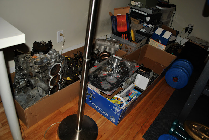

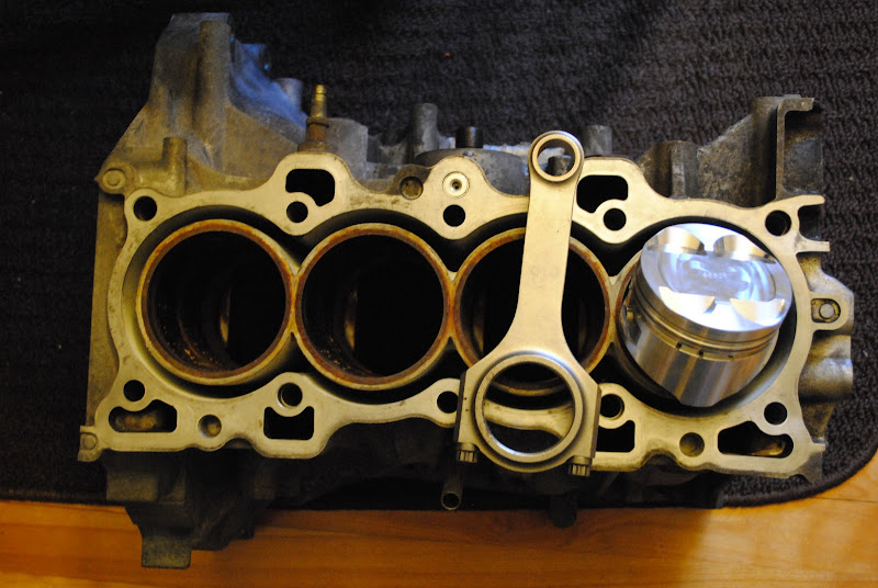

Future plan are in the first pics of this thread. I already have a motor in pieces beside me. I'm not sleeving it, but at the look of the sleeve that broke, I might at least put a bloc guard  :-\
As shown in this pic:
I'm still waiting for the damper from Chris to send my shits to the machinist. For now, I'm just fucked :P
Here are the pics of the pistons and sparkplug:
The black thing is only dirt from when I removed the head
Bad cylinder:
Better I can do with the spark plug..
http://lh4.ggpht.com/_ttHKvikk-8g/TCuxlEmAfFI/AAAAAAAABV0/Wh-4DWjVF6g/s800/CSC_0005.JPG[/img]
« Reply #28 on: June 30, 2010, 05:11:09 PM »
I tried my best! I thought is was only a head gasket until I removed the head LOL
I was at WOT near 150km/h when it happened. I had enough speed to enter in a garage near there without a running motor :?:
The smoke was fucking HUGE! Poor cars behind me on the highway lol
« Reply #29 on: June 30, 2010, 05:18:55 PM »
BTW, for those who don't know, the blown motor is an old stock one, not the "Near future b18a1 build" as the first title said.
The pool has nothing to do with it lol
The motor last 1 year at 10psi, but I think the boost spiked when it blew up...
