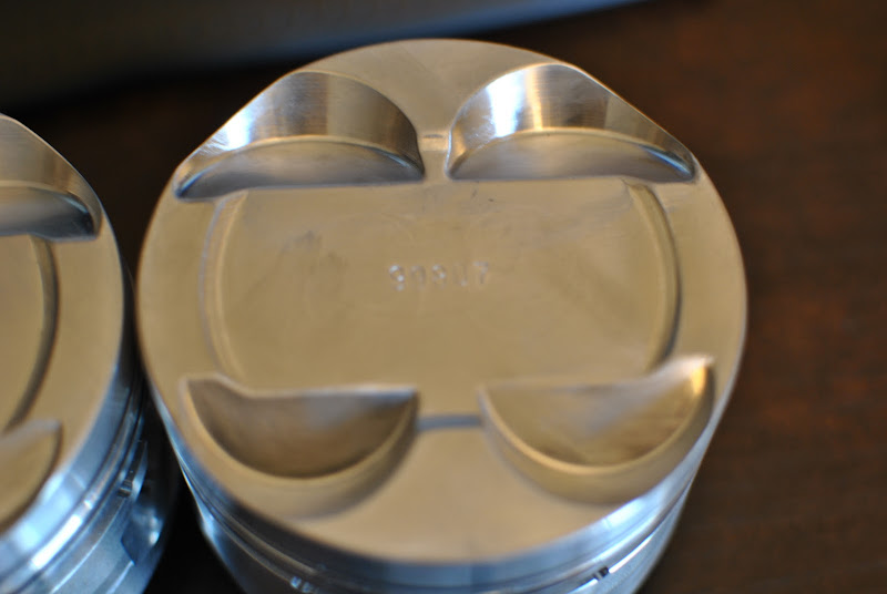

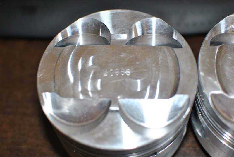

Why the hell are the valve pockets always so goddamn huge on aftermarket pistons?
Oversize valves, fast guide wear in big power (heat) motors causing less than positively located valve faces, then rip off some 800+ whp passes and the valves warp slightly until they cool back down making the situation even worse.
Also, fuck you.
Re: UPDATE: Carnage pics! Near future b18a1 build holy fucking huge pics
« Reply #61 on: July 10, 2010, 11:18:27 PM »
Also, fuck you.
Seems like a lot of wasted real estate for shelf pistons to me.  Maybe this is my ignorance, but how many are actually running 1mm over sized valves or more?  I can't imagine it is a huge percentage.  At the levels that you are talking about, I would think that a customer might be able to afford custom(ish) pistons.
We aren't talking about domestic V8s where .600+" lift and 260+° at 0.050" cams are somewhat common place.
Granted, I have yet to build a Honduh with forged pistons, so I honestly have no clue how tight P2V is on them.
« Reply #62 on: July 10, 2010, 11:36:45 PM »
I'd say 7% of the engines I've tuned had 1+mm oversize valves.  0.5mm over is fairly common, moreso with the all motor crowd.
« Reply #63 on: July 12, 2010, 10:54:24 AM »

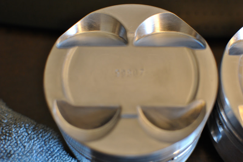

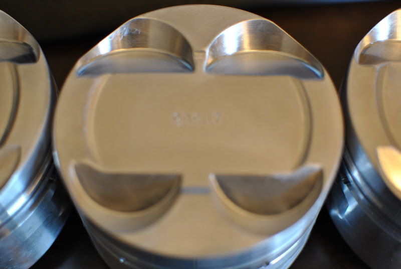

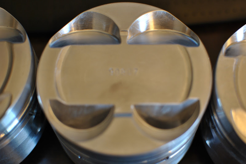

Smoothed pistons edges.
« Reply #64 on: July 12, 2010, 10:57:02 AM »
Cool, now grind down the sharp edges along the valve reliefs.
« Reply #65 on: July 12, 2010, 12:19:14 PM »
You are talking about 1, 2 or 3?
1 and 2 should be smooth enough.
I was  a bit worrying how far I should grind down #3...
« Reply #66 on: July 12, 2010, 07:49:21 PM »

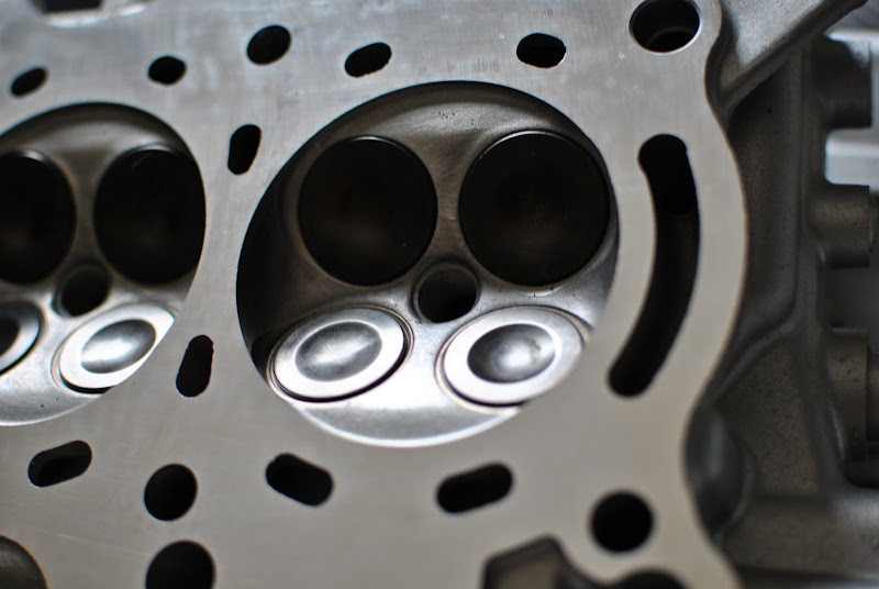

I redid all four pistons.

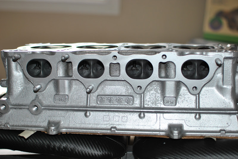

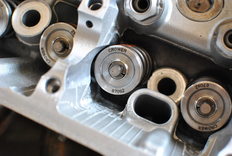

Almost finished port and polish on the head.

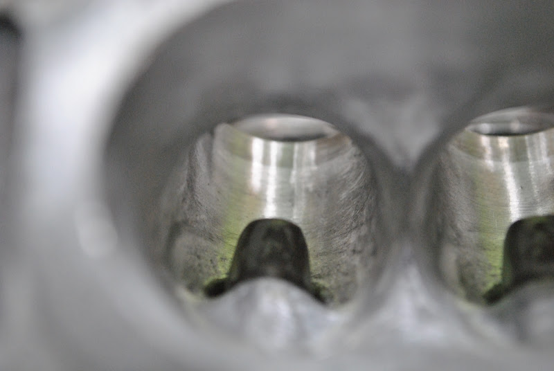

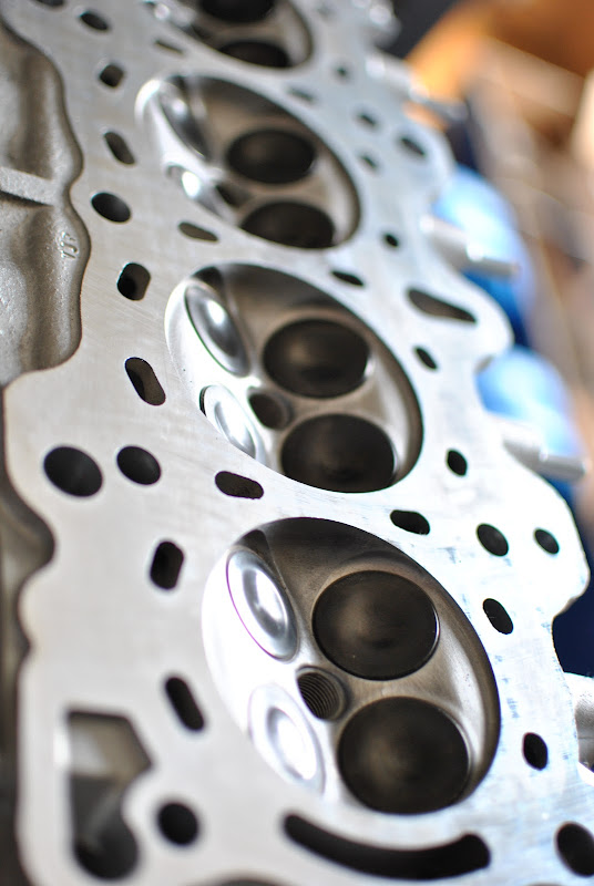

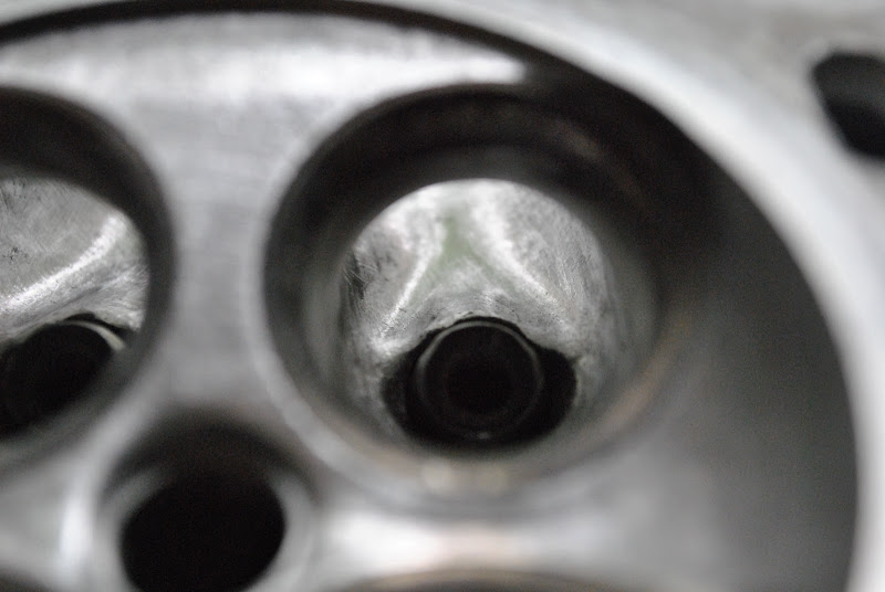

« Reply #67 on: July 13, 2010, 03:01:57 PM »

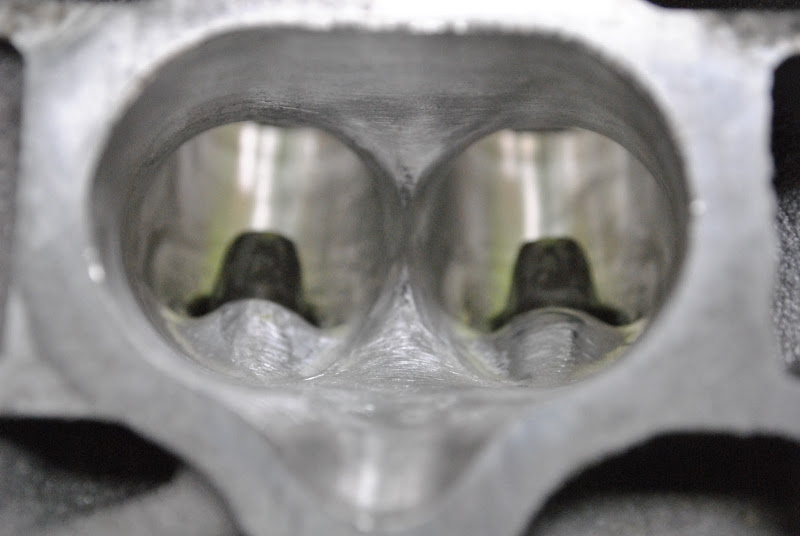

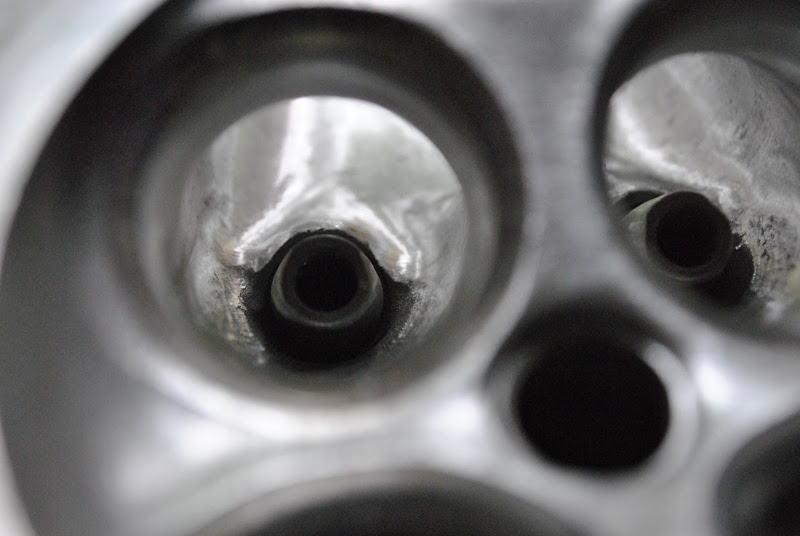

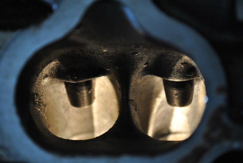

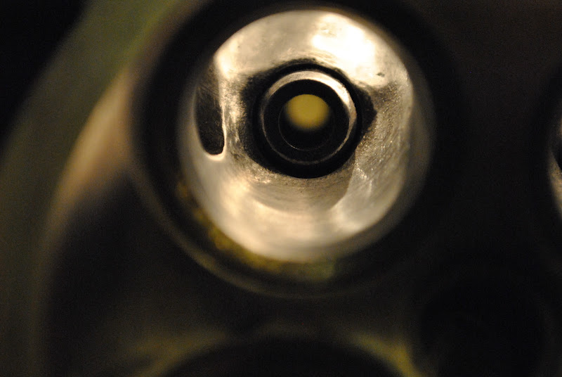

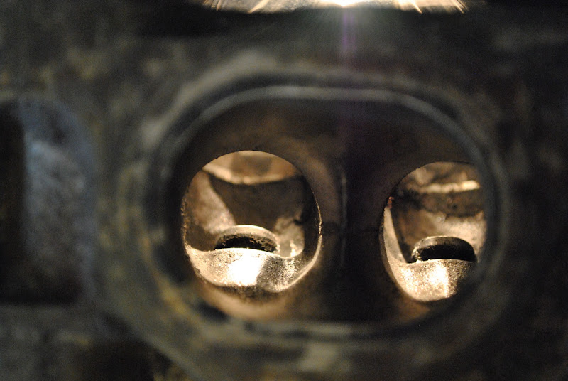

I thought I was almost done with porting, but it's fucking long. I think I loose more time changing tools because they fell apart than porting the head.
Still need to buy 400 grid sand paper to smooth out the exhaust ports and intake bowl. I only had 220, 800 and 1000.
I'm pretty happy with the result tho! I can't do better than that around the valve guide... The rest will be done by hand.
Exhaust side
Intake side
« Last Edit: July 13, 2010, 03:11:37 PM by Teg2boo »

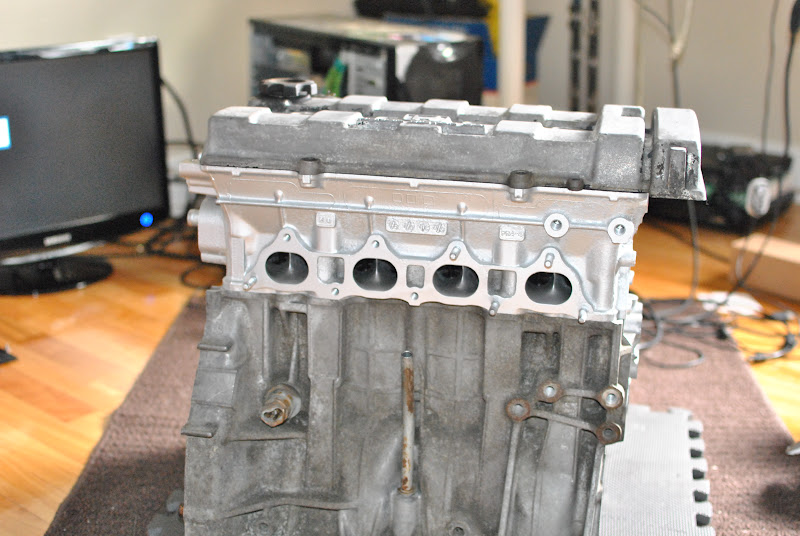

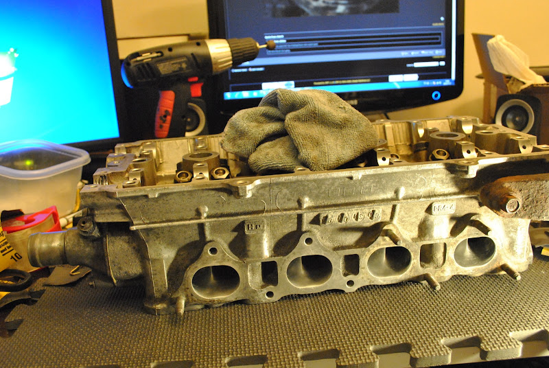

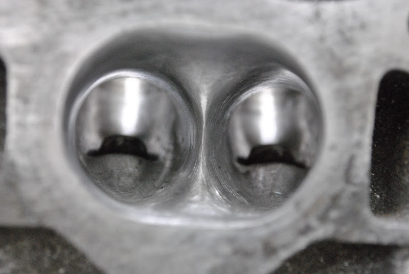

Before all that fucking work:
« Reply #69 on: July 13, 2010, 11:32:39 PM »
Is this the first head you've ported?  I'd have taken the intake divider a bit further - that is, if I had the manual dexterity for porting, which I don't.  All in all, doesn't look bad.
« Reply #70 on: July 14, 2010, 08:12:43 AM »

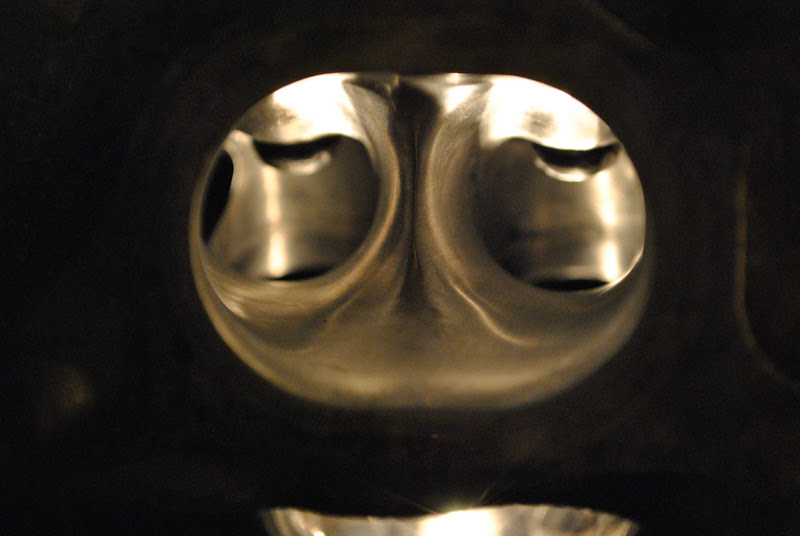

Yeah, it's the ported head. PR4Y. I might remove a bit more from the divider later. I had to finish most of the work today cause I'm sending it to the machinist.
Here is the final result on the exhaust side (intake is mostly the same as pictured above I just polished the bowl):
How I work:
« Reply #71 on: July 14, 2010, 10:58:52 AM »
Honestly, for a street car it's going to rip as is.  If you really feel like doing more work, or want to port more heads, I'd thin the divider more where it joins the top and especially the bottom of the port.  You aren't increasing the crossectional area by doing this but instead are making the entry into the bowls not be such a sudden transition to bottlenecking.  This helps the flow increase in speed as it *flows* past the valve on the intake stroke, instead of making the piston on it's downstroke struggle to draw air down the port.  Well, it still does that just not as bad.
« Reply #72 on: July 14, 2010, 11:23:30 AM »
Ok cool! Noted for future build.
I don't think I'm gonna work on this head anymore...

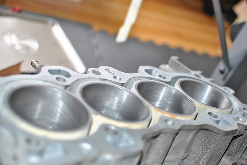

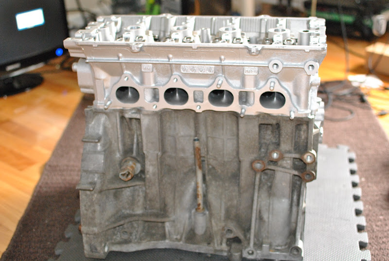

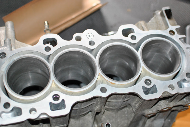

I got the parts back from the machinist yesterday. Again, a lot of photos... I will paint the front of the block like the head (machinist painted the head). I don't think the back of the block worth my time...

Block guard is not needed. Painting the block  :?:
Everyone paint their block... I don't know where you live...
