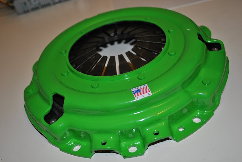

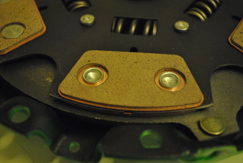

« Reply #125 on: August 27, 2010, 01:45:28 AM »

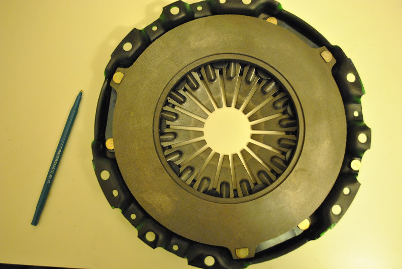

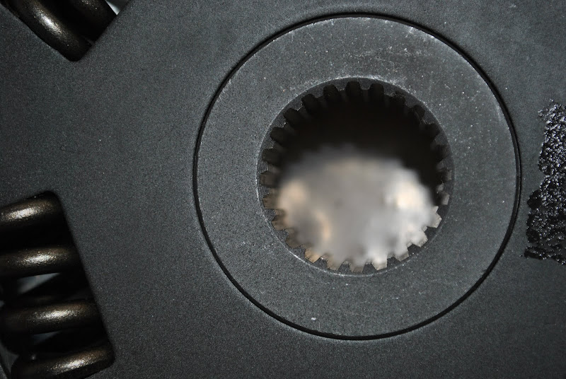

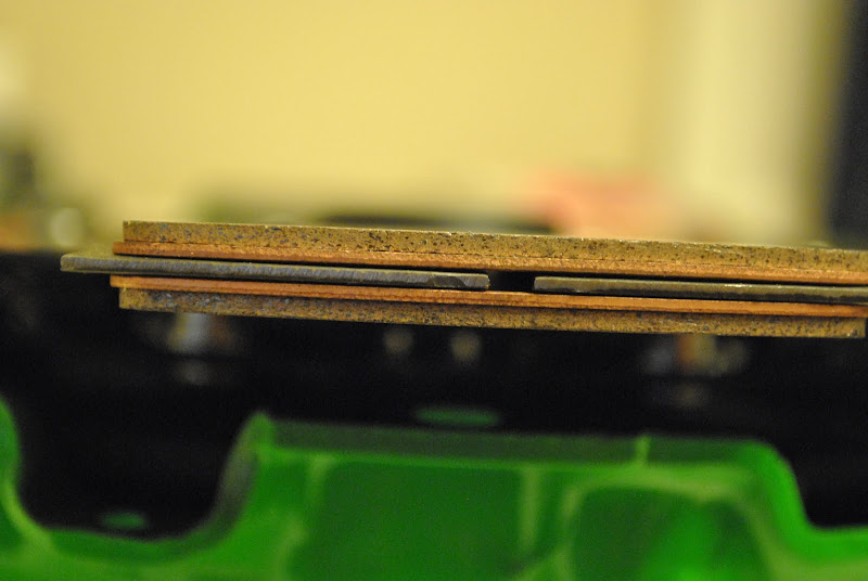

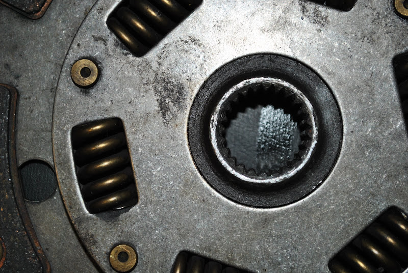

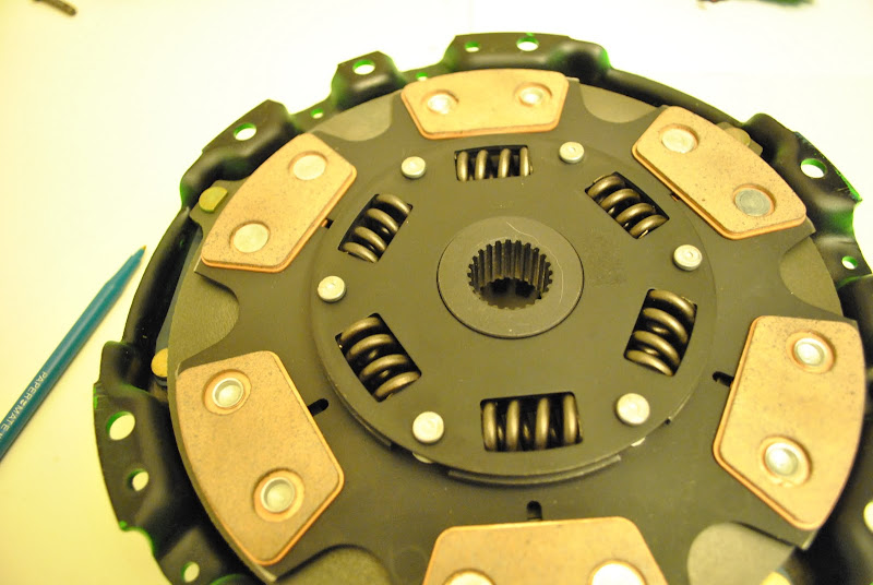

Received my clutch kit from LSD today.
Looking very good!
Difference between shaft spline.
90-91
92-93
New pressure plate
Disc
