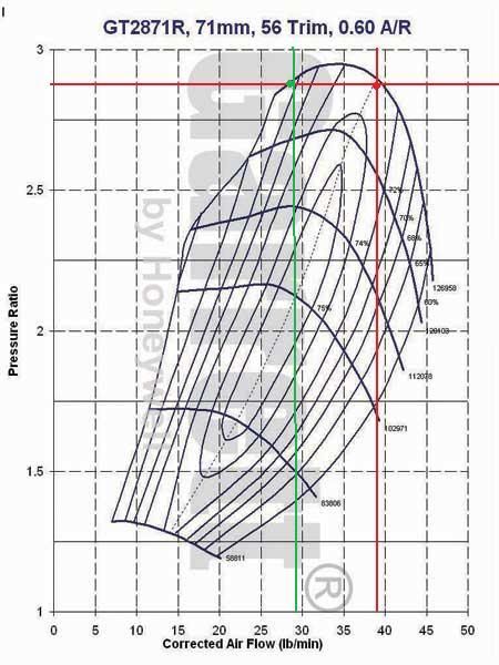

You do see that graph goes over to 45lbs/min right?
http://www.turbobygarrett.com/turbobygarrett/catelog/Turbochargers/GT28/GT2871R_743347_2.htm
hp rating from garrett themselves 280-475 hp, now to hit that you will be at a higher pr then a larger engine, but flow is flow no matter what pressures your at. a turbo doesn't flow more or less depending on the engine it's attached to. Now to hit the high side of that comp graph you would need the larger turbine to get as much flow from the turbine as you can.
those cars that are "peaking at 25-26psi" must have small turbine and that the only thing holding that comp wheel back from making the rated output that garrett says it will.

100whp = 10lb/min, roughly.  It's a rule of thumb that is typically pretty accurate.
So in order to make 320whp, at minimum, you should be looking for a turbo that can flow 32 lb/min.  To be on the safe side, you should really find something that can flow 35-37lb/min.
Looking at that compressor map, you clearly can see the turbo is capable of flowing that amount with ease.  The GT2871r is not a favorite of a lot of people because it's a bit out of balance because it is completely turbine limited.  Some guys like them, a lot do not.

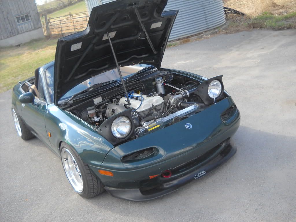

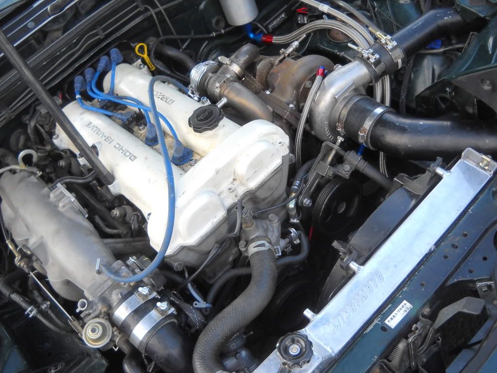

also, the setup in question.
