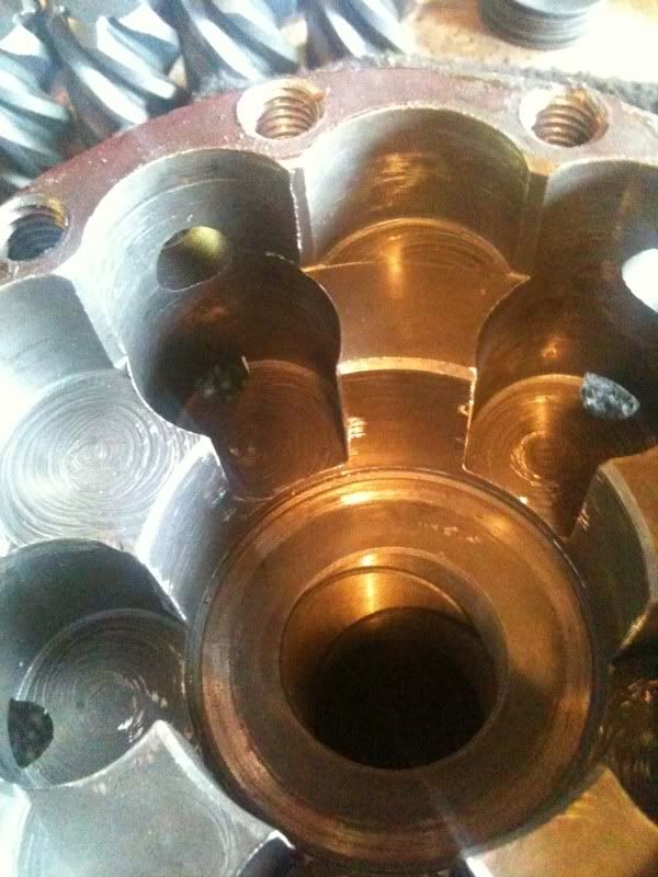

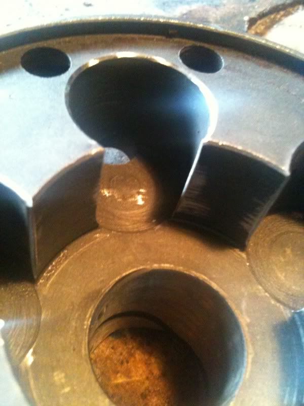

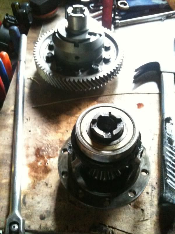

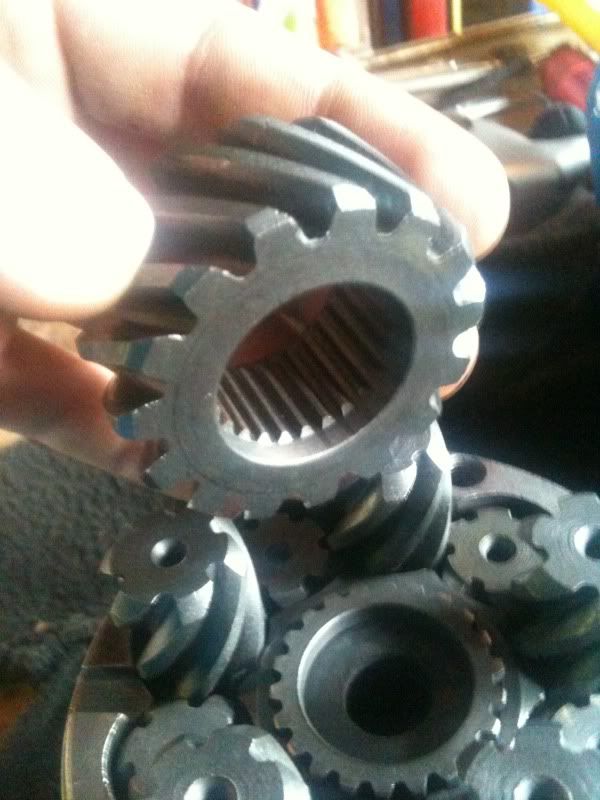

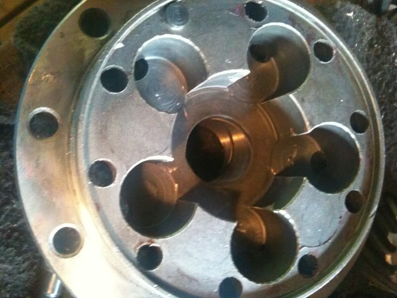

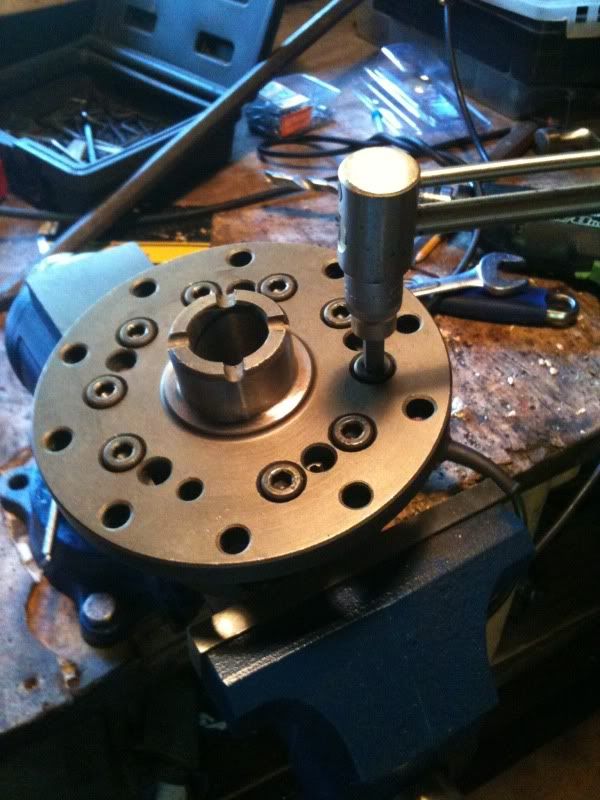

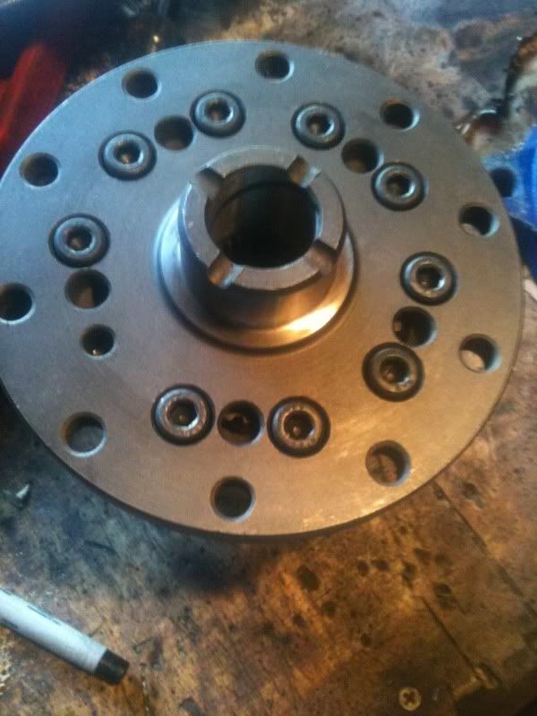

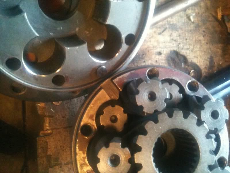

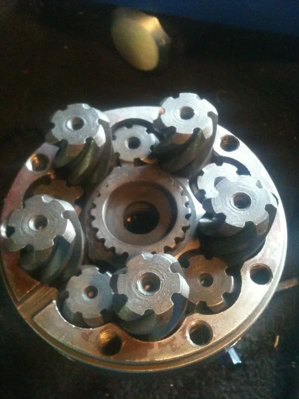

1-Dissemble the LSD 9 bolts holding the top, and remove the guts! try and keep it organized but it only goes back one way if you think about it logically

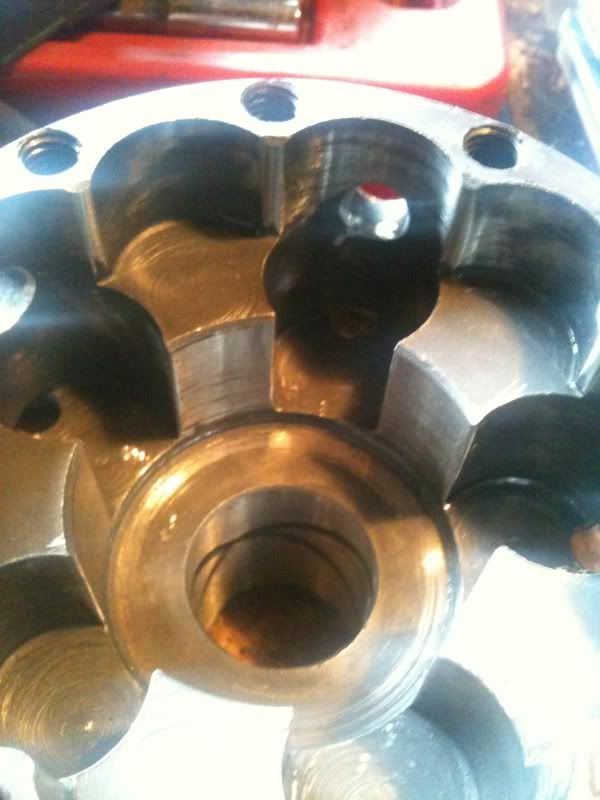

here is the stock lower and upper case, its in pretty rough shape from china
2- bust out your dremell with a 60 grit sanding wheel and smooth out the edges and potential pieces that may break off and float around in the tranny
 * I smoothed the insides and the chamfers a bit and cleaned the cases from dust
3- The lower axle or "sun" gear is the taller one

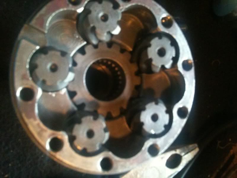

put it into the lower case chamfored side DOWN, just think the axle has to slide in so it makes it easier :D

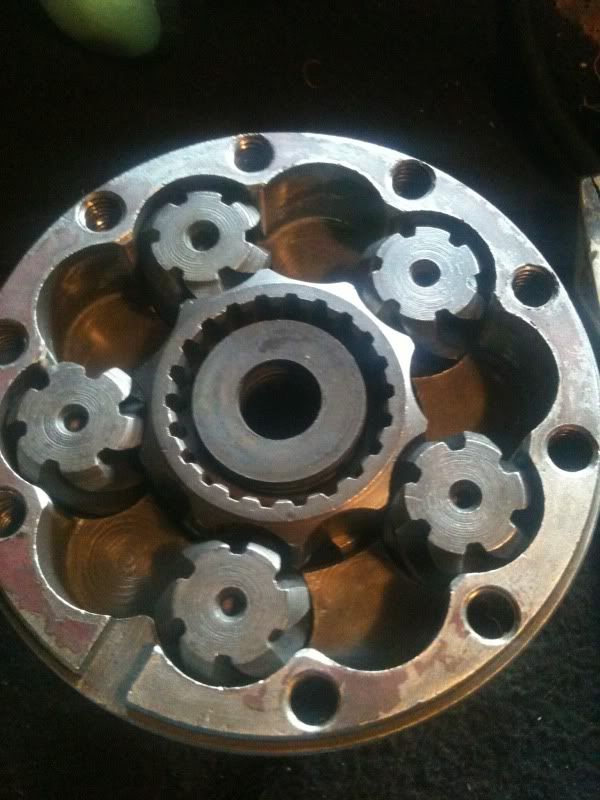

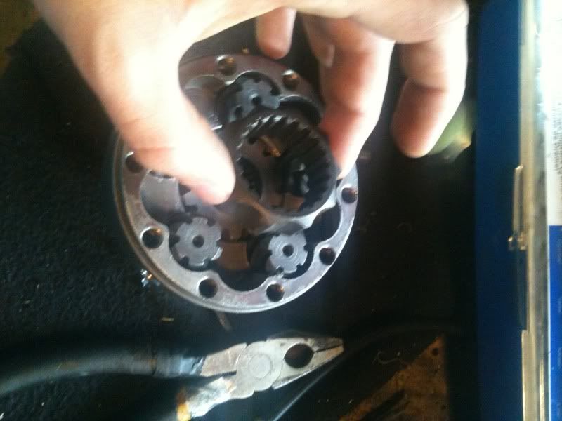

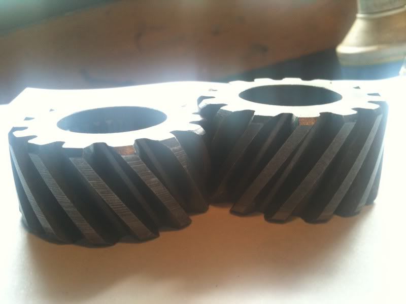

4-next come the 5 outer or "planetary" gears, if you mixed them up dont worry 5 are cut one direction and 5 the opposite, only the correct 5 will fit
5-Lower in the center gear that retains the washers

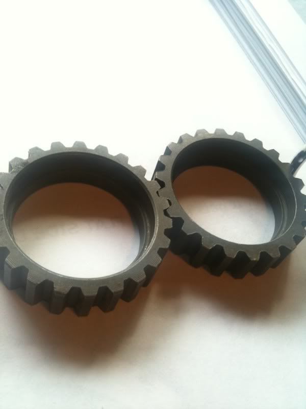

6- The two washer retaining gears were identical upper and lower on this LSD, install the lower one with the flat side DOWN and the notches side UP so they can retain the washers in the center

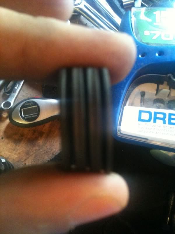

7- the washer order I went with )()()(
8-center them up using whatever you have around that the same diamater, my 1/2 extension worked

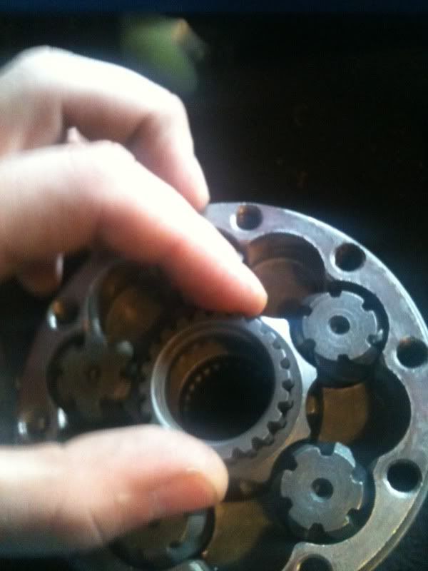

9-put on the upper washer retaining gear on above the washers with the notch DOWN and the flat side UP, also add the remaining outer planetary gears
10-the other axle gear (shorter one) chamfored side UP and notched DOWN
11-line up the upper case half like so
12-tighten the upper case hand tight in a star pattern
13- TQ to 35ft/lbs
14- PRAY for good runout and case fit :D
LMK what you nogs think

I would have chased all the bolt holes with a tap too. Lmk how this works out for you. Chuck it up in a path to check your run out, or put it in 1/2 of a grand case with a bearing and check runout.

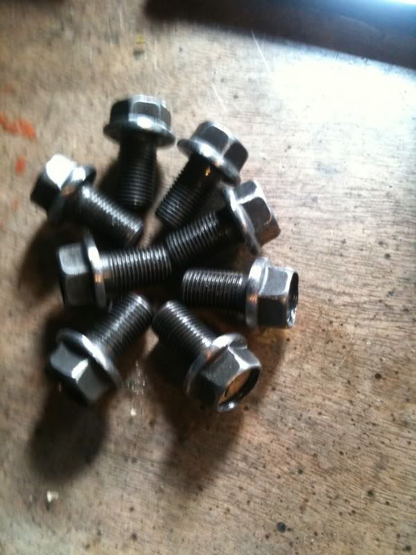

ground the bolts down so they fit :P

also the bolt holes SUCK on the obx as expected. but strange thing is I would put the bolt in from the back just to make sure the threads are clean and it would go in easy, but from the front they are much harder to put it

Not to seem disrespectful to the time/effort you put into the thread, but the machining looks like shit on those things.
I'll save my money for a Quaife.

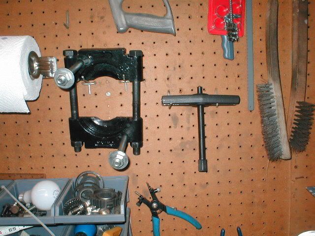

bone any recomendations on removing/reusing the bearings? or should i just spend the 70 bucks and get new ones on the diff?
this should work i think
what size separator/ setup you recommend?

Socket + adapter sits on the axle tube. I have a 3 jaw puller for the ring gear side bearing.
