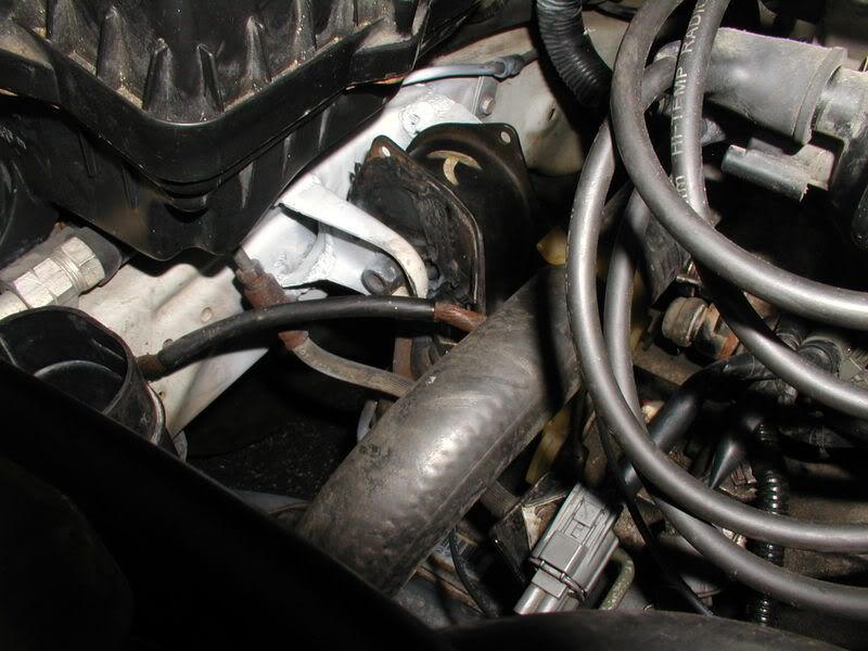

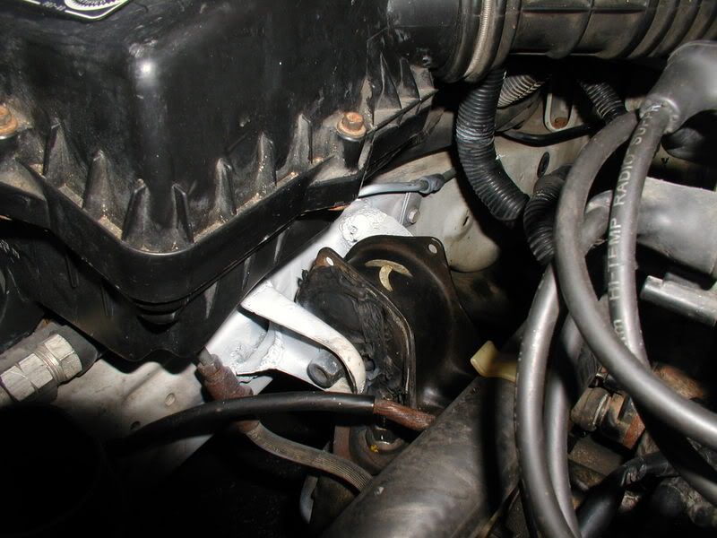

Does anyone have the part number to the trans bracket that goes on the frame rail? I look and this is all I can find; http://www.hondaautomotiveparts.com/auto/jsp/mws/prddisplay.jsp?inputstate=5&catcgry1=CIVIC&catcgry2=1995&catcgry3=3DR+SI&catcgry4=KA5MT&catcgry5=ENGINE+MOUNT+%281%29

Nope the one that goes around #4, its tack weld to the frame. The Auto one points up, the 5spd one is straight.

« Reply #8 on: July 04, 2010, 10:37:18 PM »
this conversion didn't cost me anything but a few mm on the cut off wheel and a few 6011 rods.  no special bracket needed.  i did drill the spot welds and take the entire bracket off to do the modifications, then weld it back on.  'measured' with the eyeball and installed just fine
