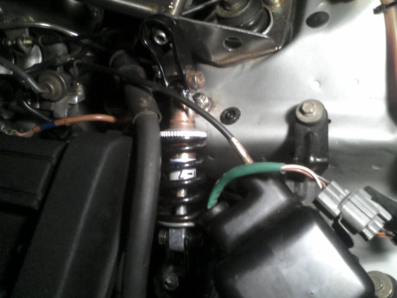

I haven't made one of these yet, but it seems really easy so I probably will so I can eliminate the front motor mount to make room for future turbo/downpipe.
http://www.team-integra.net/forum/display_topic_threads.asp?ForumID=15&TopicID=224861&SearchPagePosition=1&search=98_gsr&searchMode=&searchIn=Author&forum=15&searchSort=dateDESC&ReturnPage=Search
Basically using a cheap rear coilover shock from a mountain bike as an engine torque damper.
What I think is pretty cool is that the threaded sleeve would allow you to have some preload to stiffen things up.

Fox shock on Ebay is like $10 for a 650 Lb / in unit.  These won't function the same was as they do in a mountian bike, the operating range is much smaller , esp. when combined with stiffer engine mounts.
Not sure which method to try now.
