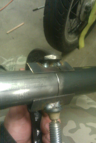

im sure someone on here has made one of these before, but just in case heres a thing i made out of shit layin around
took a cheap 4" c clamp and tried to wire wheel as much of the already half burned up from welding coating off the one side and hit the little pivot deal too, cut 2 pieces off some angle i had and welded .  works good for tacking pipes together instead of tape or magnets sometimes

« Reply #1 on: July 18, 2010, 11:13:23 PM »
sweet

« Reply #3 on: July 19, 2010, 07:09:35 AM »
I have been thinking about doing the same thing but with one of those vicegrip style welding clamps.

« Reply #6 on: July 20, 2010, 08:56:48 PM »
Sweet. I was going to buy the Hobart pliers. I'm going murder a C-clamp.

Re: 10 minute tool fab
« Reply #7 on: July 20, 2010, 09:08:07 PM »
Simple and it works.
Nicely done.

« Reply #8 on: July 27, 2010, 09:45:42 PM »
piece of long angle iron in a vice works pretty well to

« Reply #9 on: July 27, 2010, 09:58:05 PM »
Not under a car
« Reply #10 on: July 30, 2010, 04:38:33 PM »
unless youre tigging shit, i dont see the need
