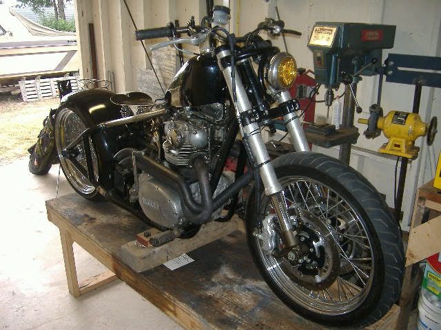

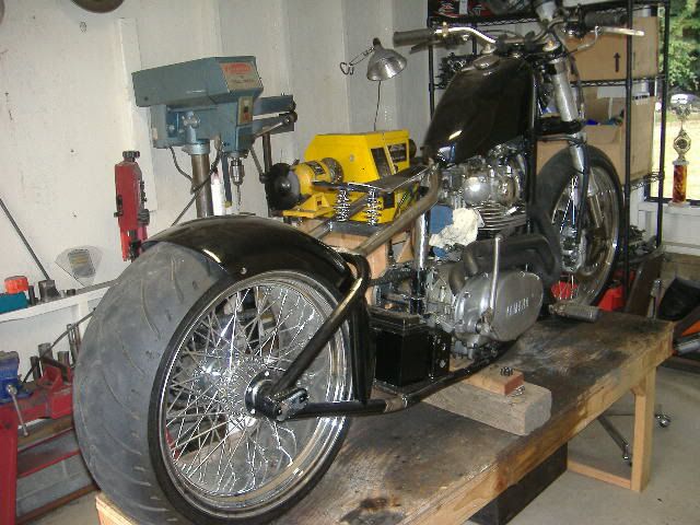

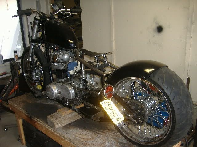

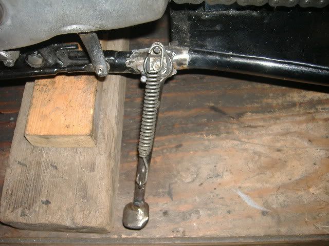

Ok everyone, time for some new photos. Worked a bunch today and got a lot done.
First and most important I got my kickstand setup. It was a bittersweet moment to put a kickstand on this bike :)
Also, since i got pretty much universal hate on my seat choice I went a different way :) I cut down my original seat pan and used that instead. Also I got the headlight mounted and some wiring stuff out of the way. Also I got the chain cut and installed. Basically there's a lot of little stuff left to do. the only real fab left is to make the new fender struts. So here's some pictures of the bike almost finished:
I love my headlight :)
Thanks for looking, and right now it looks like I'm going to make my deadline of riding it by next saturday. Actually I'm hoping to have it finished Thursday night so I can do some shakedown rides before Sat.

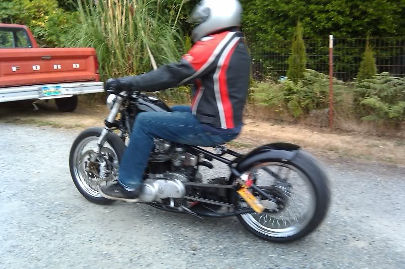

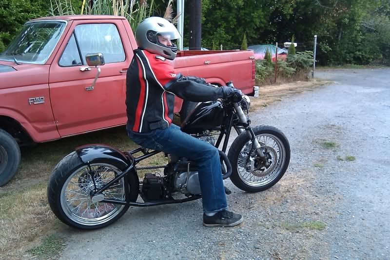

Here's the chronicle from where I last left off. I tossed some spray paint on the bike to cover the bare metal. put the remainder of the bike together and it was having running issues. Found the condenser was not grounded properly, then there was a piece of rubber stuck in the crossover tubes between the carbs. Got the bike together and running properly the Sat. morning that my brother in law showed up.

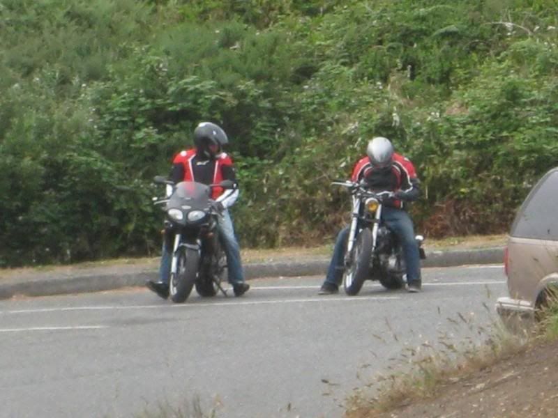

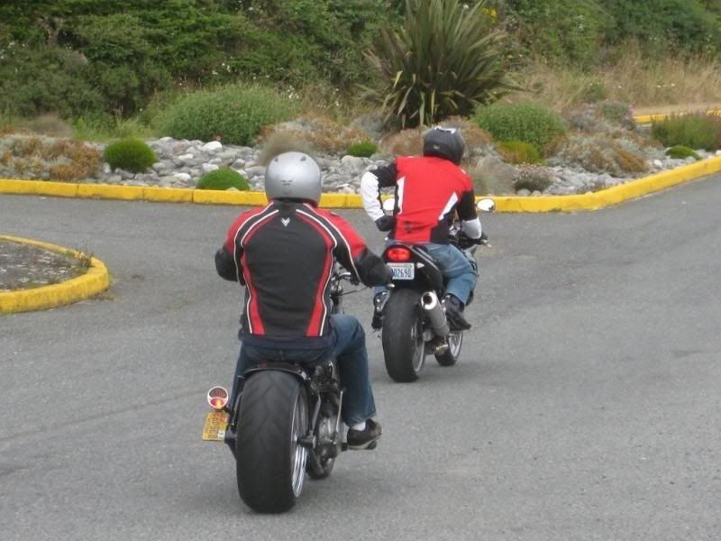

We got to go for a couple rides Sat. here's a few shots of the bike that day.
Sunday I got to go for another ride out the a local golf course to play a round, and about a mile from the course my bike backfired then all the lights went out and it started running on one cylinder again. Fortunately my dad was able to come down and we loaded the bike into the back of my pickup, I said forget it I'll look at it later and played some golf.
When I got time to look at it I found the battery bone dry- checked the charging voltage and it was around 17V! Oops. I never really checked on the battery water level, I think it got completely dried out and shorted everything else out. I got another battery to see if there were any more problems and sure enough it was still running on one cylinder. I pulled the carb back apart on the left side some sort of filing was stuck dead center in my pilot jet. The rest of the carb was spotless. Now the bike starts first kick every single time, even dead cold.
I got a new regulator for the bike, but it's a little bit different style so I had to rewire things a bit. That's where I'm at right now, just finishing up the rewire and put  my new battery in. Should be really ready to ride this weekend. I hope.

i like the new look, but it dont look right when your sitting on it, i think the seat is up to far or somthing.
toyolla86
  • Posts: 289
Re: Chopper rebuild time!
« Reply #43 on: September 07, 2010, 12:44:17 AM »
exactly what i was going to say. the seat is too high up. needs to be moved back a few inches.

« Reply #44 on: September 07, 2010, 02:29:38 AM »
yep the bike is sweet but it looks like the seat is to far forword.

« Reply #45 on: September 07, 2010, 05:04:20 AM »
those sporty or peanut tanks whatever there called are played as shit too, your bike is better then that.  put a real saddle on that horse and make some crazy tank with your fabskillz and that bike would be awesome for a 2nd time
96turboracer
  • Posts: 913
« Reply #46 on: September 08, 2010, 03:20:58 PM »
You know, I built the first version entirely around that tank. But with the new look I hate to say it but I think you're right.
A righteous custom tank would look pimpin on there. Plus I could actually ride more than 60 miles at a time.
Ok new list, make a sick new tank and move the seat back..... It never ends! But I still need to get back on the turbo bike too!

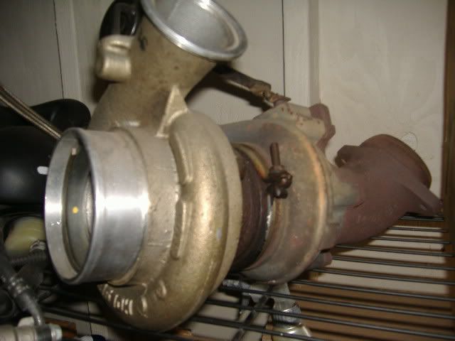

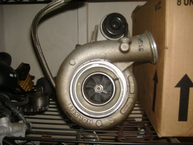

Plus I just picked up this for my truck:
Holset HY-35
 8)
« Reply #47 on: September 08, 2010, 06:52:33 PM »
Holset HY-35
 8)
You nigger!! How much did you get that for? Ive been looking hi and low for one for about a month!
96turboracer
  • Posts: 913
« Reply #48 on: September 08, 2010, 08:26:08 PM »
You're really going to hate me. I work at a Dodge dealership and I picked it up for free.  :P
