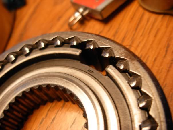

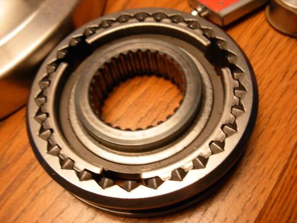

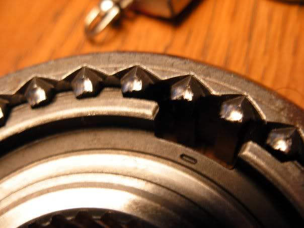

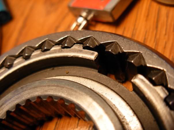

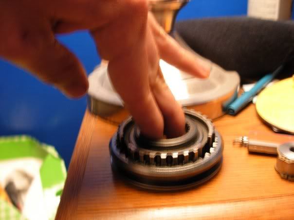

sounds like it could be this
thats what its supposed to look like
thats how its supposed to operate(and what what going into 5th gear looks like)
this is what the other side looks like
and this is how it operates or...doesn't
some how 5th gear got rammed into the slider and bent the teeth over, preventing it from going into 5th. same symptoms as the transmission i pulled that hub/slider out of

failure to debur plus misalignment of the hub and slider.

I suggest running a polishing stone on the end of a dremel for the V are and then a diamond file for the edges of the grooves  :noel:

And Jlude   nice pictures
