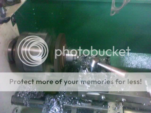

We take this as a starting point and tig some stubs and outputs shafts to the flanges that bolt to them.
Before we do that though we find a big thick stub axle and wheel hub that we can redrill to four bolt and turn down on the lathe to fit into the wheel bearing of whatever we are trying to stick this axle into.
like this.
