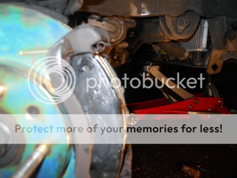

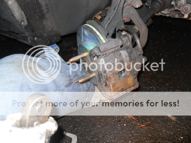

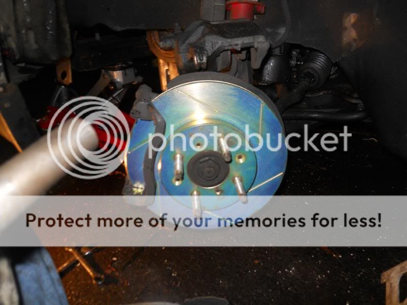

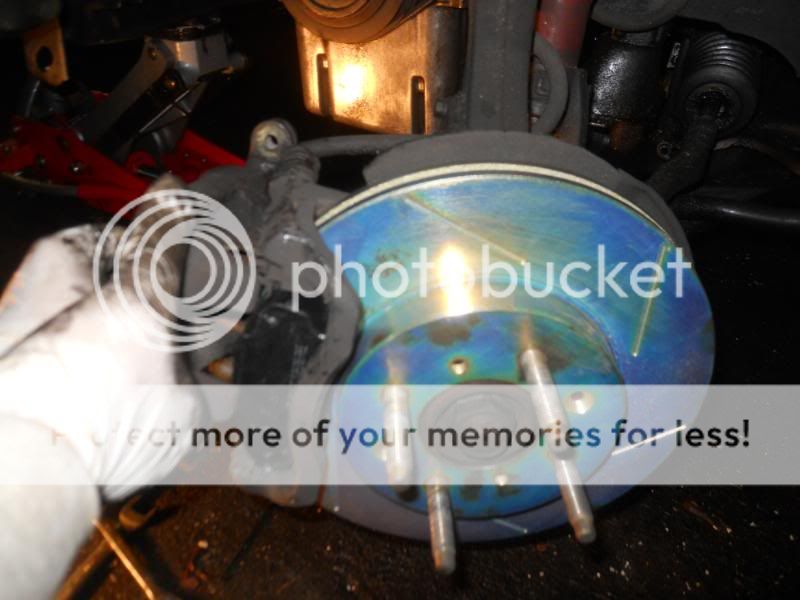

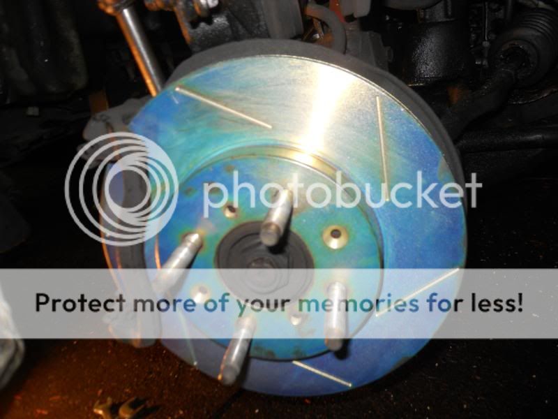

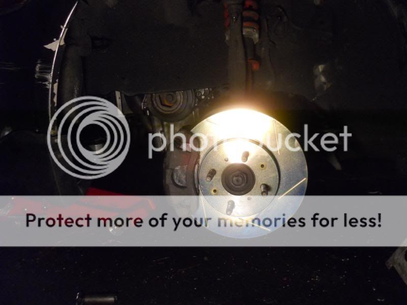

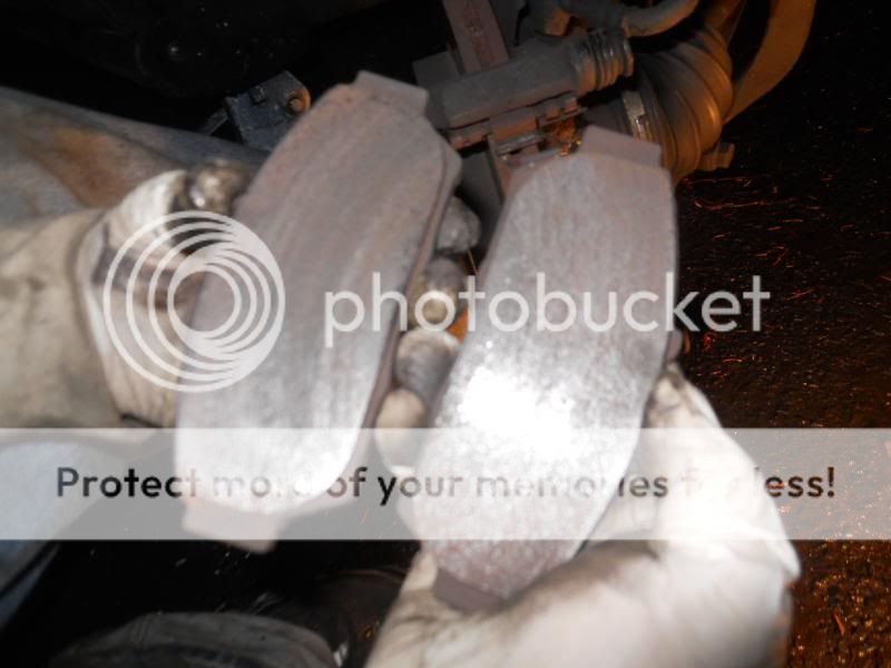

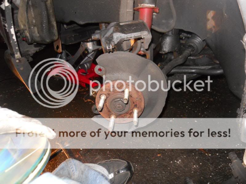

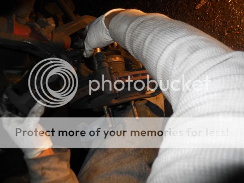

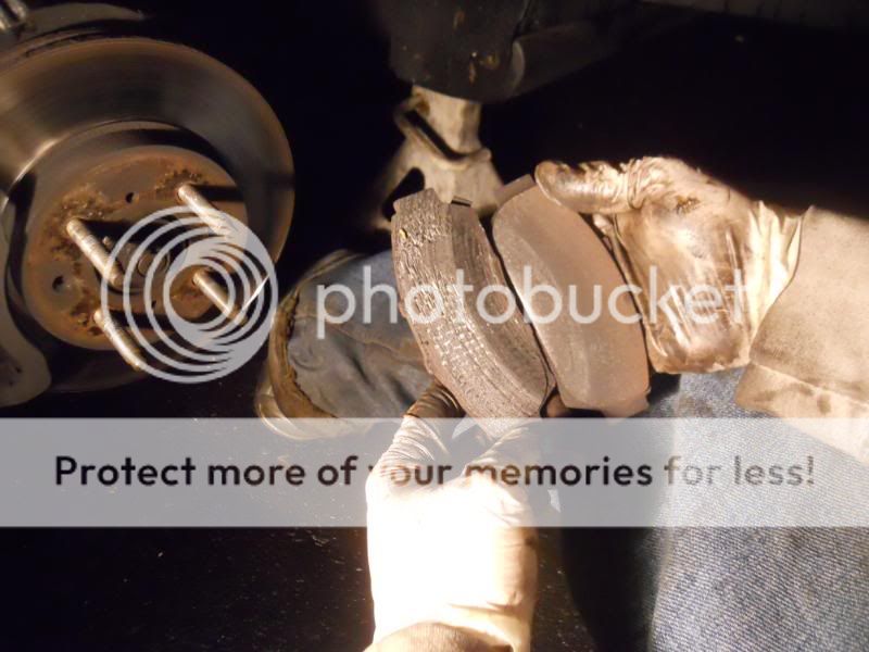

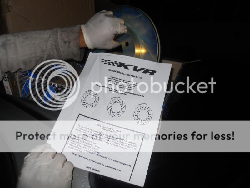

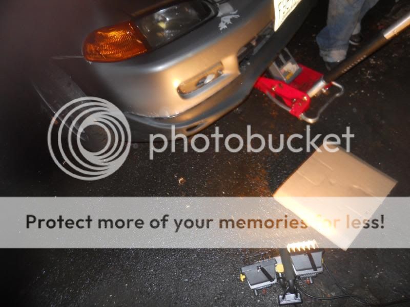

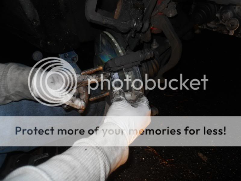

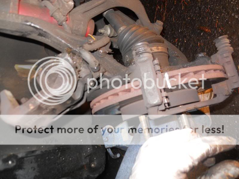

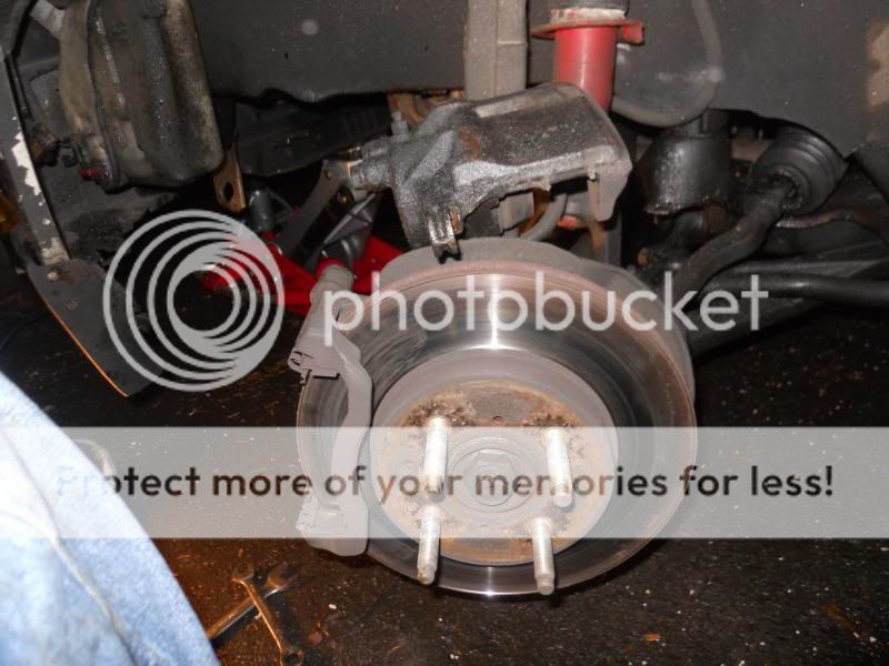

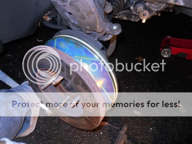

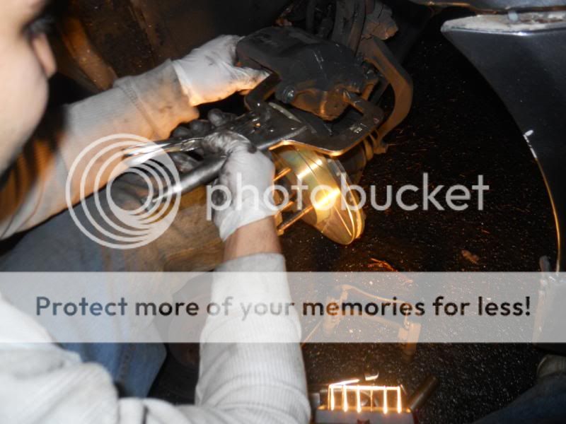

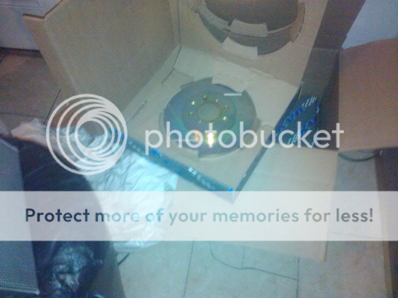

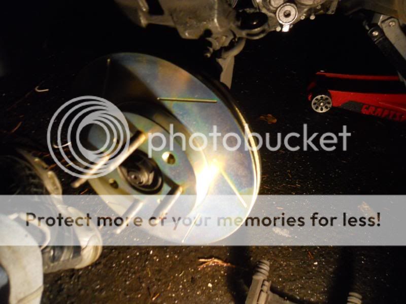

First up before I can boost anything I need new brakes. My old Hawk HP+ pads were great, but after a few stops from over 130 fade would get bad. Also at this point the pads were shot, having been abused for 18,000 miles it was time to change.

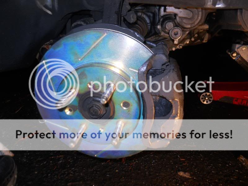

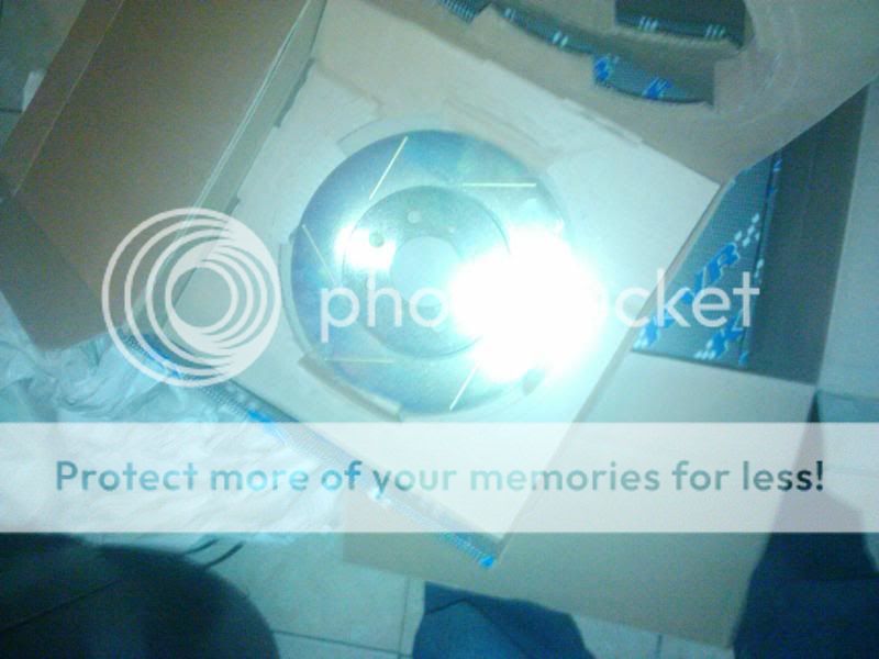

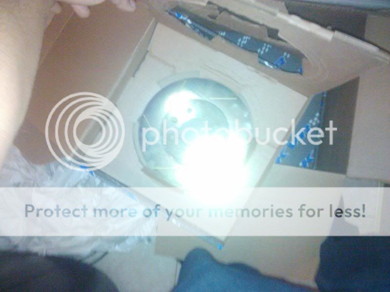

KVR rotors and pads; well onto the pic's!

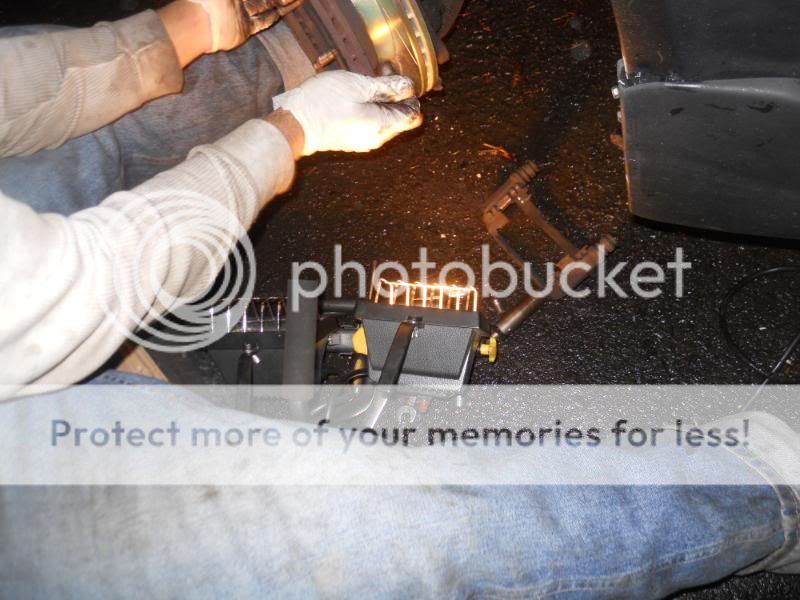

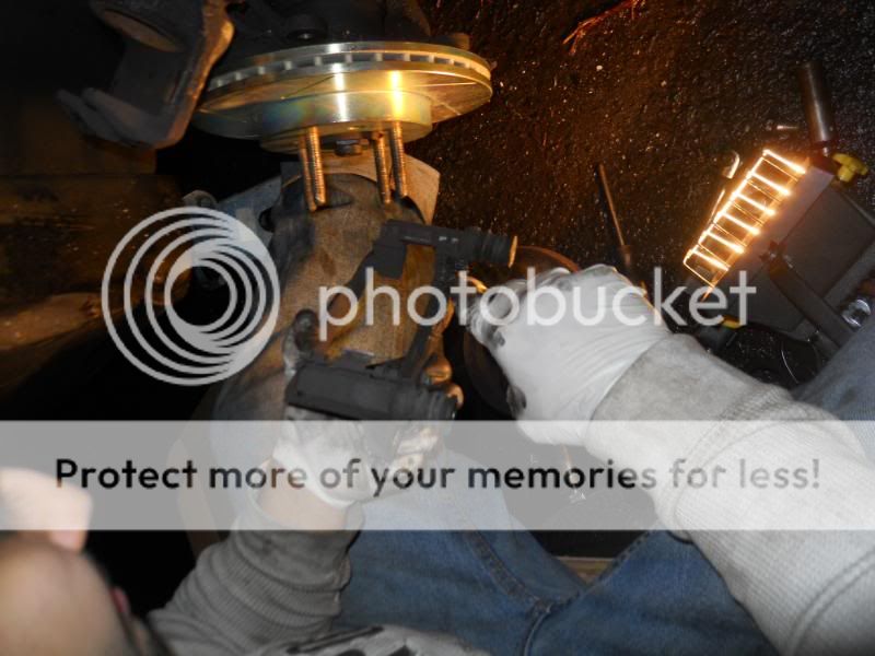

The right way to put slotted rotors on

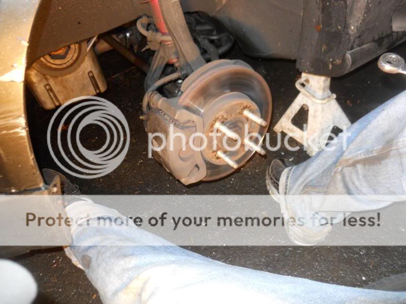

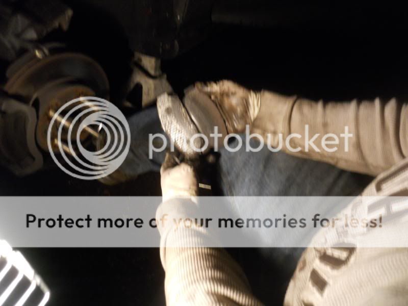

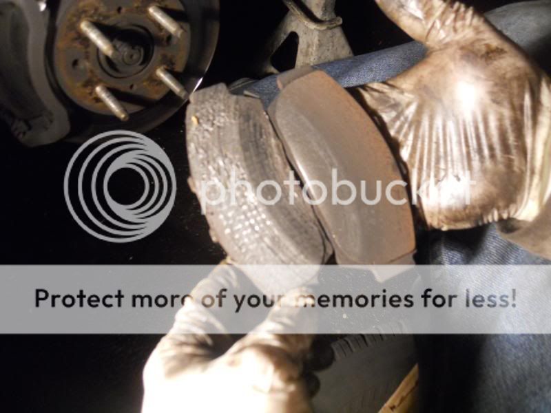

I think the pads were done!
Old VS New

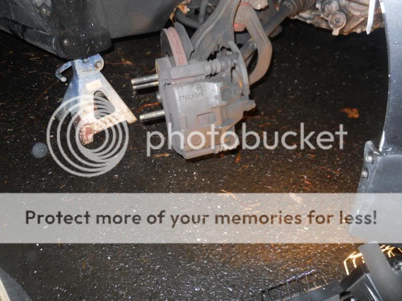

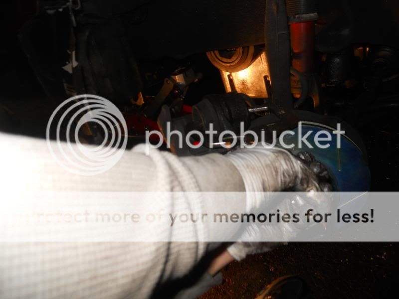

A little grease
Time for the other side.
Now thats the end of that. Brakes stop good, and so far no fad despite how hard I push them :evil:

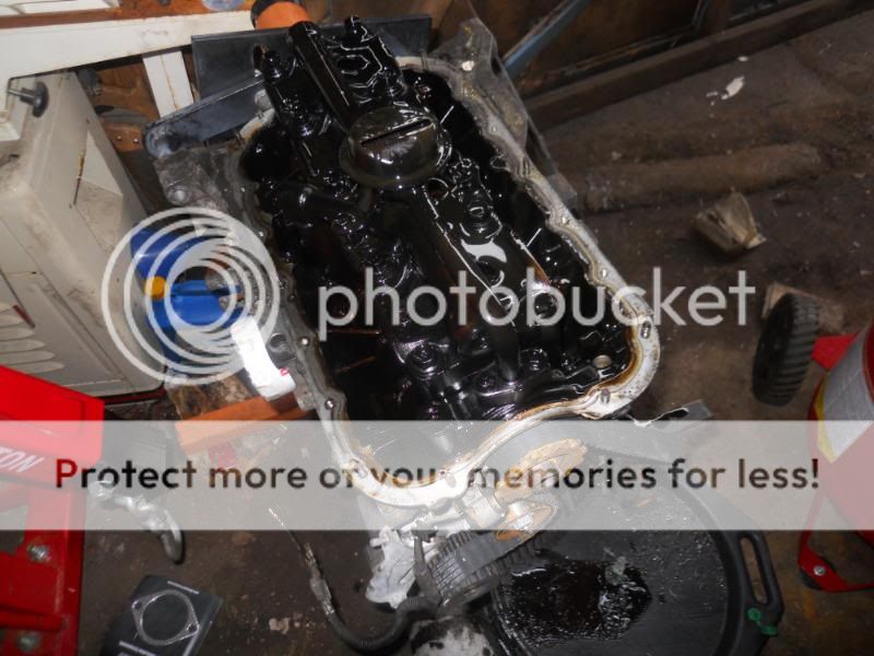

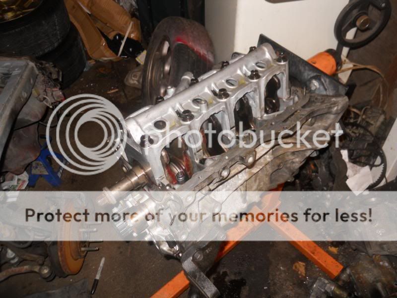

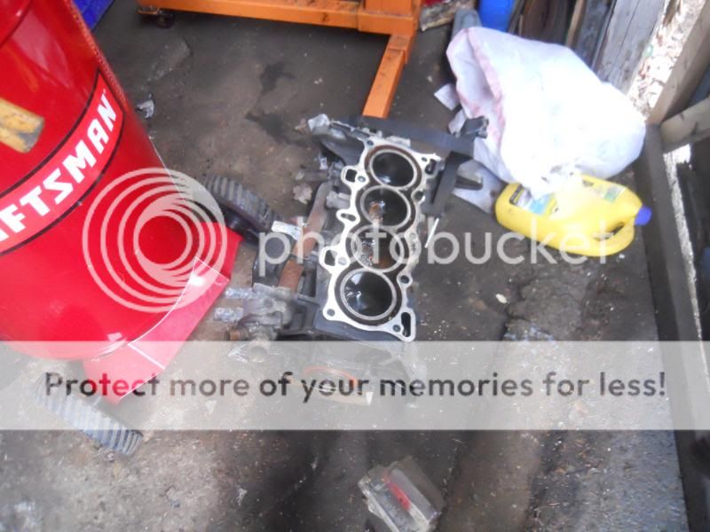

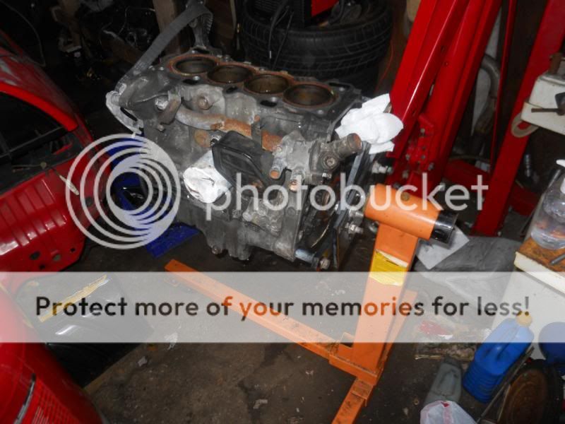

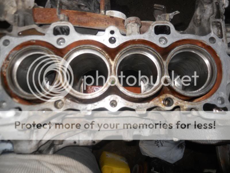

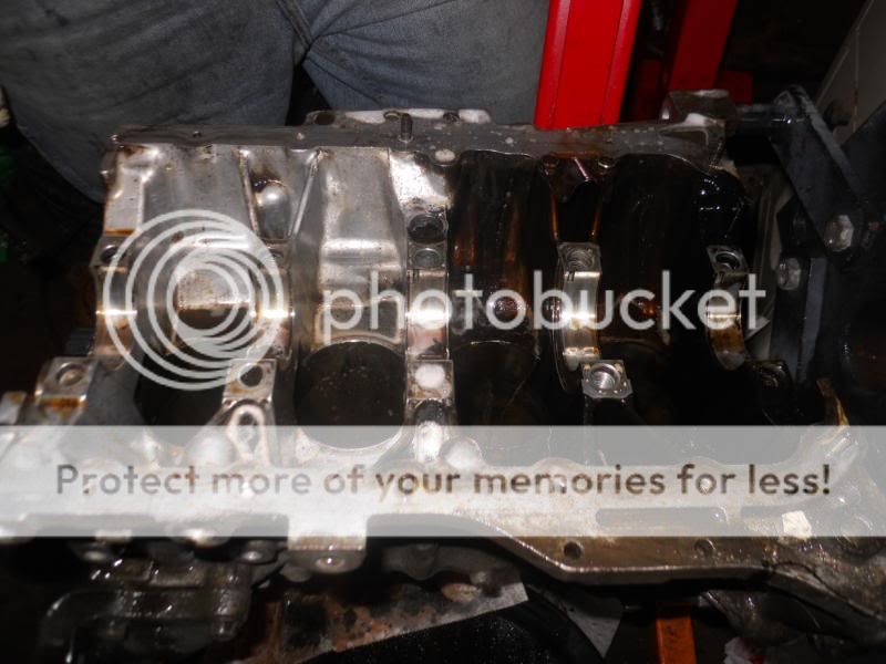

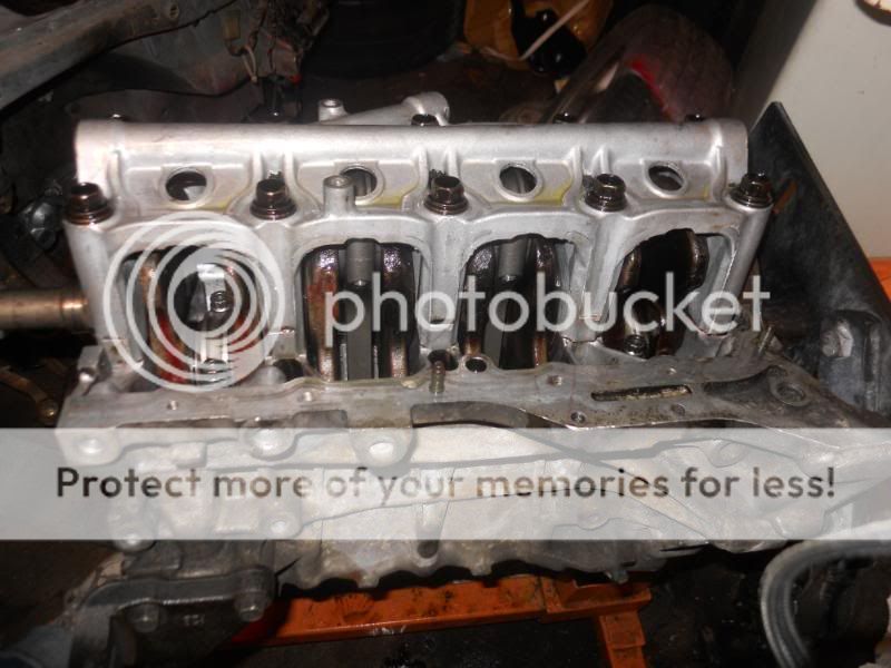

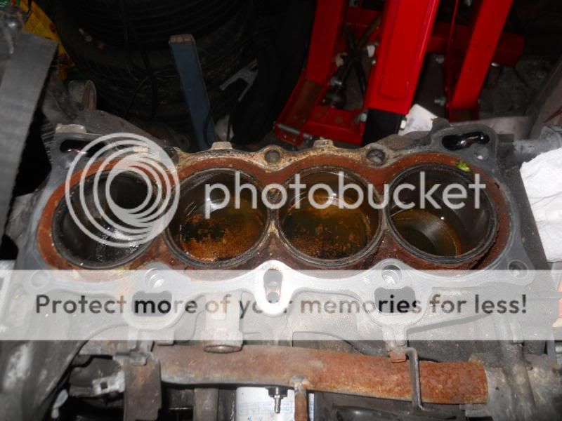

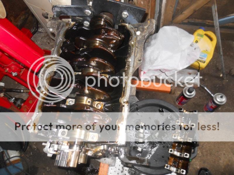

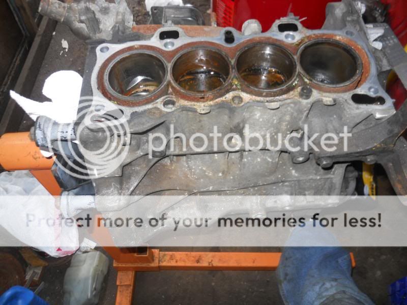

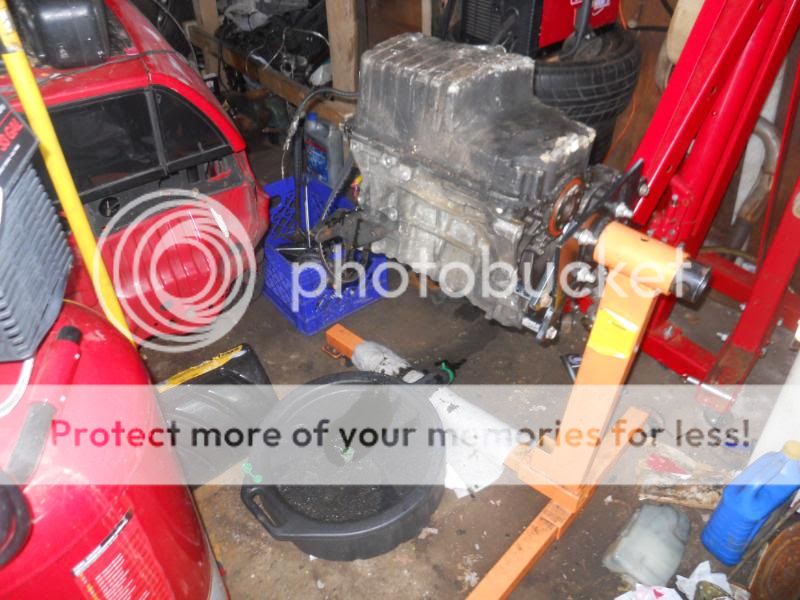

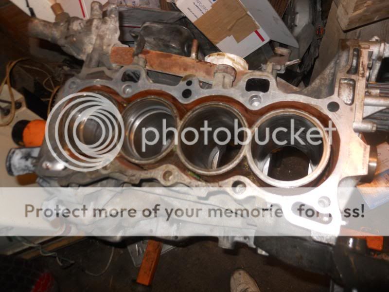

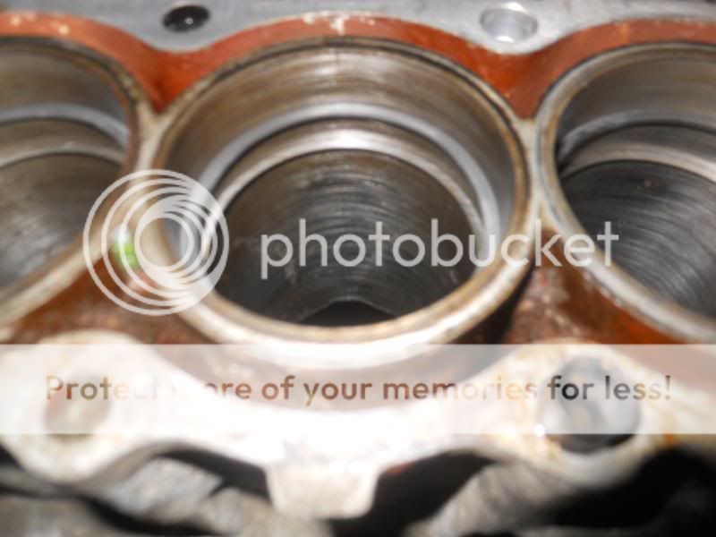

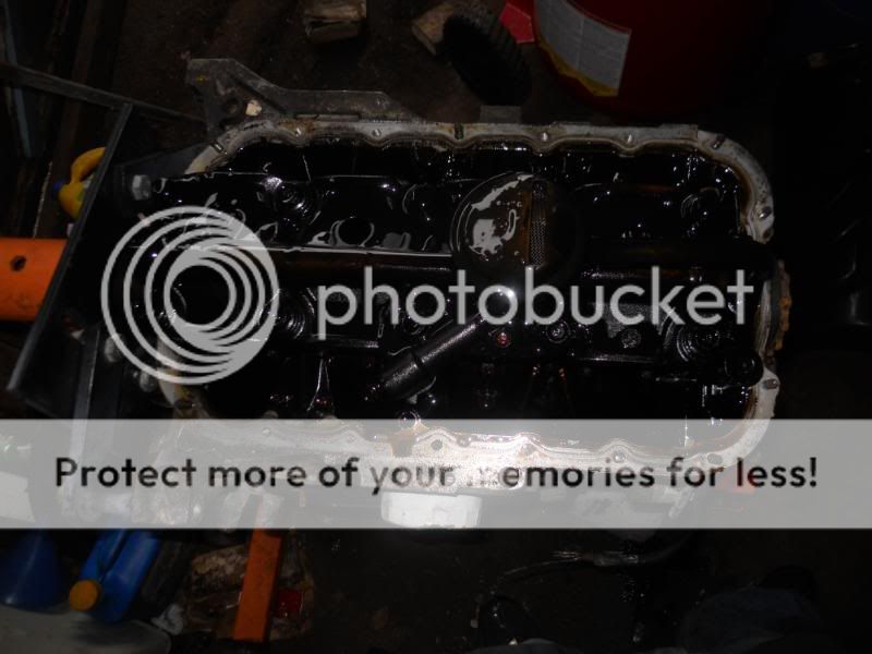

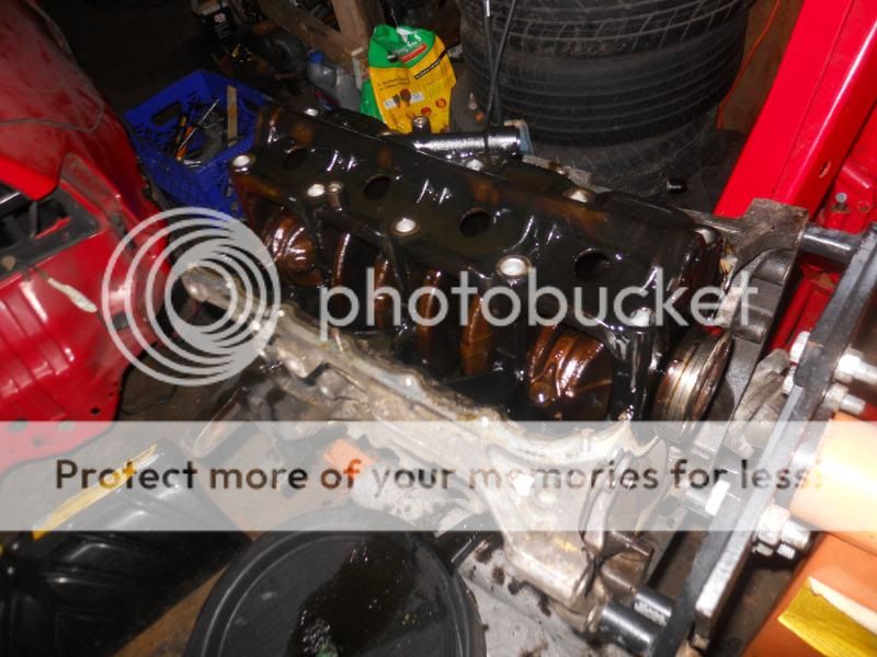

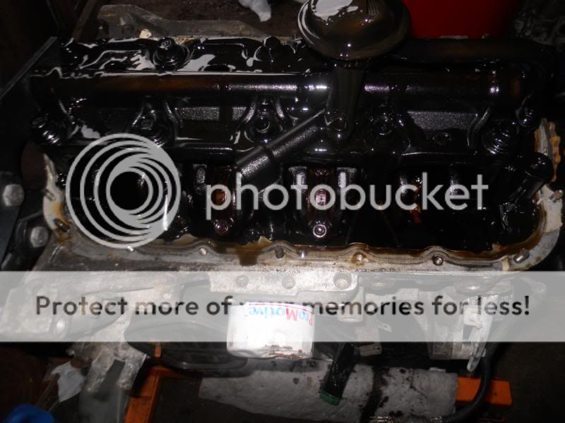

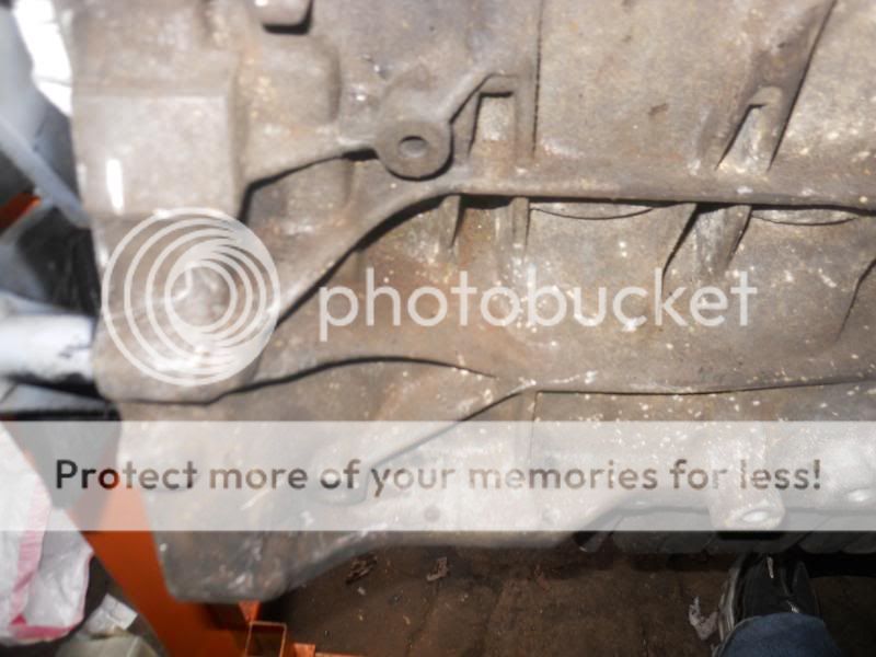

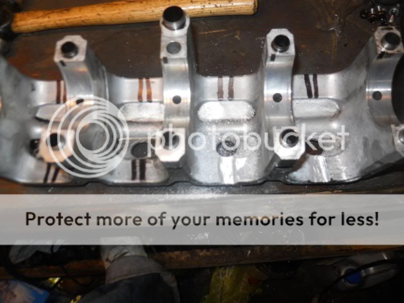

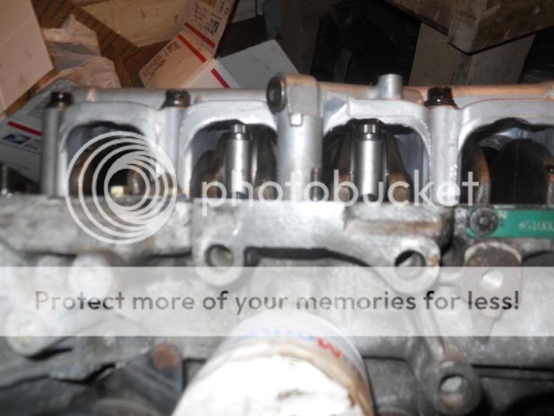

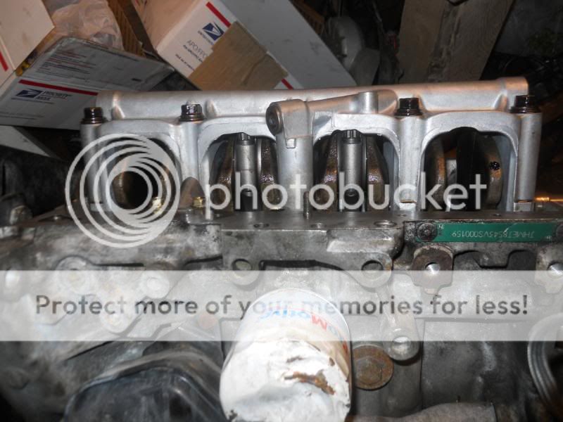

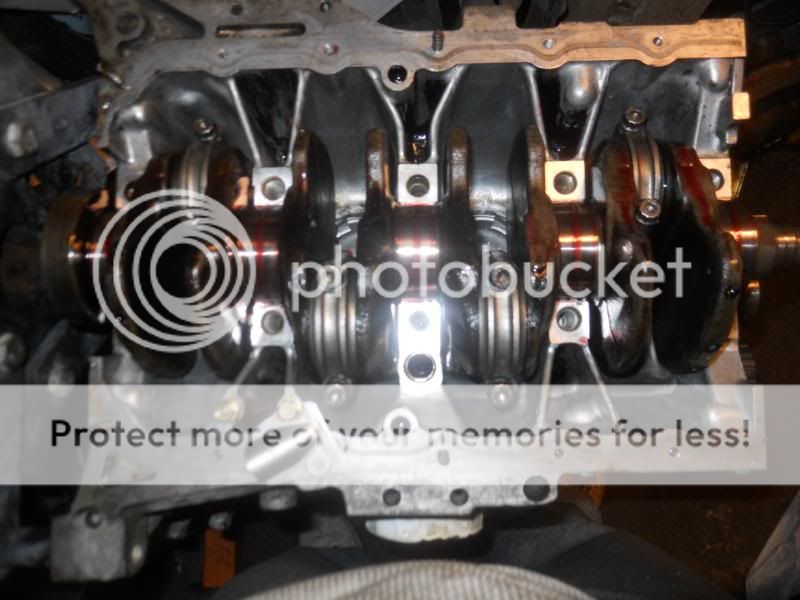

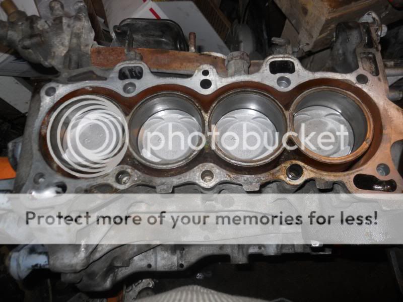

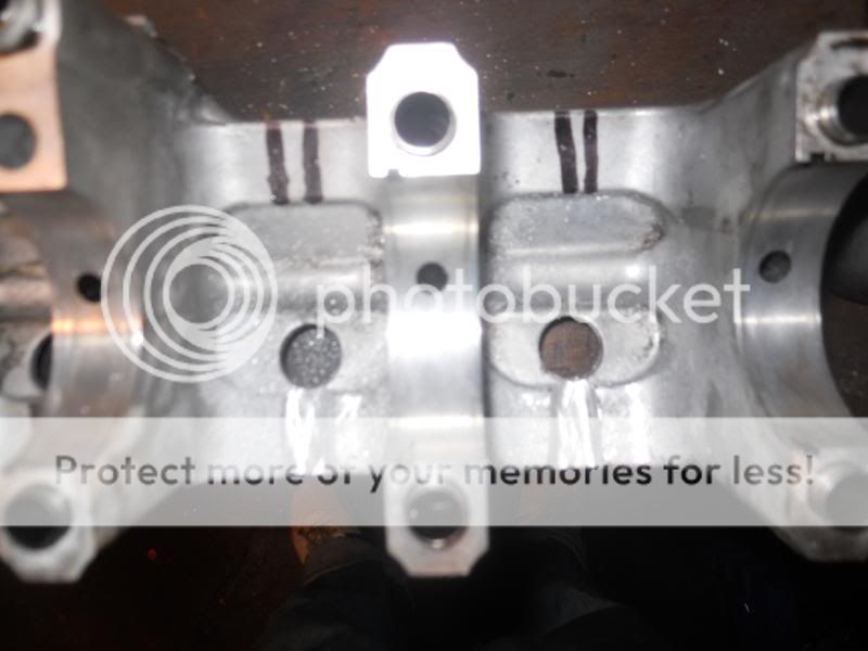

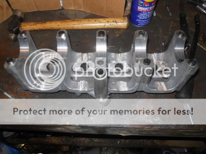

Fun stuff, started pulling apart this motor I had laying around. Its a y8 with untold miles. PIC time.
This is why I think the y motors are stronger in the 500+ range, block casting has no weak link.

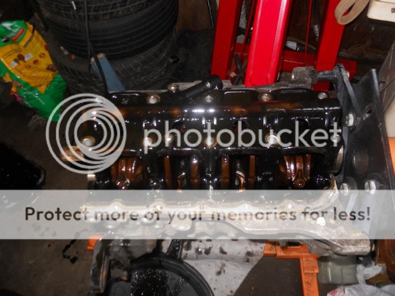

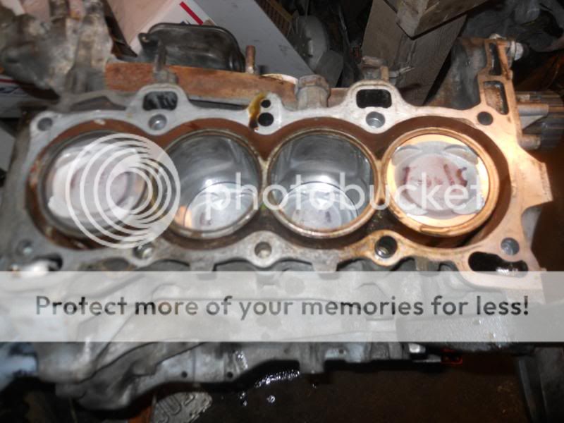

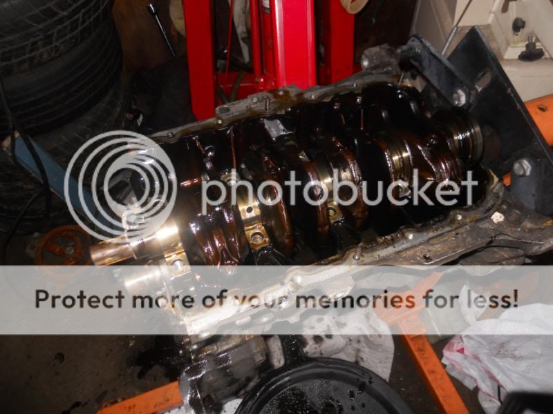

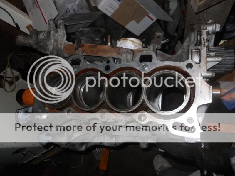

No drain to be filled.

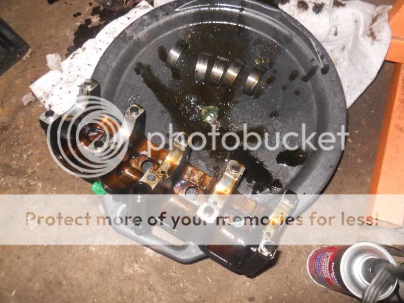

Damn anyone ever heard of a oil change, looks like this person never did.

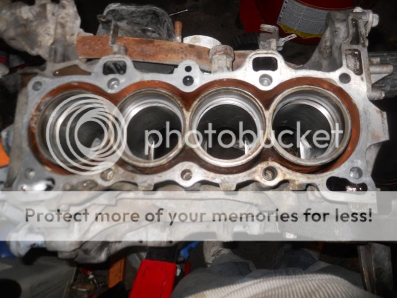

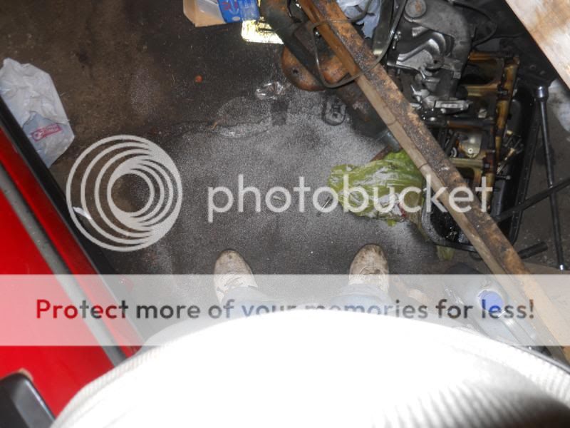

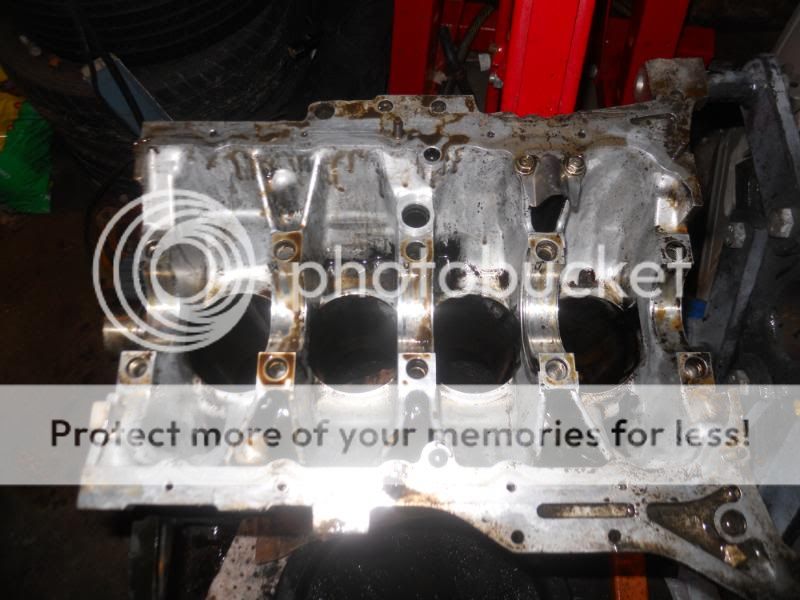

I thought for a second this was cast iron......

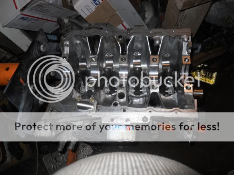

Here you can see before and after.
Oh yea looking better.
At this point I was a few hours in, no heat, my balls where frozen and feet/ hands were num. More to come, oh and I need to put this to use :evil:

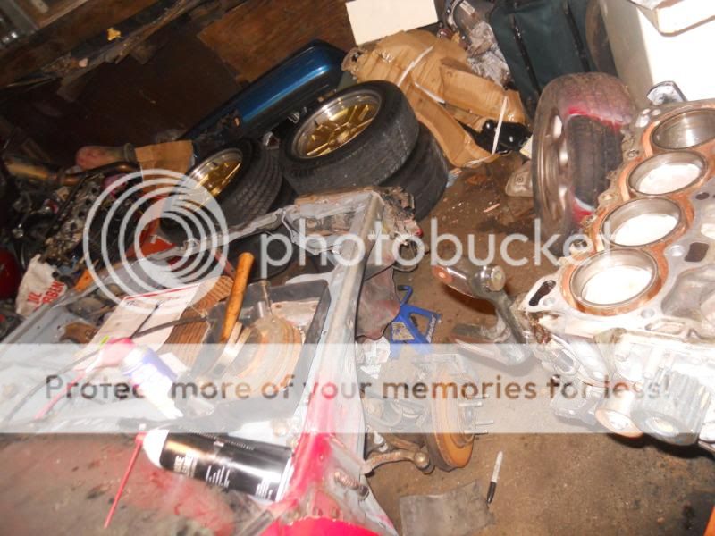

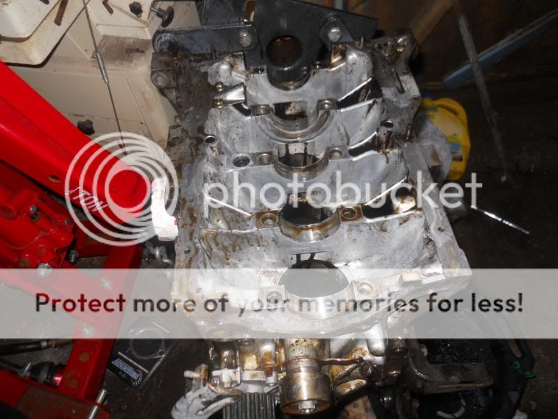

Time for some more pic's!

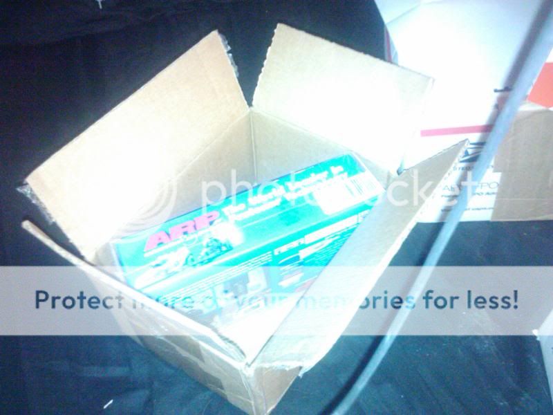

Oh damn what we got here.....?
Hoping to have the motor and trans done this weekend!

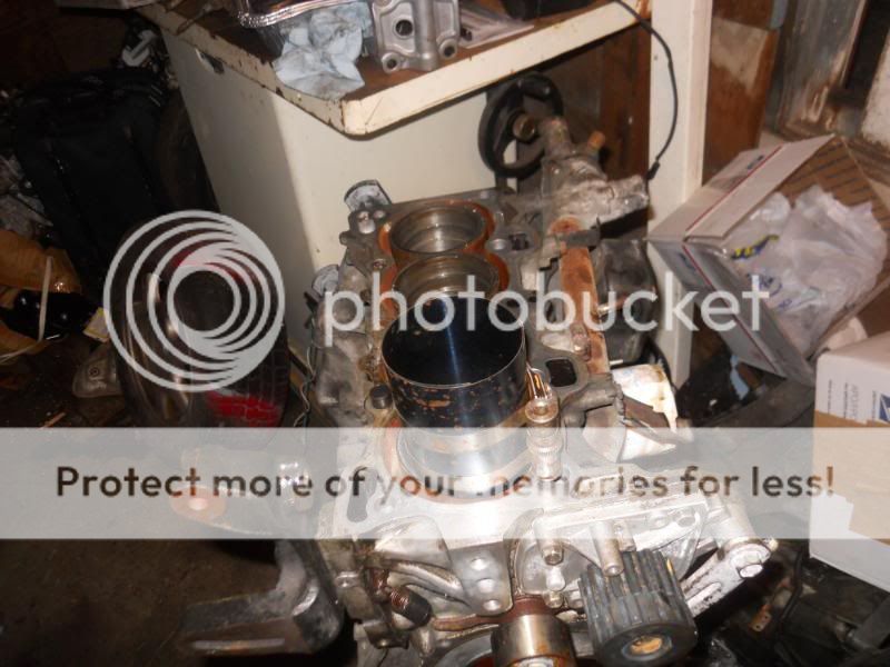

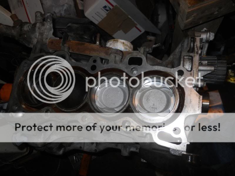

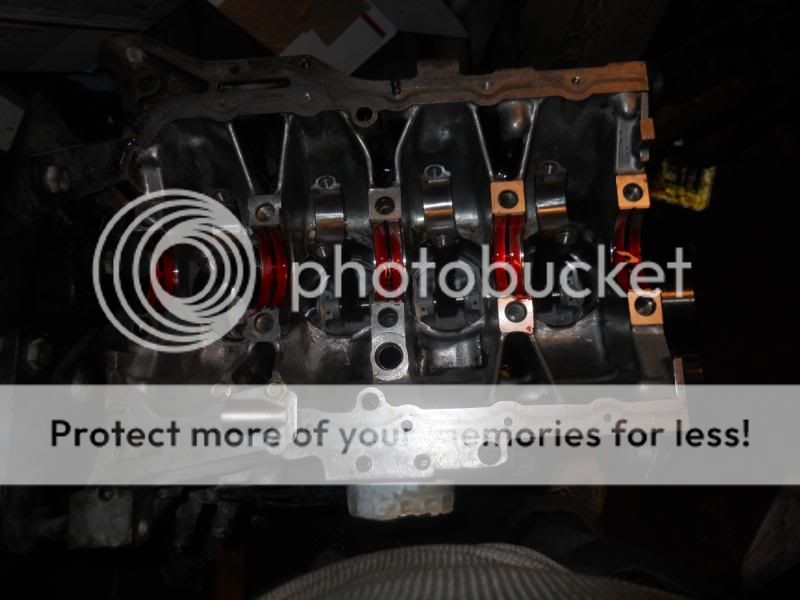

Short block is together need to order a few more things and she going to be ready!

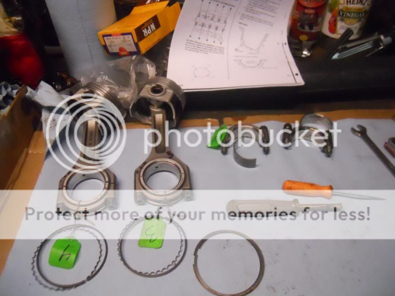

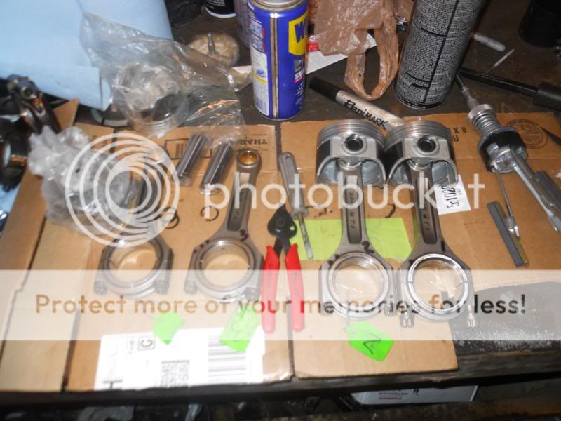

Moving+ bad weather= fail! OR at least not enough time to work on shit like one would like.

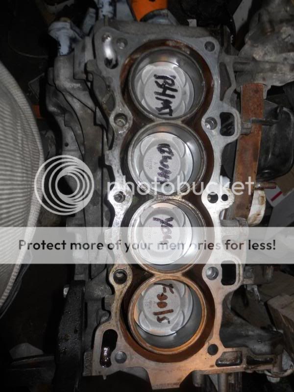

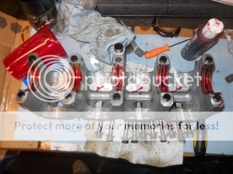

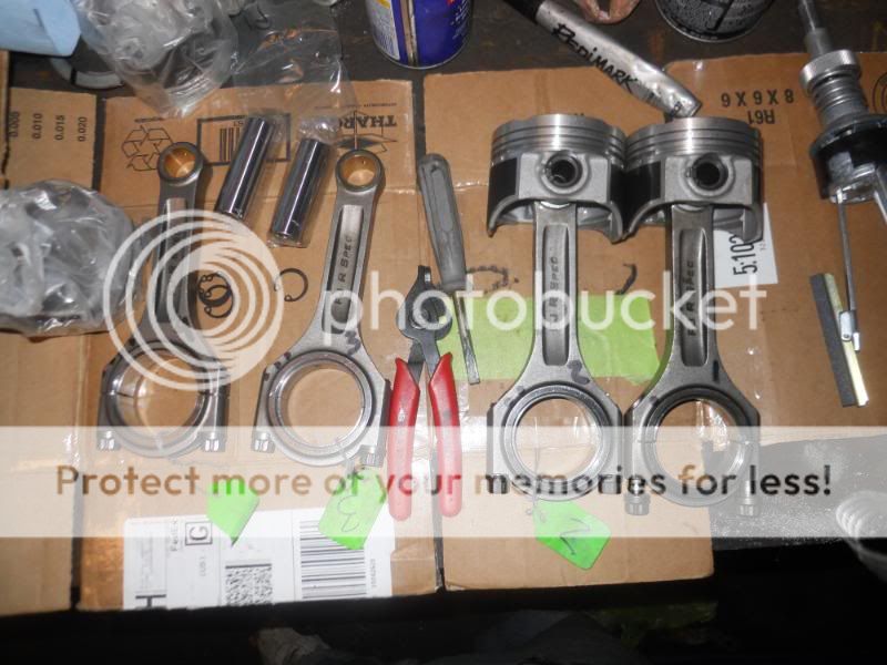

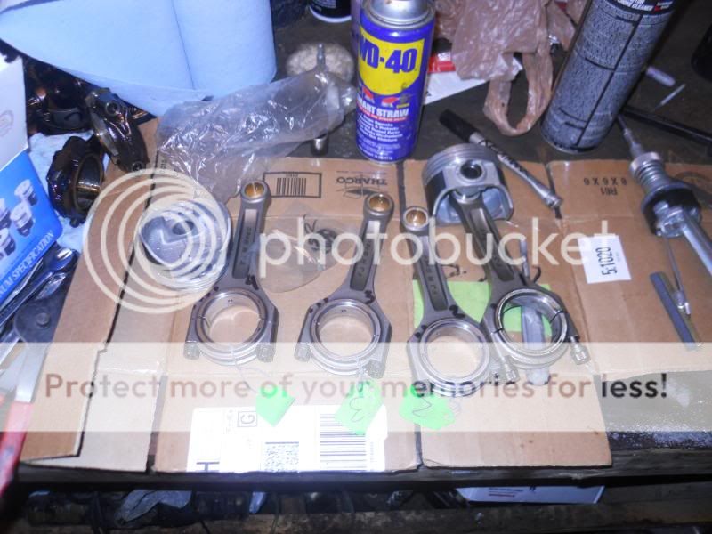

Well fuck it, pic time!

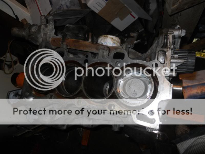

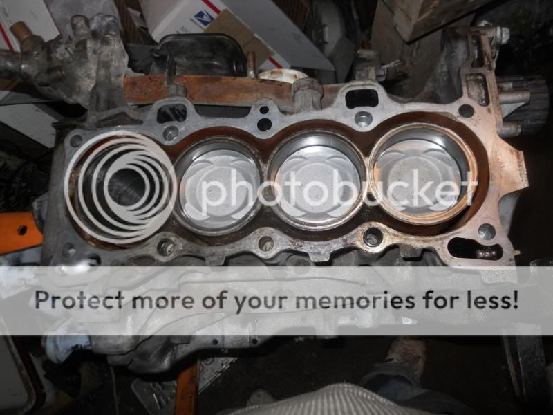

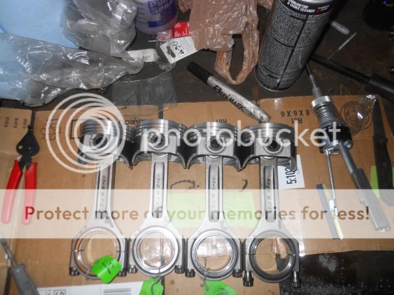

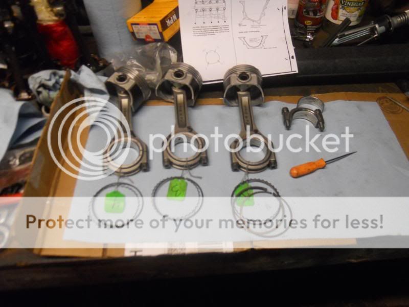

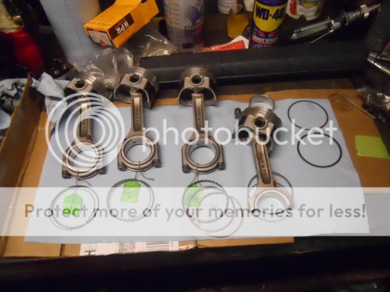

Gapping rings, .018 top and .019 second.

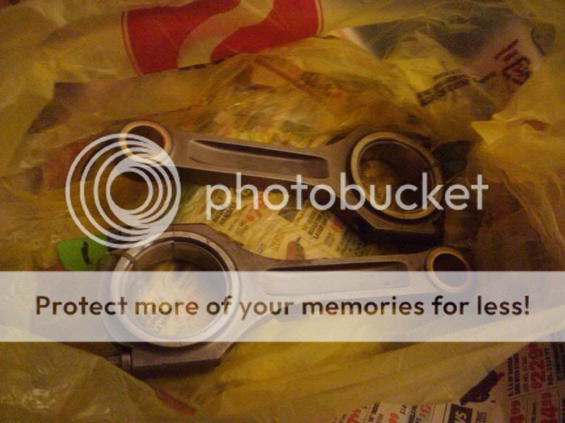

Getting the piston and rods ready.
