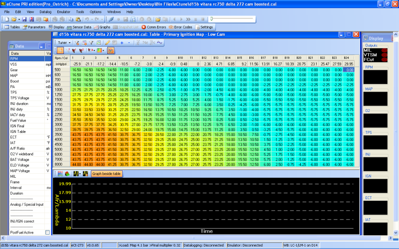

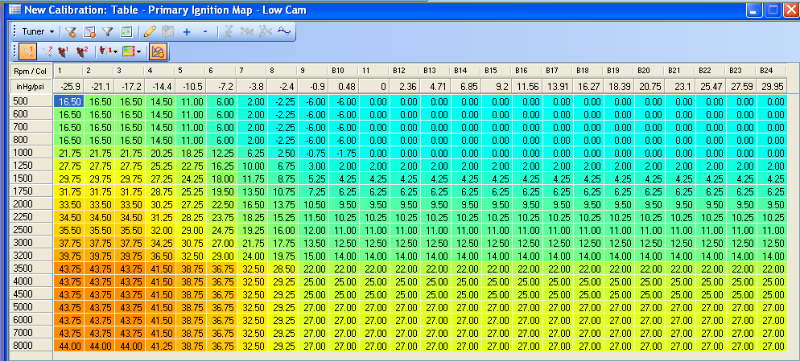

need some advice on how to setup the higher boost timing, right now i just did a step retard like so
0-3 .5
3-5 .75
5-7 1
7-13 1.35
13-22 1.5
the issue im running into is it pulls a TON of timing its al at -6 in the high boost :P
not really sure what acceptable base numbers to start with so any advice would be awesome ill get a screen cap of the map in one minute.
also some target AFR's that most would reccomend like between x and x boost x afr is good know what i mean?
photobucket is down will have pics in a sec

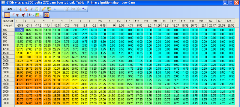

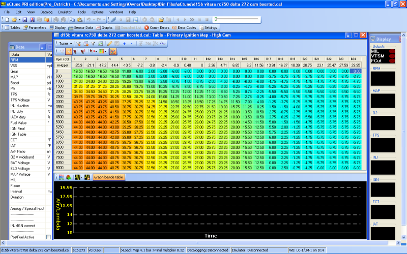

high cam
low cam

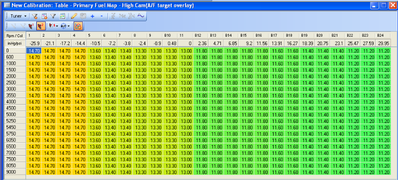

So just 1/psi and set the boost to nog?
What afr's in what ranges? I think I would be happy with 370whp LOL
DmC
  • Posts: 3036
Re: high boost tuning/base map advice
« Reply #7 on: September 05, 2010, 12:04:37 AM »
Just do .75 degrees retard building the base and target 12.5 afr up until 10psi then go to 12 from 10-15psi  from 15-29psi target 11.5
peak torque should be between 5000 and 6000 rpms add about 3degrees timing back  in that area. turn up the boost a few psi at a time and check it out don't just try to tune for high boost right away.
speedjunky01
  • Posts: 1015
« Reply #8 on: September 05, 2010, 12:16:28 AM »
That sounds like way to much timing for a d and not rich enough at all to me
But yeah I'm not just gonna go for 20+psi first pull lmao start wg spring and work it up
From reading jd's posts the d doesn't like a ton of timing and he starts by pulling as much as 1.5/psi but that ends up being way to much up top, on my z6 tune at 13psi 1.3/psi and 11.8:1 workedwell on 13psi but that is pretty conservative
I think I'll do 1.35 up to 12psi then above that pull 1/psi and target 11.8 up to 12psi and 114 above that tapering slow not justo e column dump to 11.4 lol

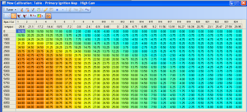

« Reply #10 on: September 05, 2010, 02:59:03 PM »
any better?
« Reply #11 on: September 05, 2010, 03:58:11 PM »
generally you want to ramp up timing as rpm increase to hold the tq flat.
start with mild timing and add timing slowly until it stops making more power or until u hear it knock.
its pretty straight forward.
11.5-12:0 is a good place to aim for AFR
ifly87
  • Posts: 294
« Reply #12 on: September 05, 2010, 04:11:09 PM »
Yeah, I shoot for 11.5 afr's across the board, maybe 12:1 under 5-7psi

Good info here think I'll just street tune the afr's to where I want and use some Det cans to get timing down
This is gonna be a loooot of pulls haha 2psi increments a good way to get it dialed in? I want it to street drive down low well too not just be a strong wot/high rpm tune

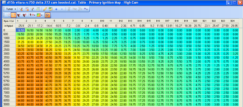

spent some time looking at other peoples maps and i think this should be a good base
this with dropping about 1 CR point it should be pretty good, may need more timing to make some power but nothing a set of det-cans and some street pulls in 2psi increments cant fix  :noel:

yeah I plan on adding until i hear a spot of det then backing it off 2* or so, the dyno will say if this is a good plan or not
thats pretty crazy though adding that much timing and no difference, i would just stick with whats lower if it makes no difference in the power

Thats why I was saying go with .75 retard in the base just turn up the boost in steps and keep the map looking logical as you work up to your high boost level.  tune vac on the street Ive founf the dyno to be better for tuning fuel in boost it's to short to log very well street tuning. don't get me wrong ive tuned a few boost monsters on the highway but now that I have dyno access it's just easier and gets a way better result.
