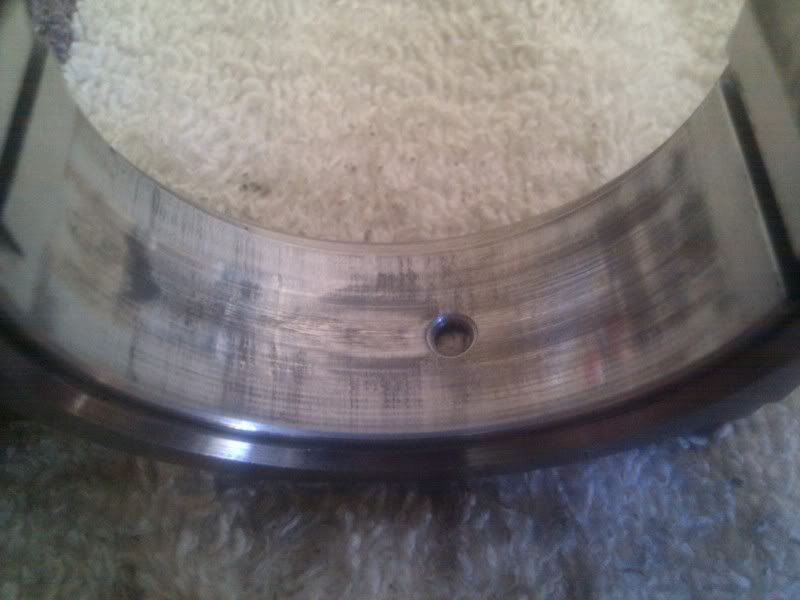

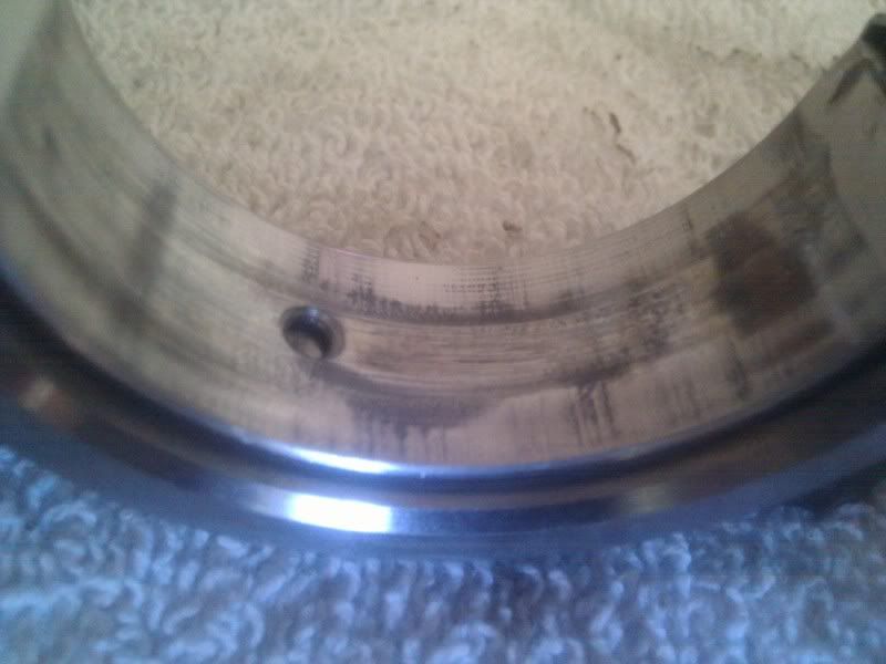

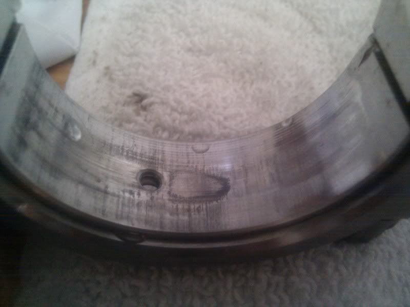

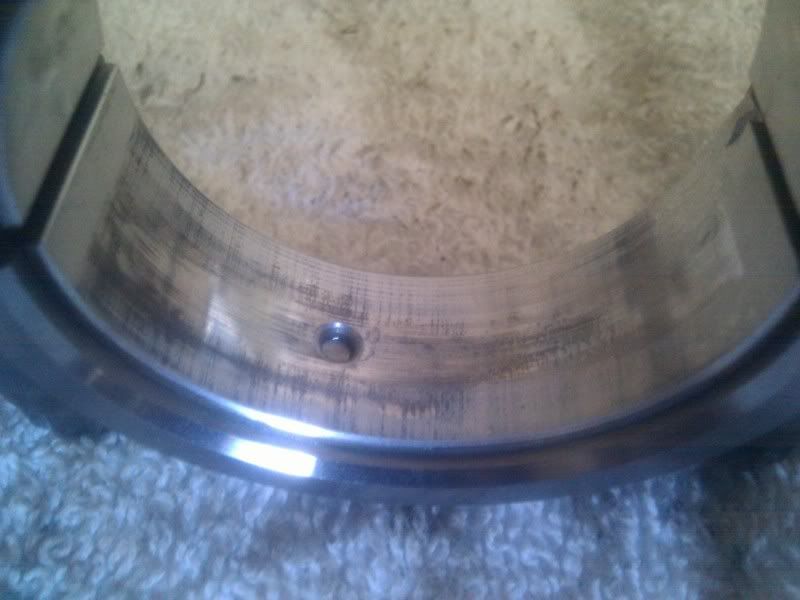

On a budget, have new ones ordered but they won't be here untill tomorrow.  The surface is smooth and there are no imperfections that can be felt by finger or by running my finger nail across the surface.
So what do you guys think, are these reusable?

I'd reuse it, but I'm a cheapskate
Re: Resuable rod bearings?
« Reply #3 on: September 09, 2010, 03:26:40 PM »
Meh, bearings are relatively easy to get to, so I wouldn't hesitate to reuse them.  I only replaced my last ones because there was copper showing through, coolant ate them up.
« Reply #4 on: September 09, 2010, 03:28:30 PM »
I'd run em.  In fact.. I've got 2 used sets from my last rebuild I'm keeping around just in case and they look worse than those.

I would reuse them IF they plastigauged in spec!
« Reply #8 on: September 09, 2010, 04:19:41 PM »
They look fine
« Reply #9 on: September 09, 2010, 04:20:20 PM »
those look like new compared to the ones I reused in my miata....

they look better in real life i think, and the crush isn't even all worn off yet, so thanks for the input guys, i can get my ass back in gear and continue putting this back together.

Bearings aren't supposed to have any markings. If any, they are very very light and barely noticable. That pic shows a groove.
Replace that shit or play with fire.
+1
If using the same crank, and the crank was polished correct, GO! ZDDP helps prevent scuffing at start-up, which will happen to any bearing surface in a motor.
