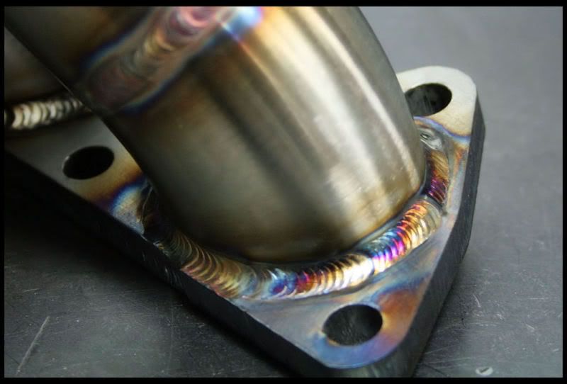

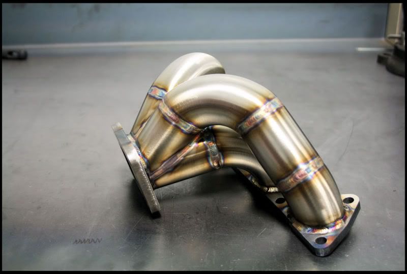

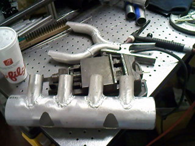

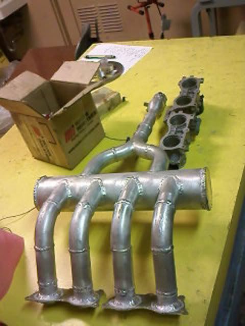

Well i figure i better contribute to the site.
Here is a D series mini-ram i put together for a guy not to long ago.
i never got any pics after the wastegate tube was welded on, but oh well.
i have been working on my flange welds as i have had some trouble with keeping them uniform around the whole pipe.
LMK what ya think

wow nice  :o
what steel did u use for make it?
Malichite, how's going the log mani?
Re: d series mini-ram
« Reply #3 on: April 10, 2009, 09:37:25 AM »
i use 304 sch 10 pipe fittings

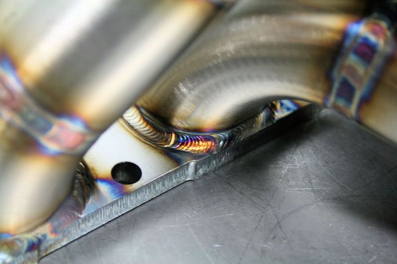

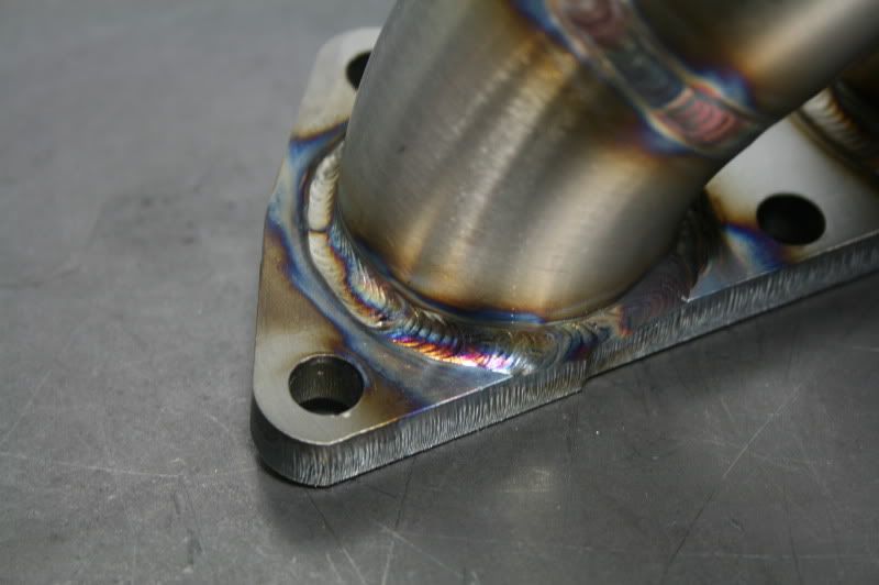

« Reply #6 on: April 12, 2009, 12:29:08 AM »

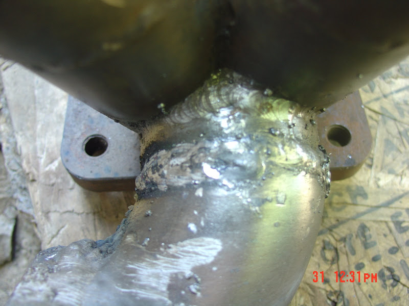

1) absolutely horrible gas coverage
2) you somehow managed to burn some the stainless up at a piss ant 30-40amps worth of welding current - because you travel SO FUCKING SLOWLY trying to make "pretty welds".
Get your head down in the god damned part where you can see, use proper gas coverage, currents and travel speeds.
« Reply #7 on: April 12, 2009, 02:50:06 AM »
I work the torch to get the color in the welds that is "perfered" by my customers. is there something you see wrong in my welds?
I had my welder set at 80 amps on all pipe welds and collector welds and was pretty close to flooring it. also on the flange welds i set it up to 130 amps and am very close to full on. and i can assure you i do not travle slow at all.
btw toys i am turbob16hatch off ohmt.
anyways lmk on the color side of things, and for the most part the weld tie in on the flanges and the consistency on the pipe welds.

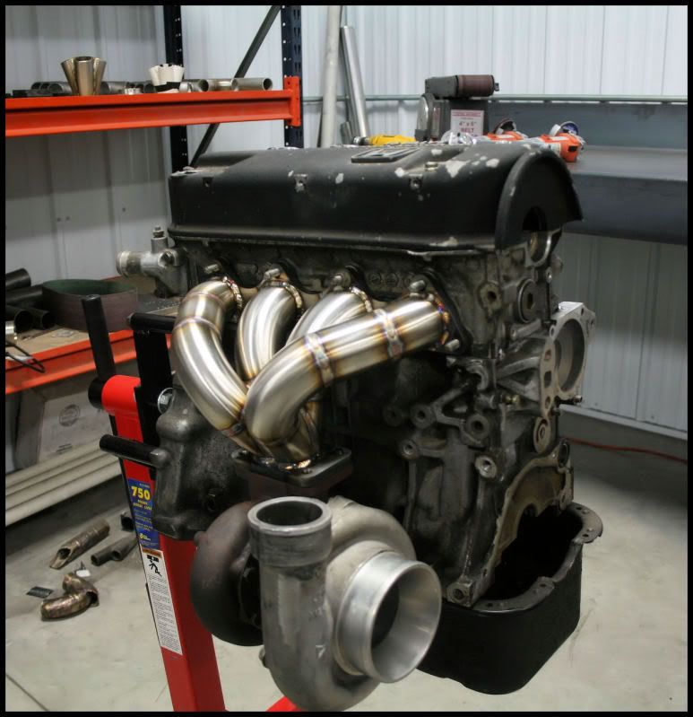

« Reply #28 on: August 09, 2009, 09:51:28 PM »
nice welds.  the only thing I don't like about that manifold is the angle the collector meets teh flange
« Reply #29 on: August 09, 2009, 11:09:09 PM »
i hear ya, i don't think it will effect performance any, but i can see how it could look off a bit.
