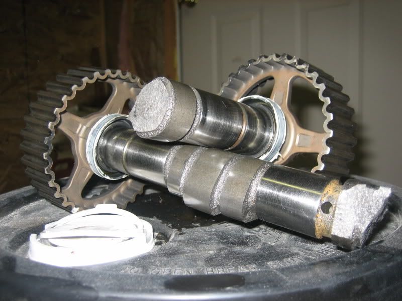

talked to dave crower today, asked me to mail him the cams and he said hell see what he can do for me.  Mentions that my valves were screwed and he said he might replace the cams and possibly the valvetrain
Soo if he will replace the cams, should i put them to use or should i sell them and get oem's

You want true reliabilty get itr/ctr oem cams

man looks like i wasnt the only one

Good bye nice high comprecion valves.
WTF?
See how they aren't dished like oem valves?

Perhaps a bad set of cores they know about hence why crower is being very cool about this. I know the first couple batches of crower,skunk cams back in the day all either went flat or did what happened to both you and hotrex.
For the dohc vtec motor crowd from b/h/k there all is OEM upgrades so IMO unless your doing an all motor build even then I love ctr cams in B motors no need to run aftermarket camshafts.

If Crower sends you a new set of cams in exchange, sell them on HT and get a set of CTRs :yes:

Crower VTEC cams have always been prone to breaking, they mostly fixed the problem 5+ years ago to the point where Skunk2 Pro's were a less reliable cam.  Recently they released a bunch of blems - either old cams they sat on for years, or another batch of crapola - and there are a lot of cams breaking.  For SOHC or LS, their stuff is quality.
Brian Crower cams are, honestly, not the biggest on the market.  They are very much marketed at the streetcar crowd, and as such they are a good value.  Josh's LS is the first set of Brian Crower's I have seen or heard of breaking... the fact that Josh was involved leads me to believe it was installer error, or he got a "sweet deal" on the head/motor which had different caps swapped onto it at some point.
Everyone recommending GSR/ITR for a turbo vehicle is correct.

Well i finally shipped my crower cams in to maybe get a refund or another set of cams
Talked to louis from crower today, They got my cams and they wanted to inspect them tomorrow and that i need to call them back tomorrow.  I sent some of the valves along with the cams. Hopefully something comes from this  :-\
Also, i mentioned that I wasnt the first person for this to happen to and they tried to deny it and say that its very rare   ::) . Then continued to ask me where i read it at and so on.  Fuckers

Maybe as jd pointed out they sold out some old inventory. This was a problem when vtec billet camshafts first came out but that was a long time ago. Either way atleast they are working with you. Hopefully it was a small batch so this doesnt happen to anyone else.

Crower called me today and said they want 125$ each for new cams. figured it was a good deal and they are sending me some new cams
new piston rings, new cams and then im off to see leed   :yes:

So when was the last time hands on people have seen crower cams fail? Obviously we have 2 cases here on the board.

I think its just random numbers, well thats what google tells me. 90% of the people that this happen to may not be on forums
