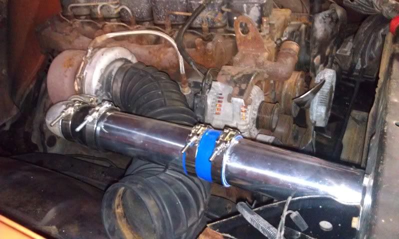

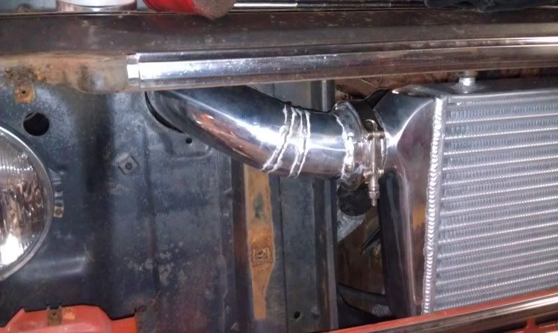

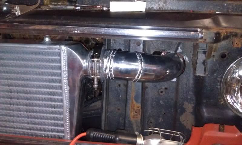

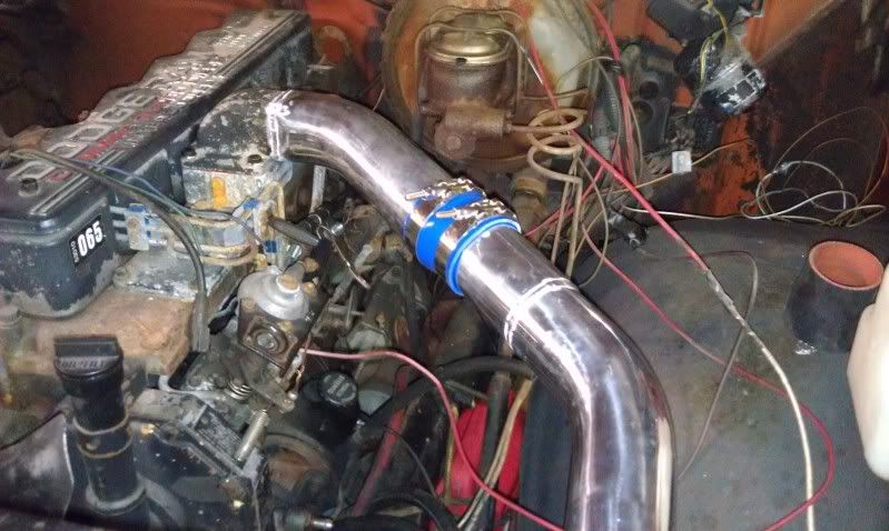

95 12 valve that im puttin in a 75 chevy 4 door long bed. Truck has like 8" of lift and 38's. Its a monster!!
I'll get some more pics of the truck itself and the rest of the fab work tomorrow. My phone died on me tonight.
Intercooler piping done. Who said ebay intercoolers were just for econoshitboxes.

Cool to see a 12v conversion. Just one thing i thought i would mention is that the couplers in the charge piping seem to be a bit short/stiff. You might want to think about using diesel style couplers that are quite a bit more flexible and longer.

You might want to re think your charge pipe by the intake manifold. When the engine starts moving around and you have a long part solidly welded like that it will lever on that weld and probably break it off at the manifold. Other then that looks sweet.
That's the only way I could get a bend on it and keep the grid heater because of its proximity to the master cylinder.
I threw another coupler in that section. Right before the bend by the core support. It allows for alot more flex.
One of the 12 valves at the shop just got a 45* bend out of the cast housing with a bubble coupler. It's been on for 10 months...
